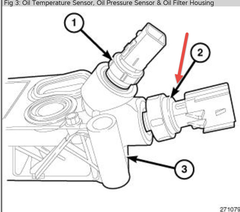

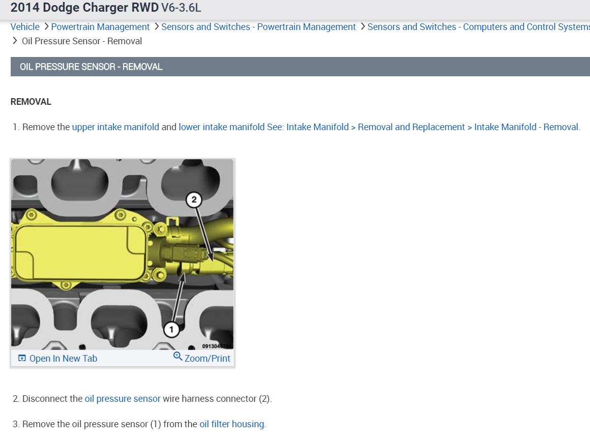

where is the location of the oil pressure sensor for this car?
Apr 14, 2016 at 3:25 PM
HMAC300
  • 48,601 POSTS

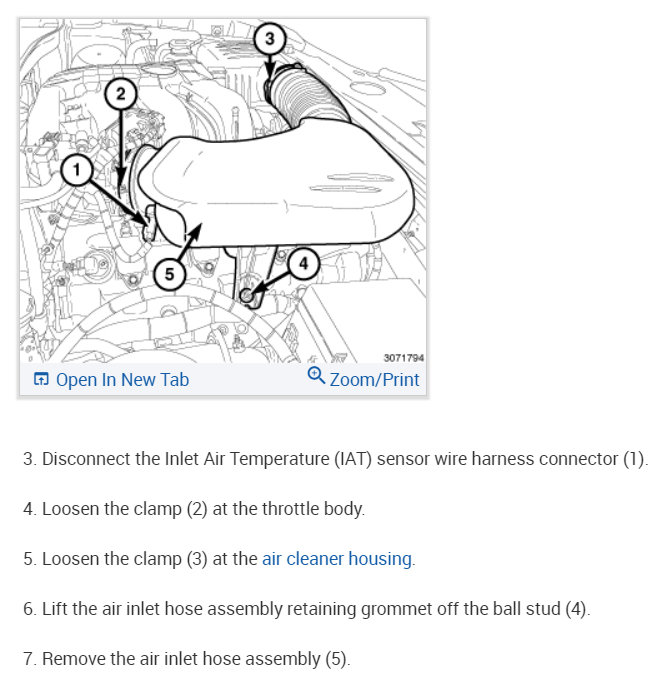

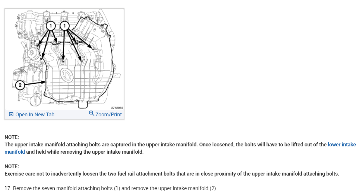

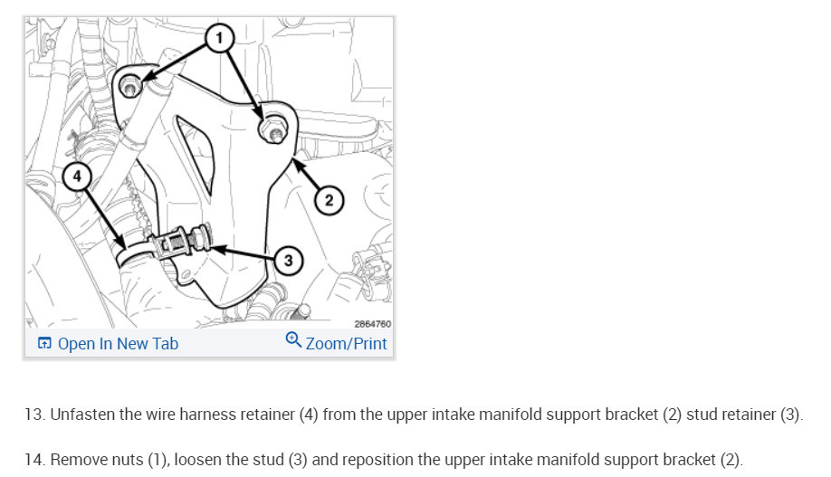

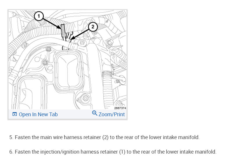

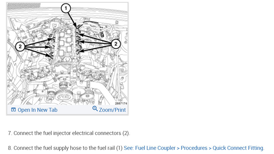

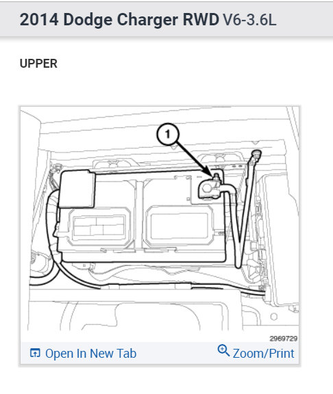

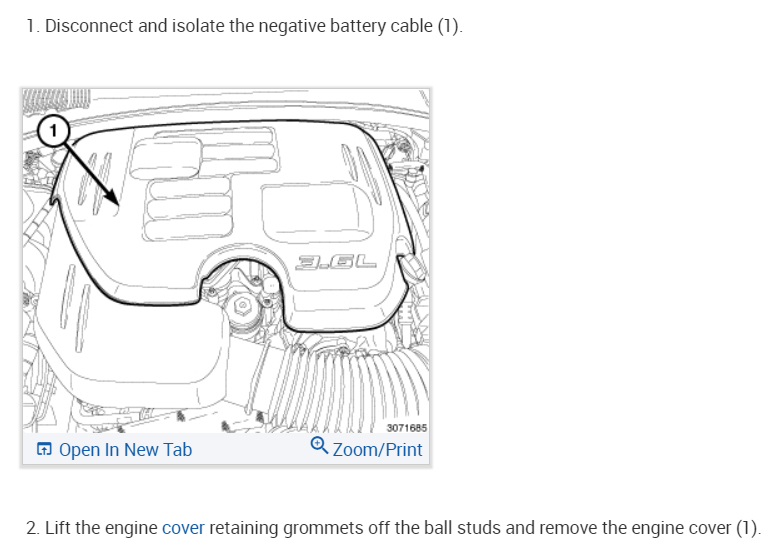

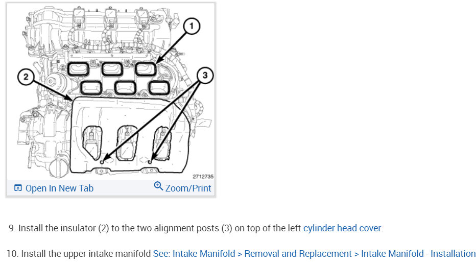

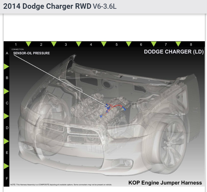

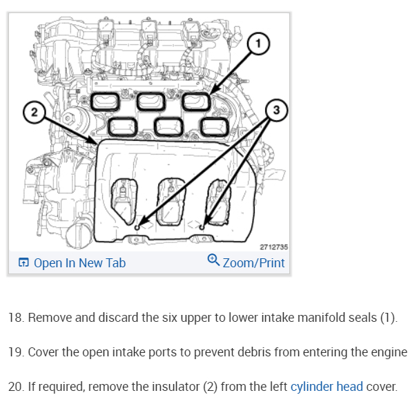

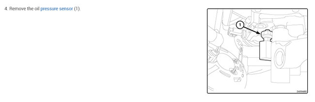

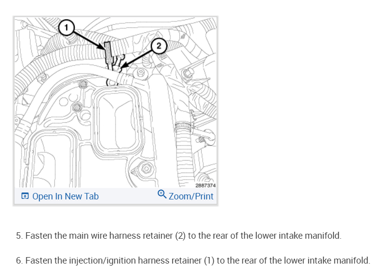

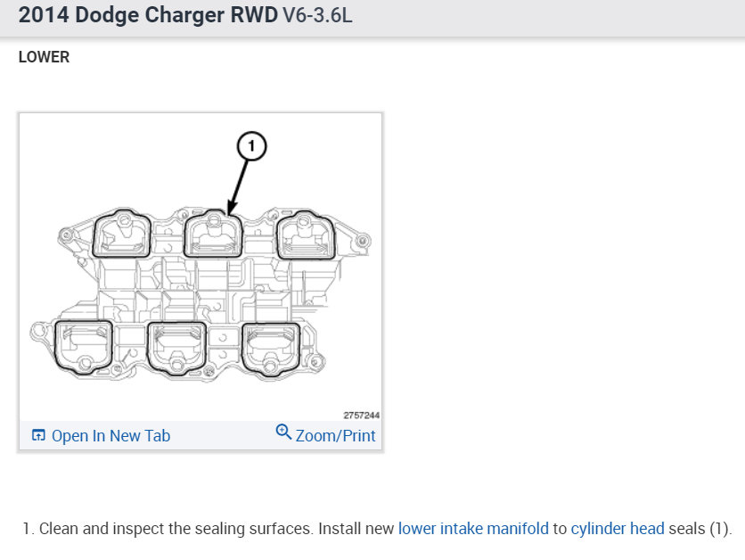

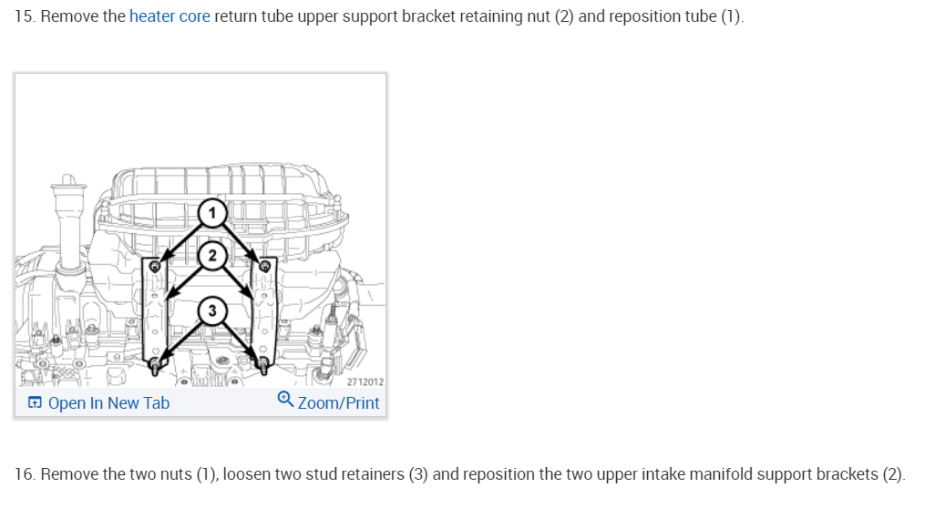

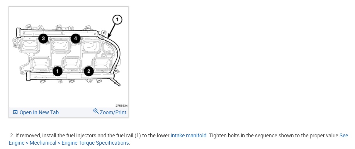

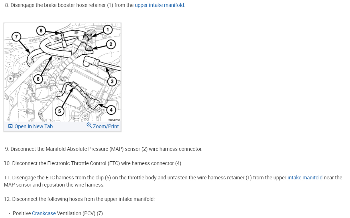

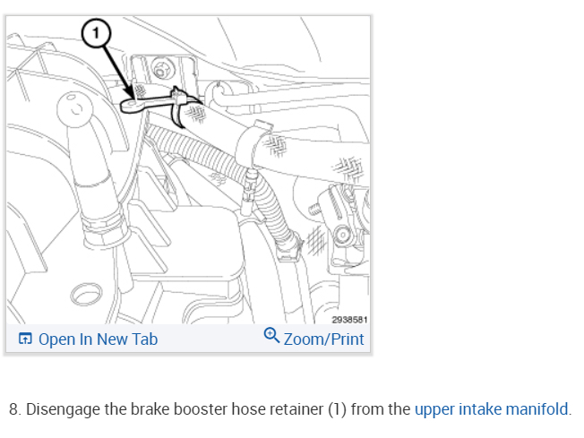

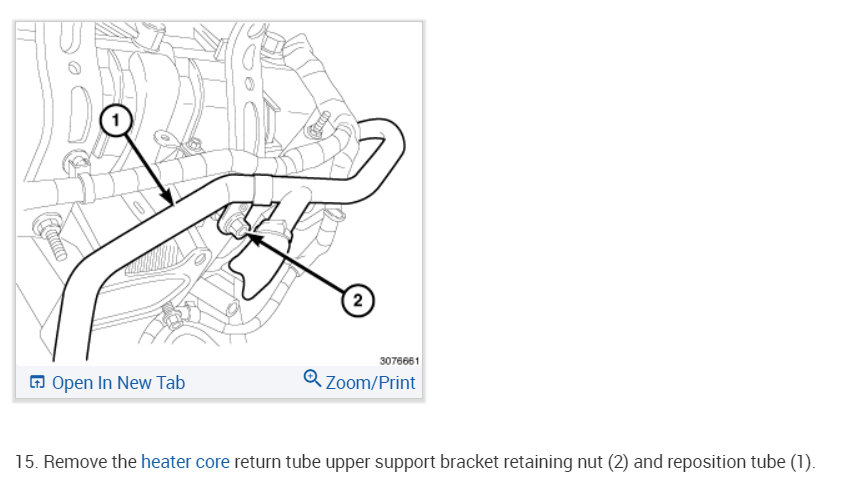

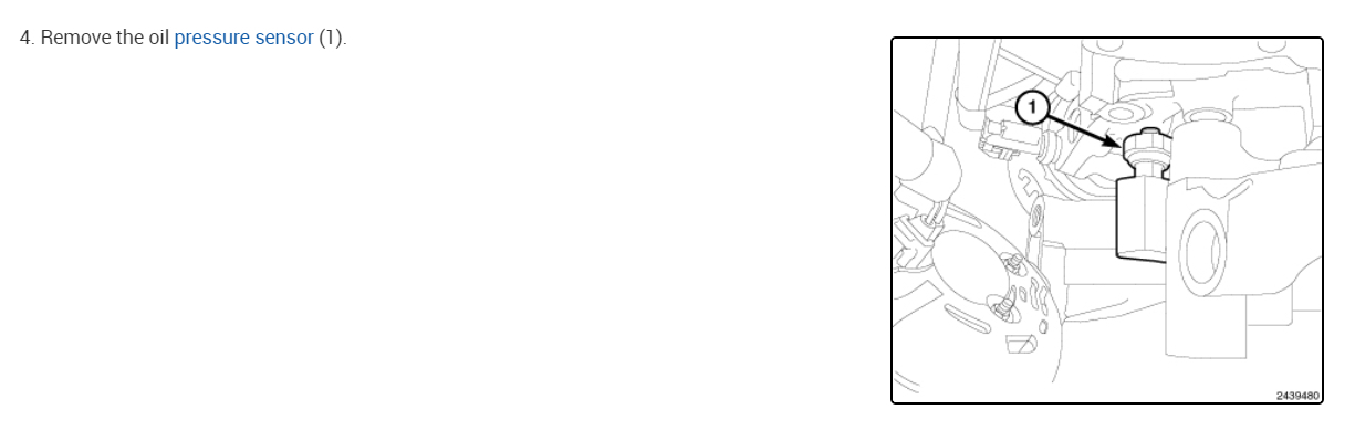

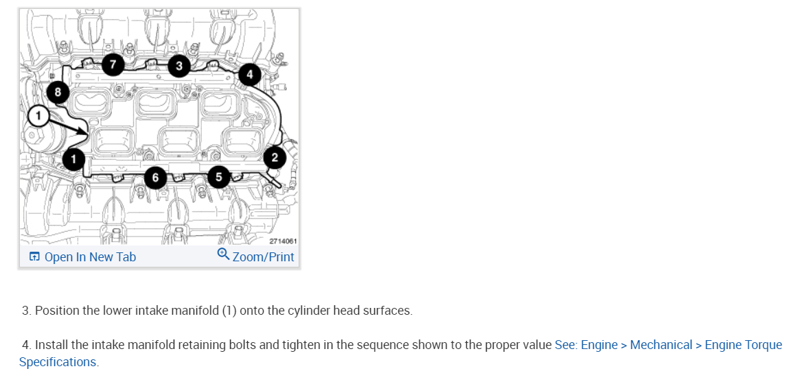

The oil pressure sensor is under the intake manifold here are diagrams below to show you the location and how to remove the intake manifold so you can get to it. Start by disconnecting the battery.
Check out the diagrams (Below). Please let us know if you need anything else to get the problem fixed. Cheers,

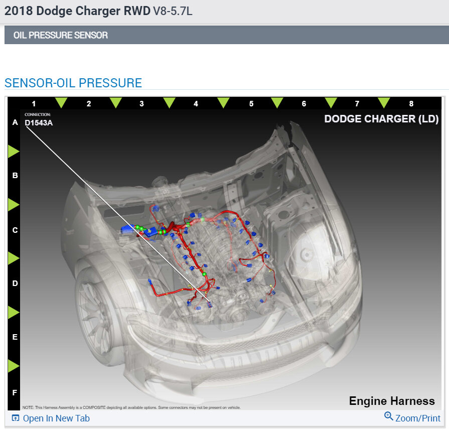

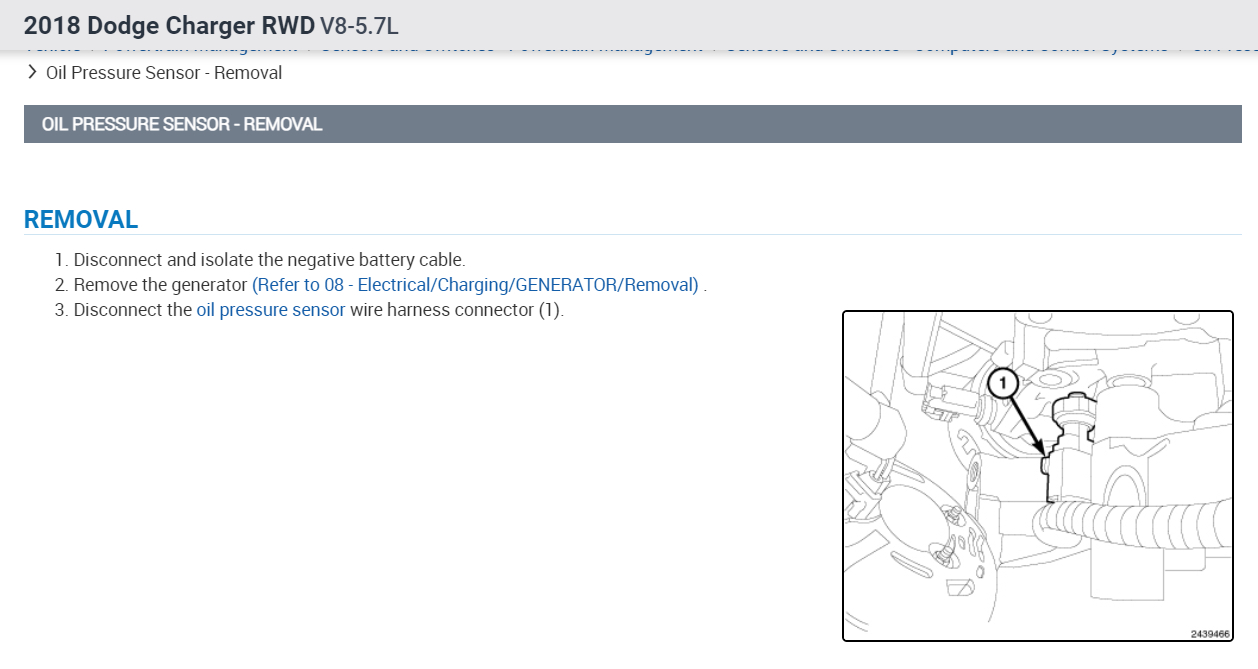

Does anyone know if it’s in the same Location for a 2018 sxt charger ?
Oct 7, 2023 at 1:34 PM
Sure, what size engine do you have? Here is the location for a 5.7 liter. Check out the images (below). Please let us know if you need anything else to get the problem fixed.
