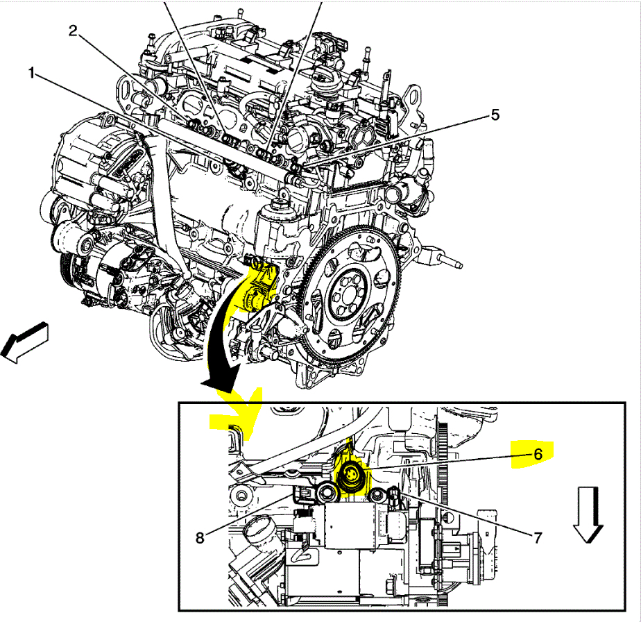

When you open the hood, where the engine and transmission meet, you will see the starter motor. The oil pressure sensor is located right above the starter motor.
Be careful when working near the starter motor because it has power at all times direct from the battery. Avoid shorting the terminals at the starter.
All you have to do is disconnect the sensor and it screws out of the engine block. I will tell you that some of these require a special deep socket. Before leaving the parts store, check the new sensor to determine if you can use a traditional deep socket or if it requires an oil sensor socket.
I attached a pic showing the sensor. Let me know if you find it or if you have other questions.
See pic below.
