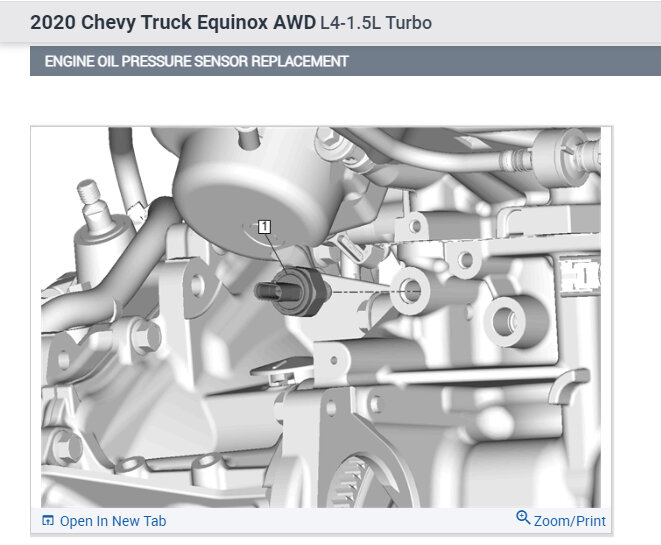

Where is the oil pressure sensor location needed.
Aug 19, 2023 at 6:35 PM

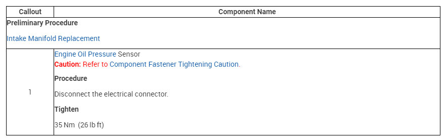

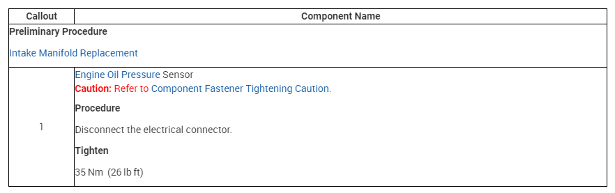

The oil pressure sensor is located at the rear of the engine block above the starter motor. I attached the directions (including a pic) specific to this vehicle for the removal and replacement of the sensor.
Let me know if this helps.
joe
See pics below.
