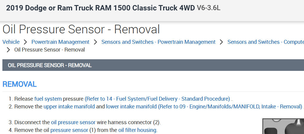

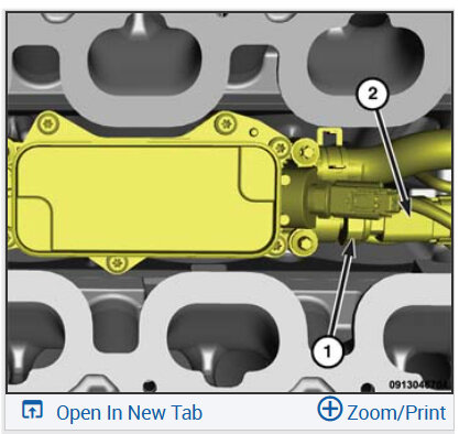

The oil pressure sensor is under the intake manifold, I would replace the oil cooler as well because the OEM unit is made of plastic, the after-market units are made of metal. Check out the images (below). Let us know if you need anything else.
