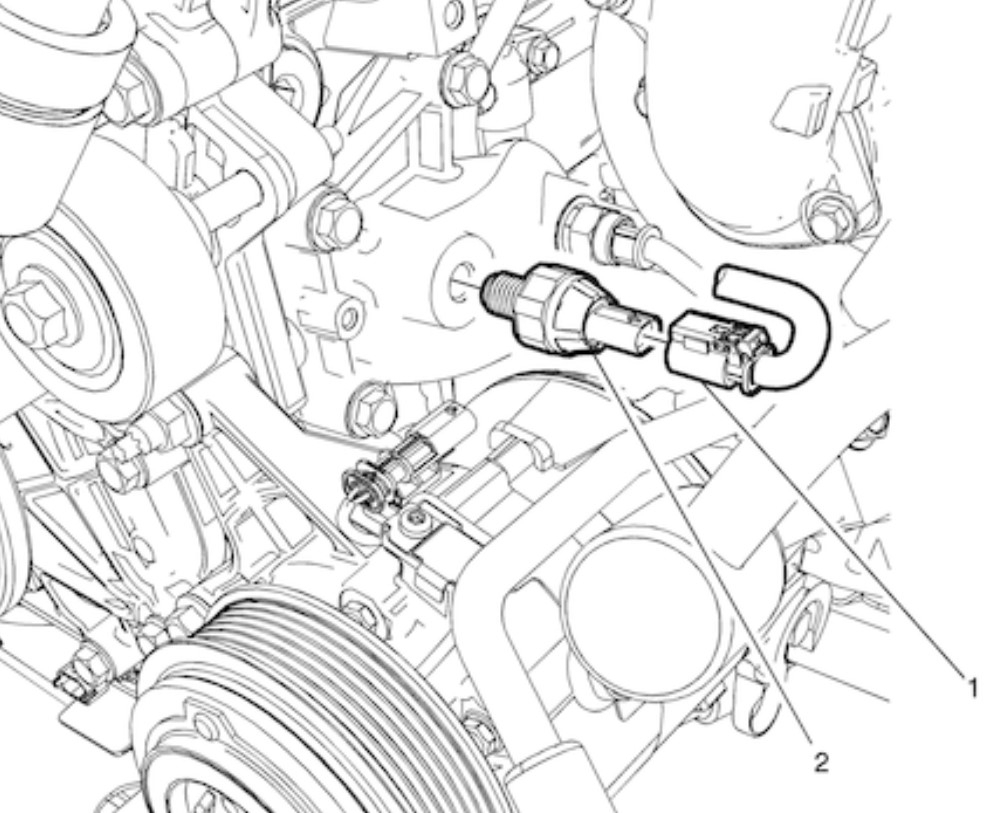

Can you please show me where my oil pressure sensor is on my vehicle listed above with the 3.6 l engine? I can't find it can you send me a diagram please and thank you?

The sender is screwed into the side of the engine block just above the AC compressor. It can be hard to see because of the clutter around it. If you are changing it, be very careful when you screw the replacement in, those are a tapered thread, and it is very easy to tighten them and split the housing it screws into.
