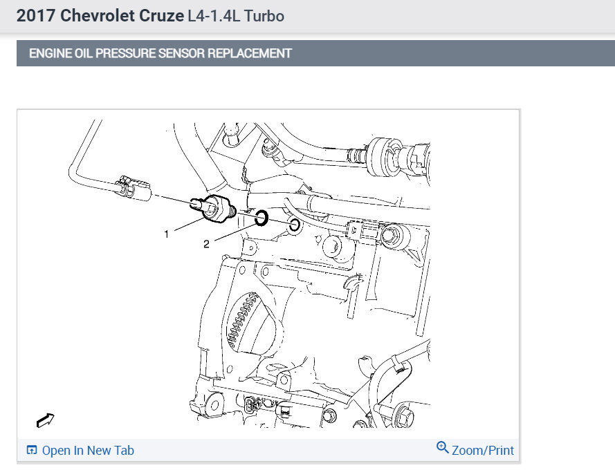

Where is the oil pressure sensor on my car?

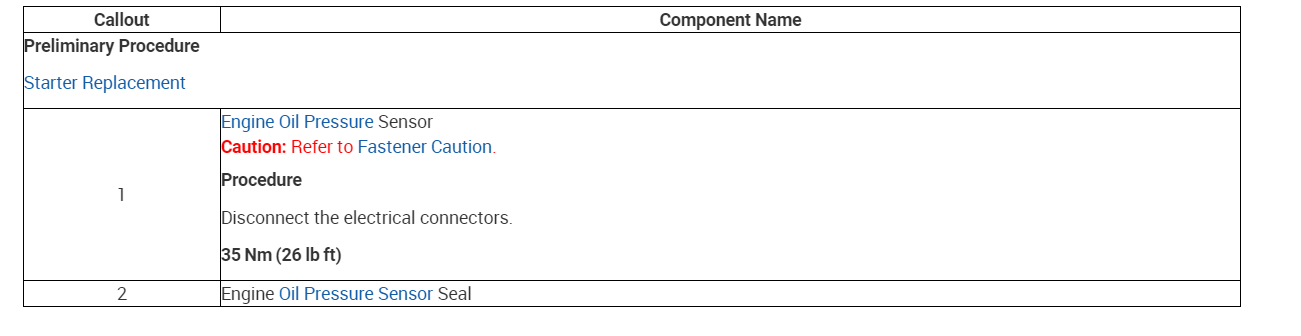

The oil pressure sensor is on the engine block near the rear on the right side of the engine above the starter, check the images below for the exact location.
