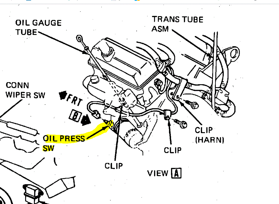

Where is the oil pressure sending unit located on the truck listed above S-10 PU?
Oct 12, 2020 at 3:57 PM

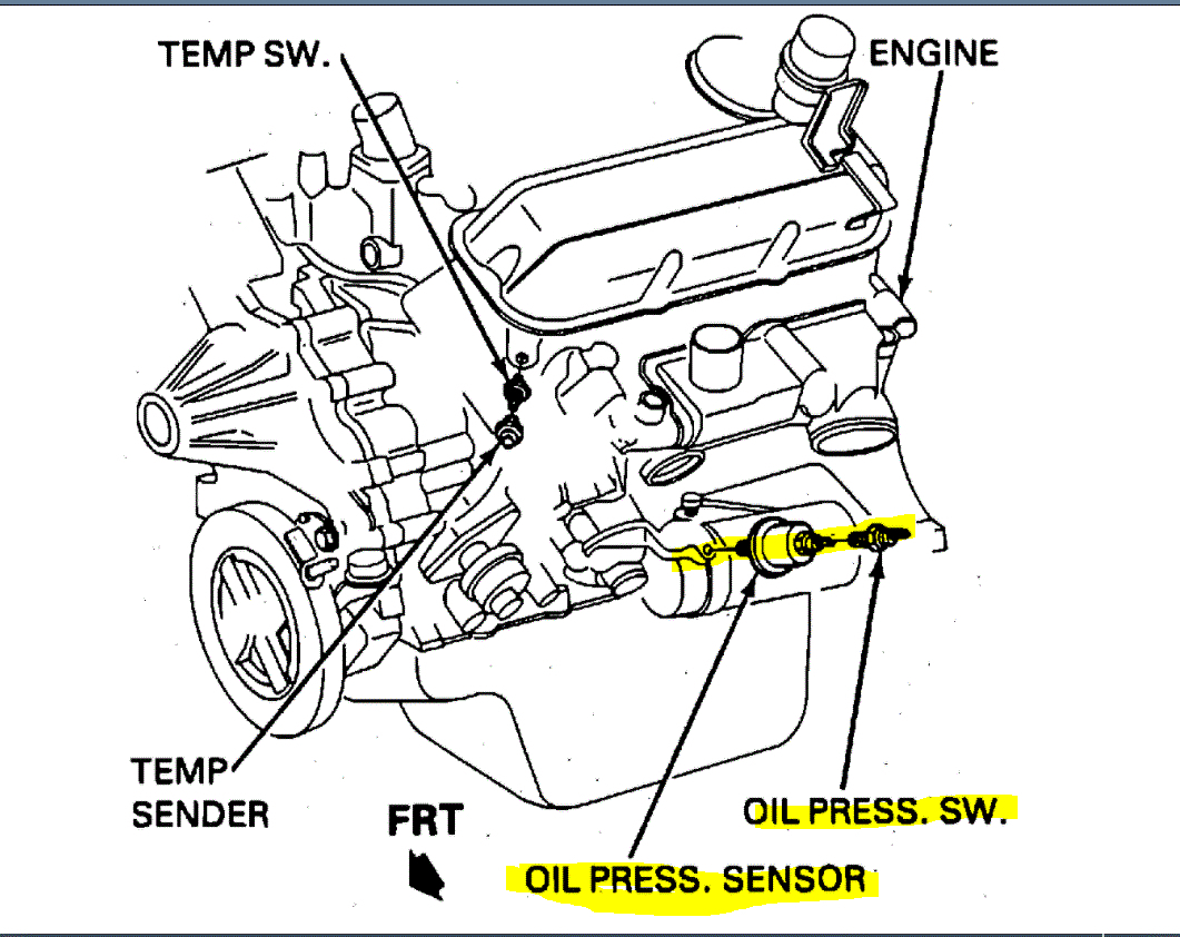

It is right above the oil filter on some, and on the opposite side on others. . Take a look at the attached pictures and let me know if it helps.
