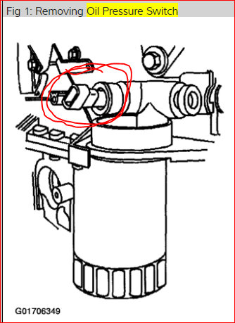

Just curious. Did you notice what the oil pressure reading on the gauge (on the instrument panel ) was reading while this happened? It could be a bad/worn oil pressure sending unit. I have attached a link showing some steps to check the oil pressure. The oil pressure switch is located on the near the engine oil filter. I attached a picture and circled it in red. Hope this helps and feel free to ask any questions if needed.

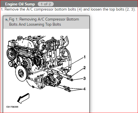

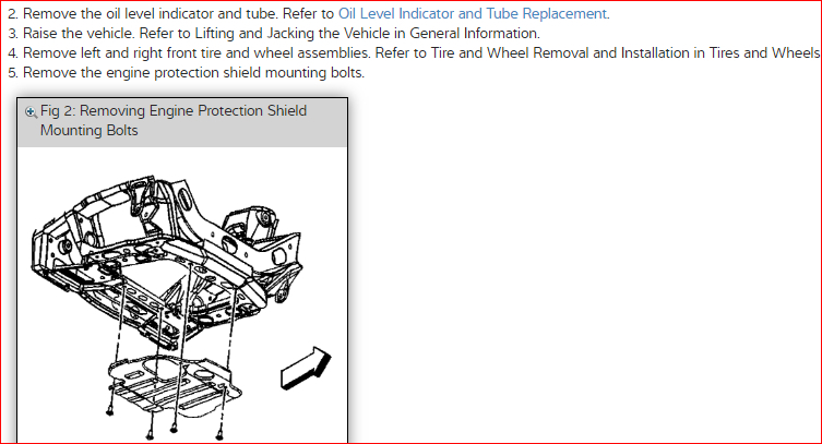

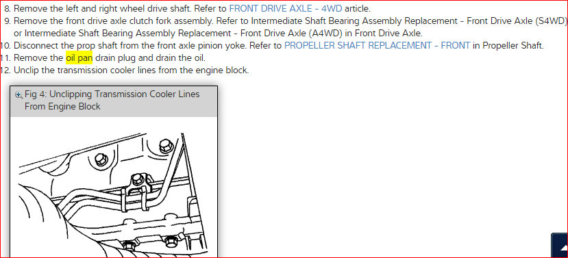

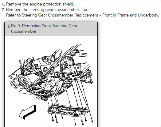

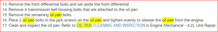

DANNY L
  • 5,648 POSTS
Hello again.
I am attaching the pictures and how-to steps showing what is involved in the oil pan removal process to inspect/replace the oil pump. On a scale of 1-10 this is a 10. Pretty involved. Before you do this, by looking on the dash at the instrument cluster what does the oil pressure gauge read PSI when running/idling? Hope this helps. Thanks again for using 2CarPros.
