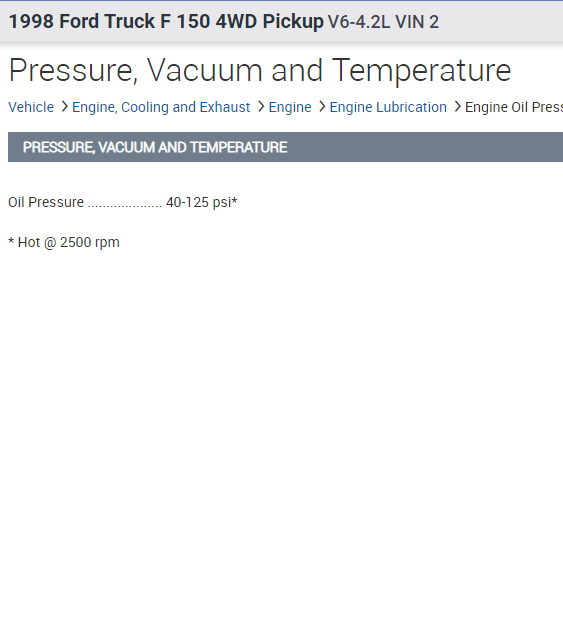

Hi there,

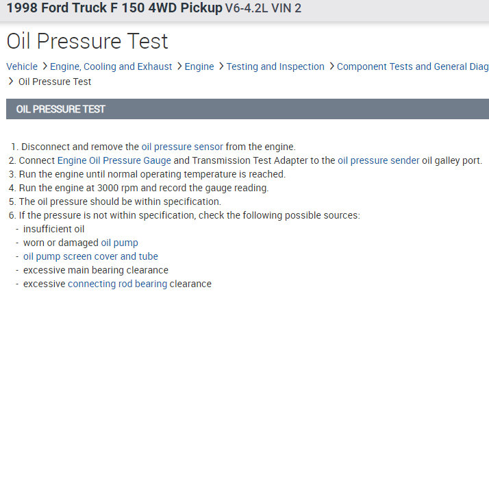

My oil pressure keeps dropping and the gauge seems to just fluctuate. Replaced the oil pressure sensor or sending unit hoping that that would fix the problem but upon turning my vehicle on again the oil pressure gauge was still bouncing. is this an issue with my oil pump? If so, does somebody happen to have a link on finding the location of my oil pump on the 4.2 V6 engine? I'm just hoping not to have to tear apart a whole bunch of stuff on a front end in order to get to it.
