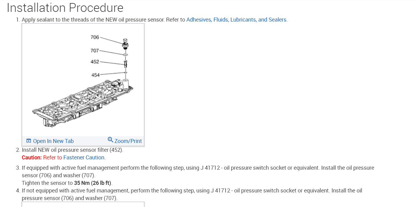

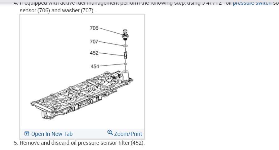

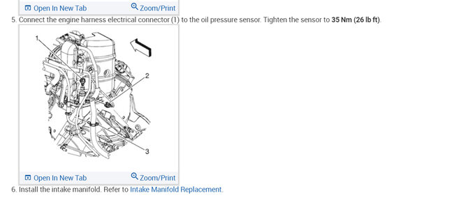

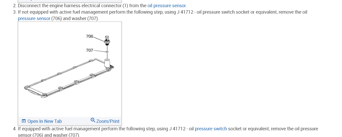

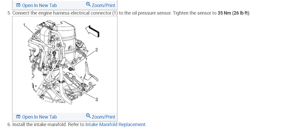

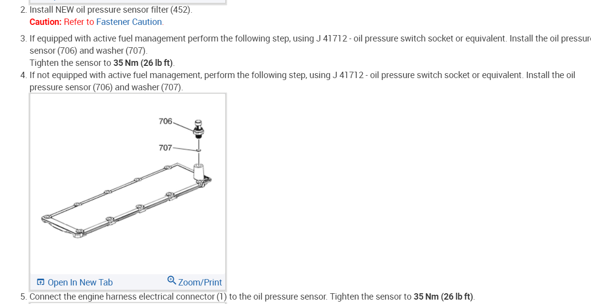

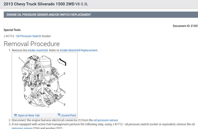

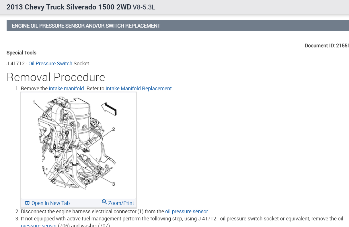

Yep, I would do the oil presser sensor which is located at the rear of the engine behind the intake manifold. First to see if that helps here is the location so you can change it out. Check out the images (below). Please let us know what happens.
