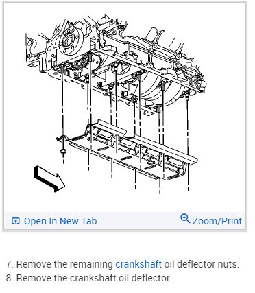

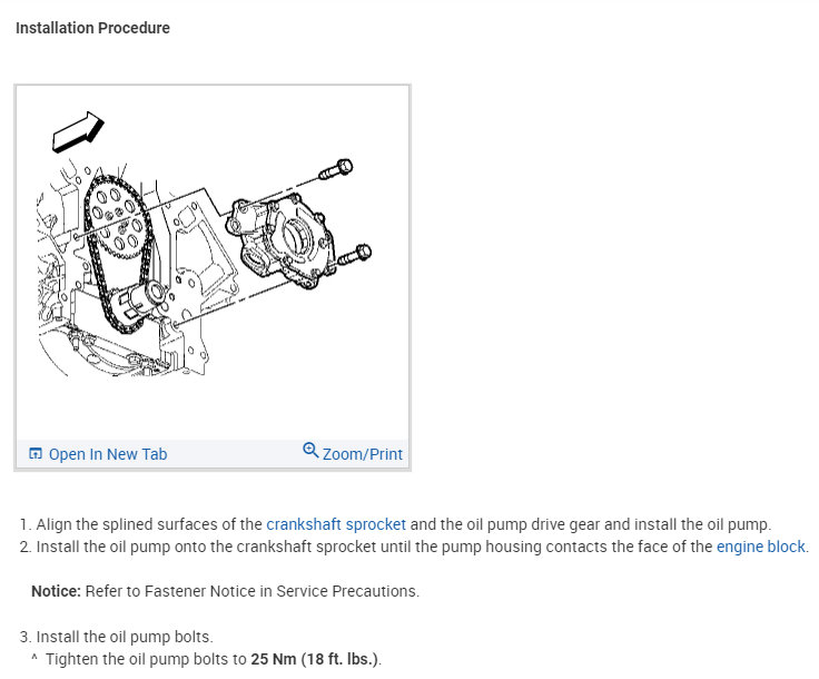

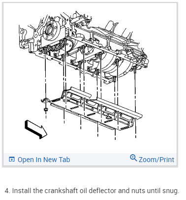

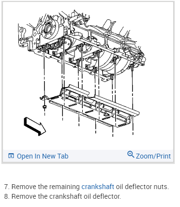

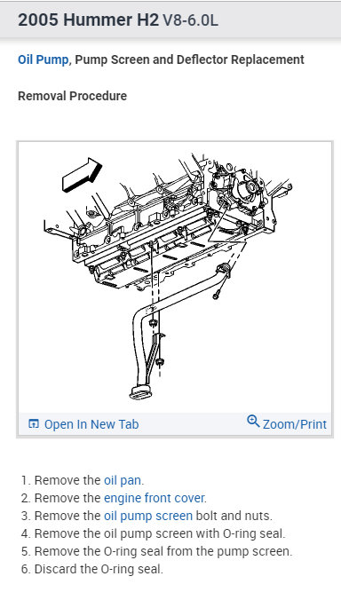

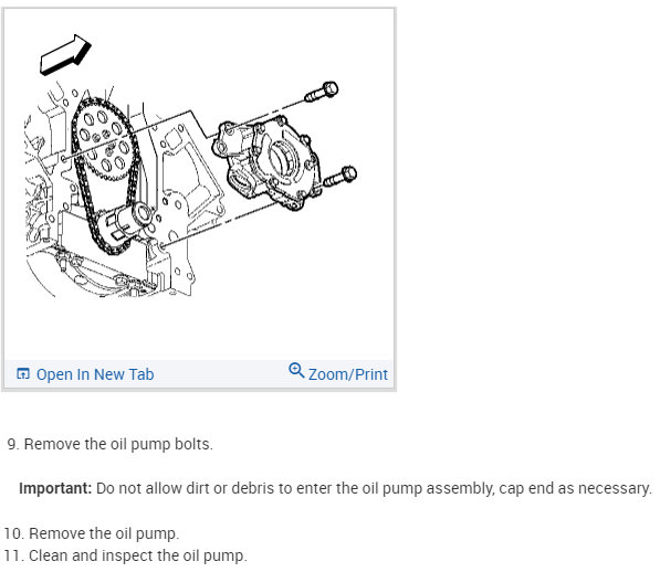

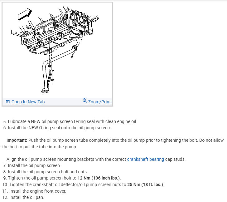

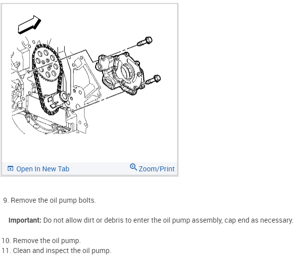

Like I stated this was a common problem for mid 2000's GM vehicles. Something internally happens and runs them low on pressure.Not completely failed, just low on pressure. If you want to forgo the mechanical gauge test I've attached the step-by-step oil pump replacement instructions below.Hope this helps and thanks again for using 2CarPros.
