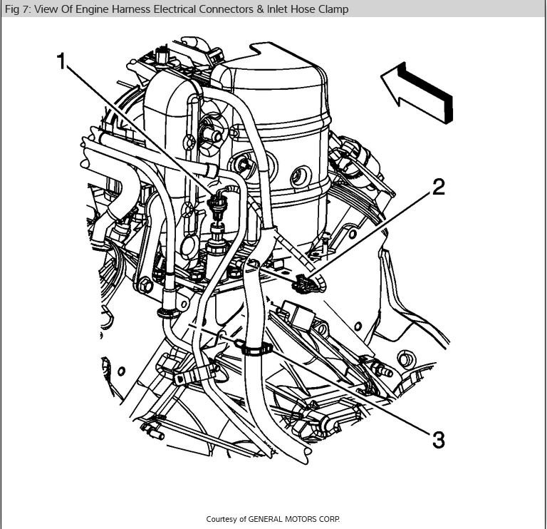

That's okay. It sounds like the oil pressure sending unit has failed.
See diagram below for location. To change it simply unplug the connector, unscrew it, screw new one in and replace the plug.
It is #1 in the diagram.
Let me know if this resolves your issue.
