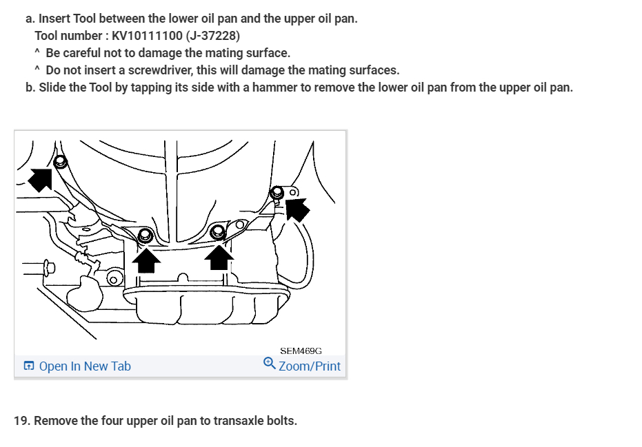

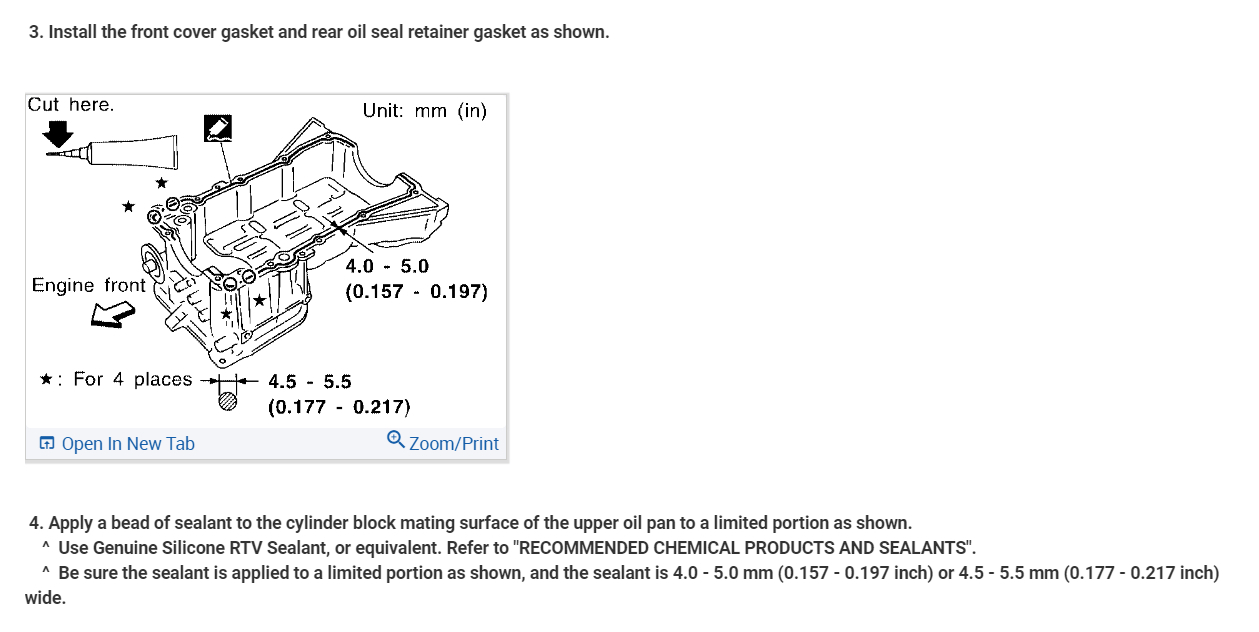

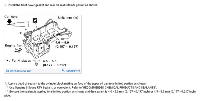

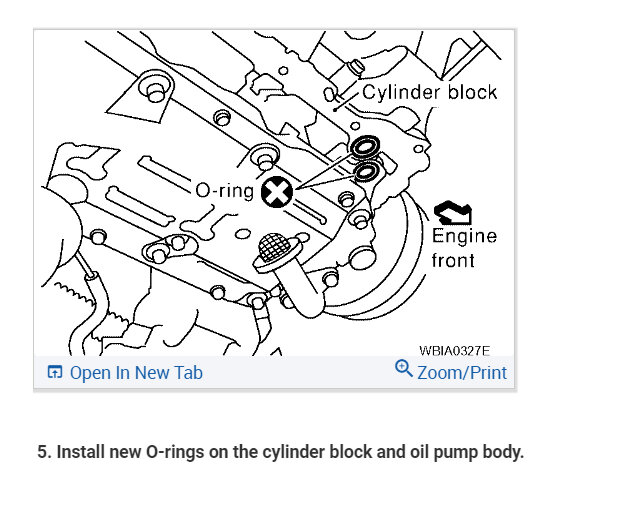

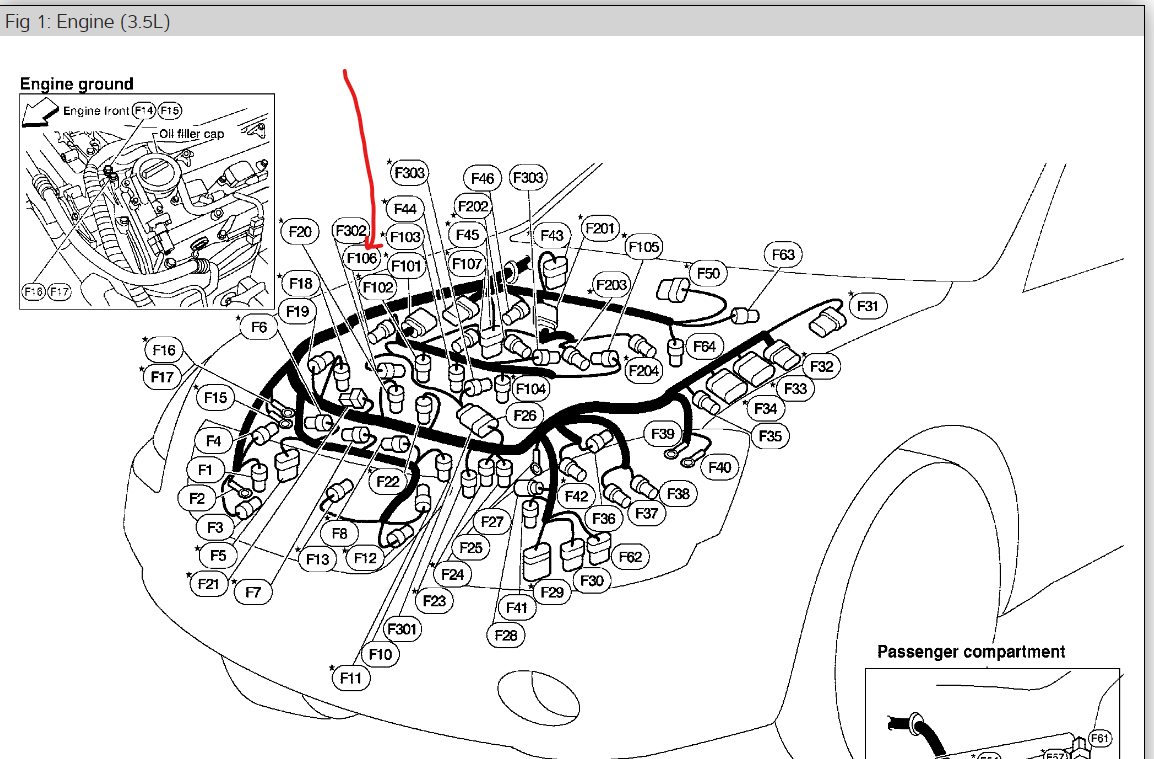

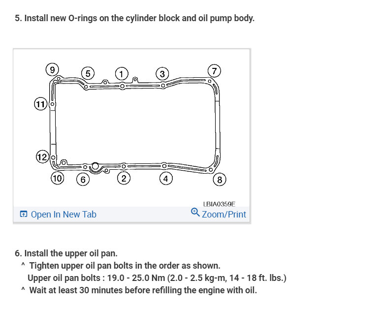

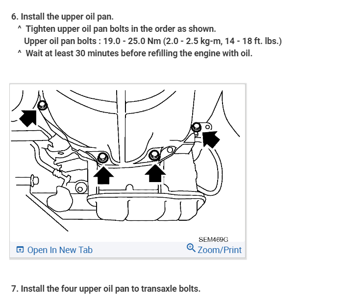

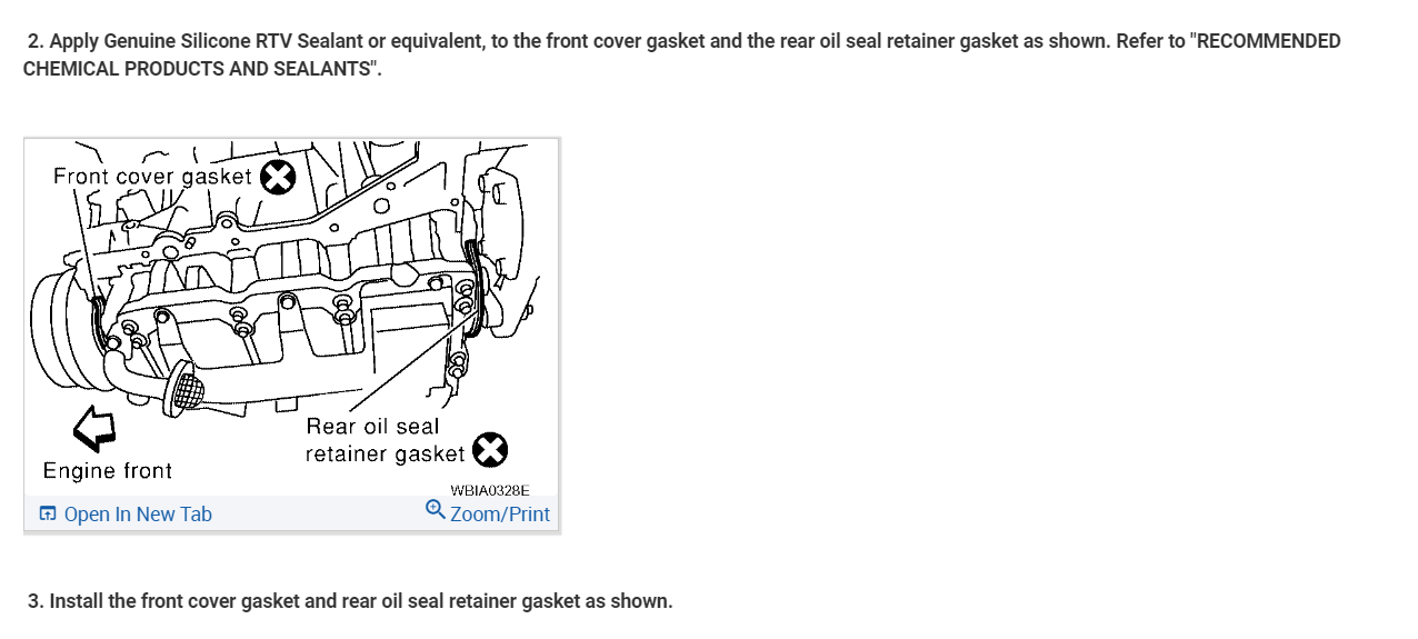

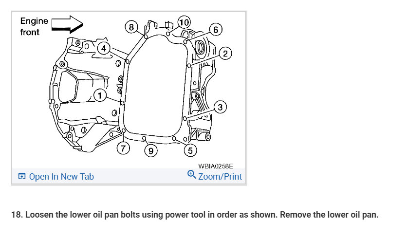

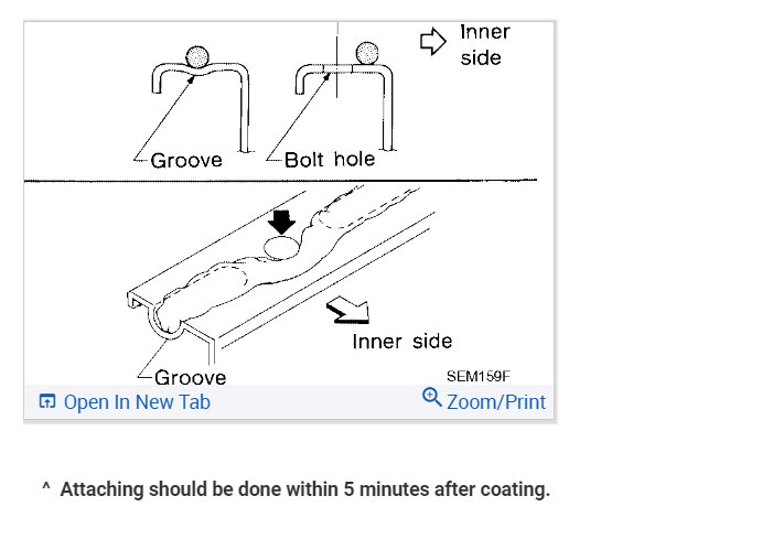

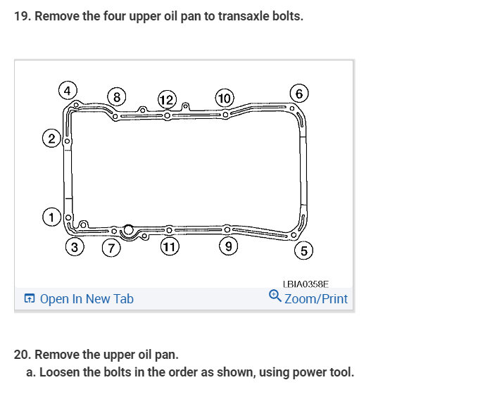

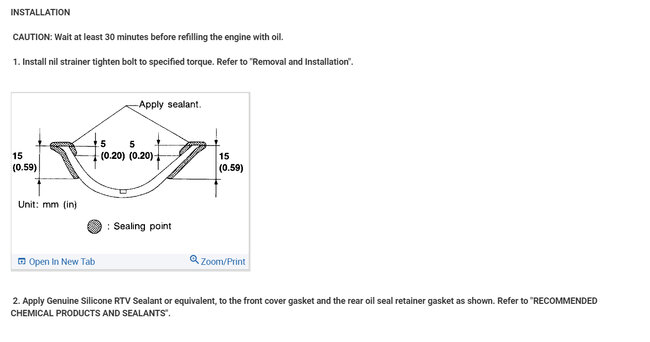

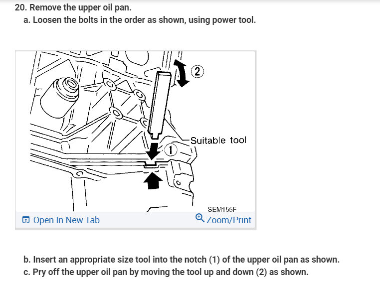

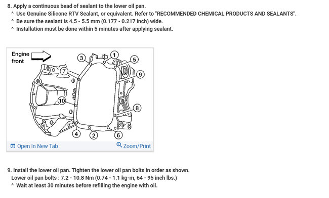

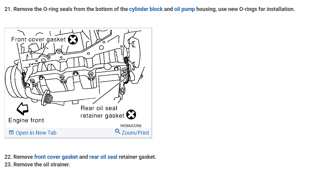

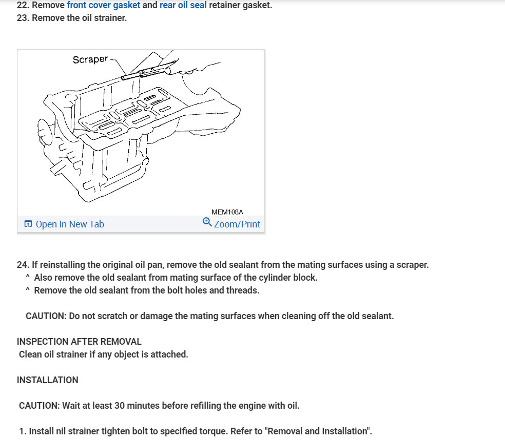

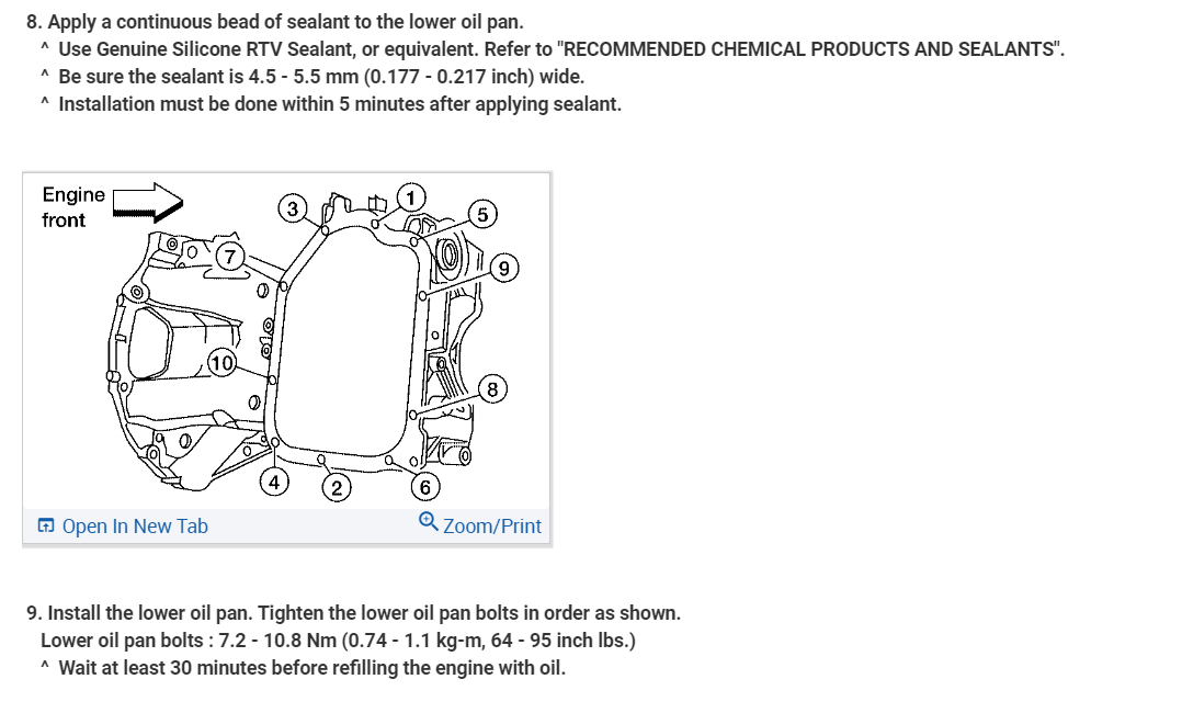

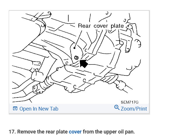

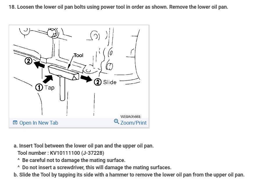

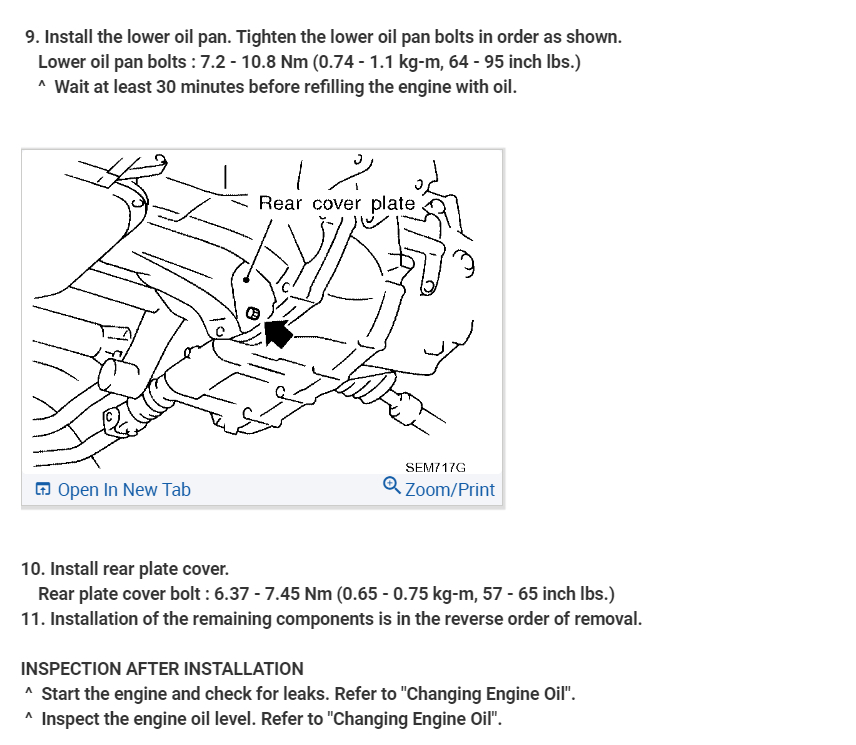

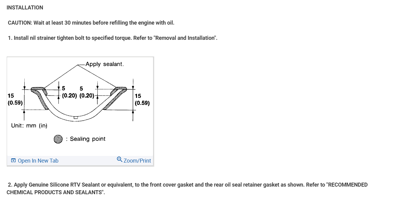

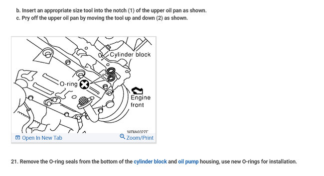

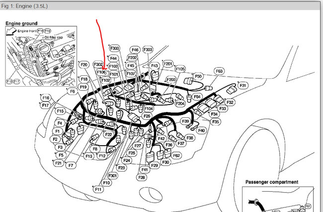

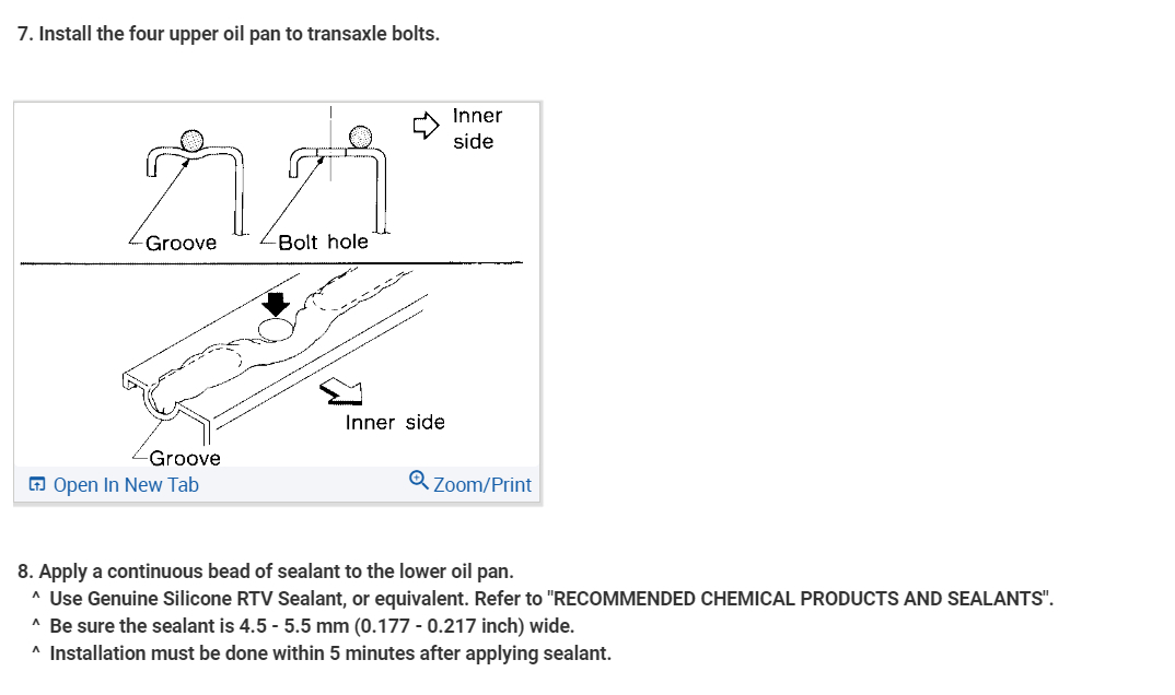

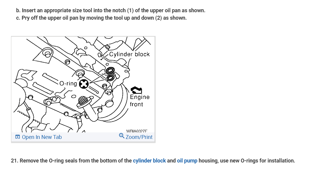

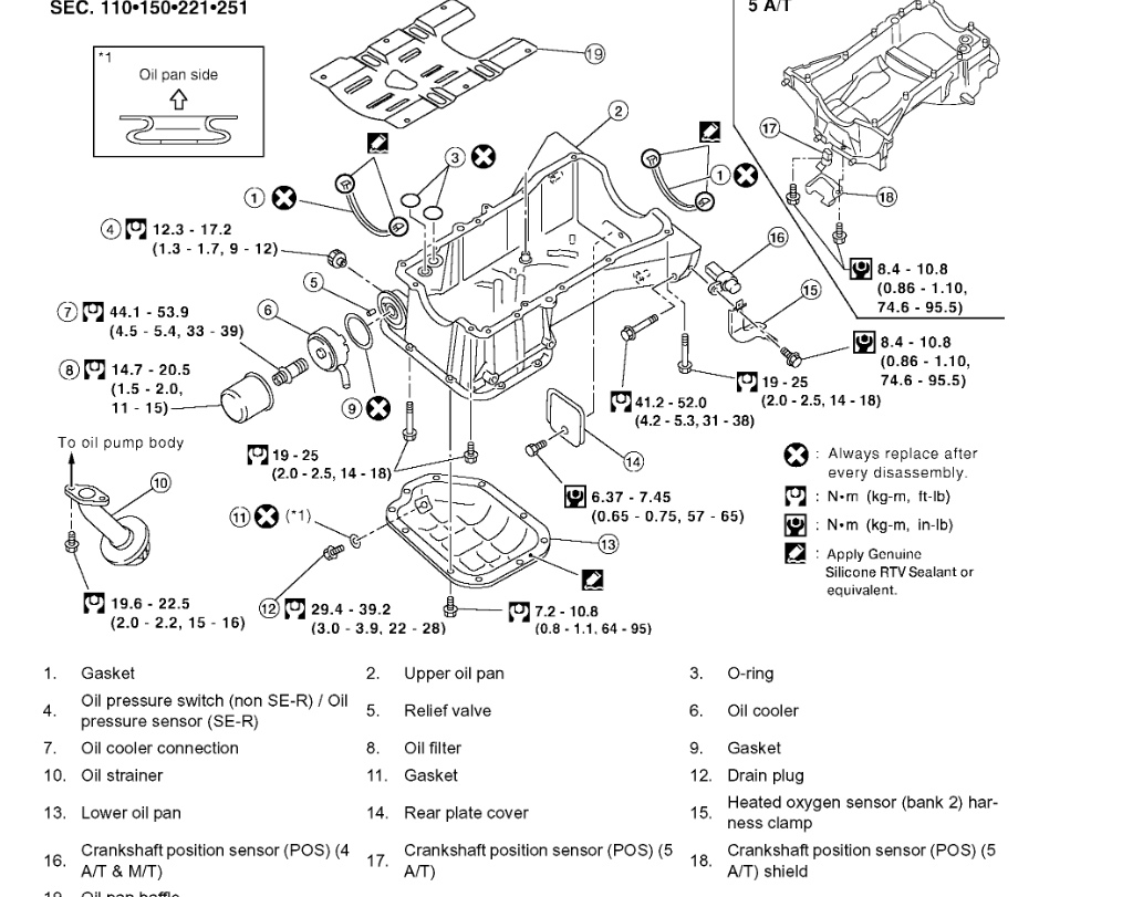

It could be the oil pressure sender, or the oil pan is filled with gunk and needs to be cleaned out. here is the location of the oil pressure sensor so you can check it out and I have left the instructions on how to remove the oil pan in case you need it. (F106) If the sensor doesn't help change the oil and filter after you remove the oil pan and clean the oil pump pickup.
https://www.2carpros.com/articles/how-to-change-engine-oil-and-filter
