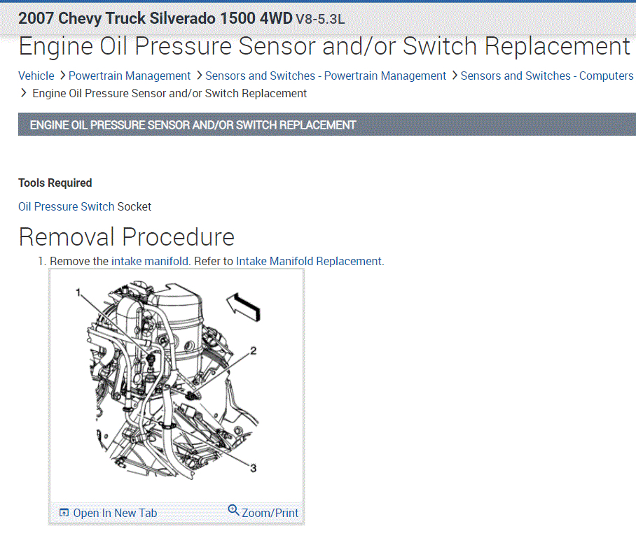

When it dropped to 0, were there any noises from the engine such as ticking or knocking noises? If there wasn't, chances are it is related to the oil pressure switch.
Here is a link that explains different engine noises. I'm adding it in the event you did hear something.
https://www.2carpros.com/articles/engine-noises

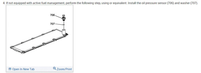

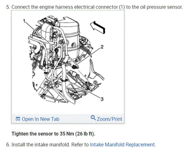

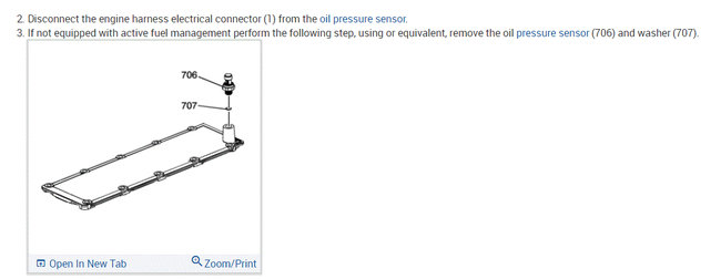

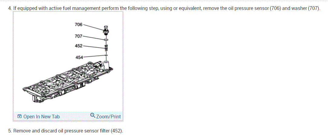

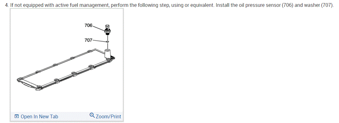

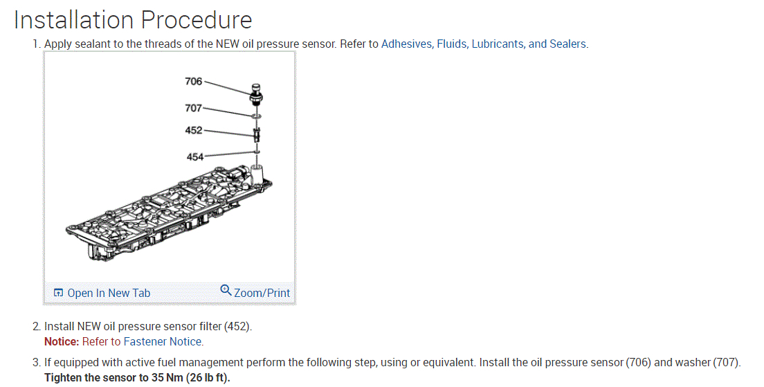

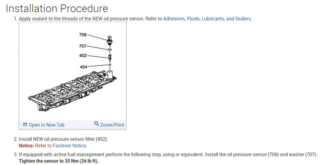

I'm not sure which engine you have, so I selected a 5.3L which is the most common. The problem with this is the sensor is located under the intake manifold.
I attached directions below for replacement. However, we need to determine first if I have the correct engine, if there is any knocking or ticking when there is no pressure, and if there are any wiring issues.
See pics below.
