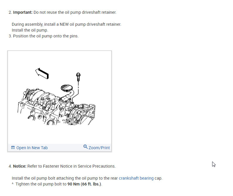

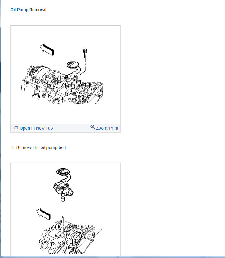

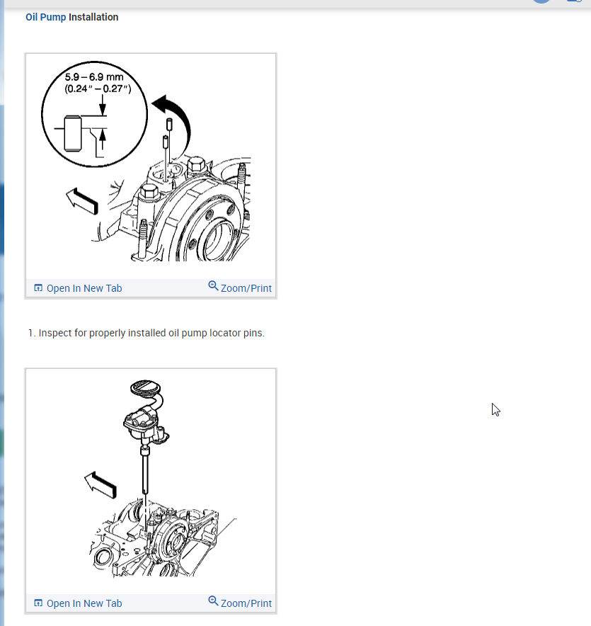

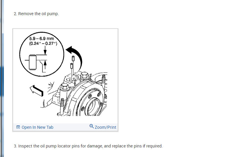

That means if the oil is correct then we are going to have to replace the oil pump. However, first thing you can try is a thicker oil or an additive that thickens the oil and see if this helps.
If not, I suspect we are going to have to replace the pump so I attached the info on that below.
