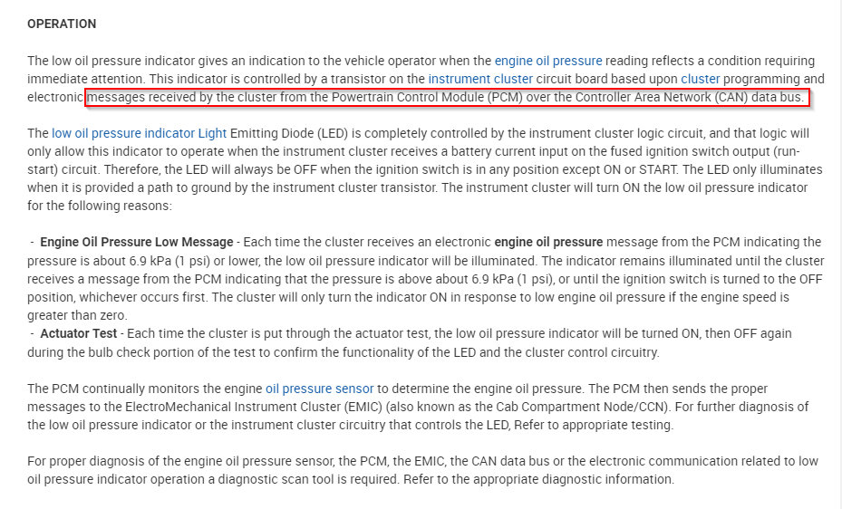

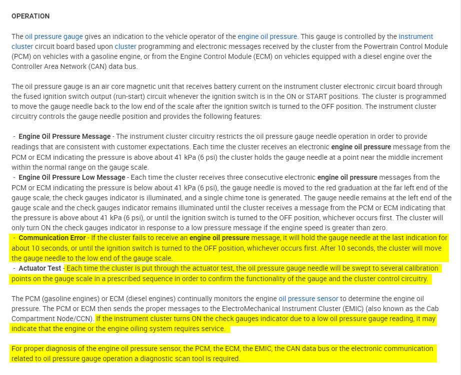

Take a look at this document. It goes through the operation of the system but the first step is needing to read what the sensor is telling the PCM the oil pressure is. If this matches what the gauge is showing then we have either an oil pressure issue or a sensor issue. However, since you confirmed it has 60 PSI this would leave a sensor issue.
If the PCM is showing the same as the external gauge that you hooked up then we have a communication issue or a cluster issue.
When you start the engine and the gauges go through there self checks of sweeping the gauges, does the oil pressure gauge perform this sweep?
If not, I suspect we have a cluster issue.
Read through this operation document and let me know this issue and we can go from there. Thanks
