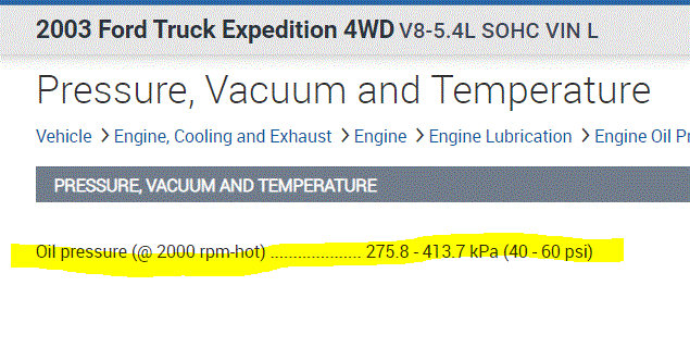

Do me a favor. Let's confirm it is an oil pressure issue. What I need you to do is get a mechanical oil pressure gauge from a parts store. Most will lend one to you.
Next, remove the present electric oil pressure switch and screw in the mechanical one. Start the engine and see what pressure is being produced.
Do this and let me know what you find. I attached the manufacturer's specifications below.
Take care,.
See pic below.
