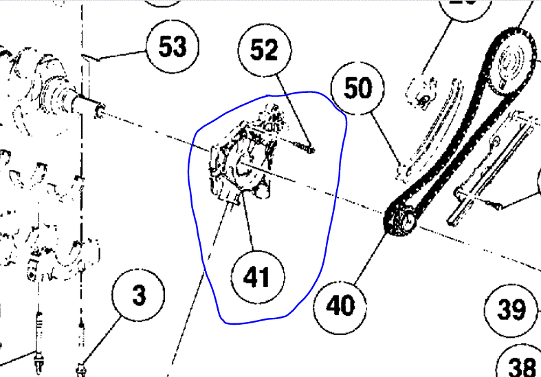

That is really high. Are you basing that on the gauge in the vehicle or have you checked it with a mechanical oil pressure gauge to confirm? I ask because if the pressure is that high, the pump needs to be replaced. System pressure is limited by an integral, internally-vented relief valve which directs the bypassed oil back to the inlet side of the oil pump.
___________________________________
Let me know. If I recall, it can be replaced without removing the engine, but because of it's location, you need to remove the timing chains. Take a look at the attached pic. I circled the pump. From the pump is a tube that goes to the oil pan.

it's a mechanical gauge that I installed. is there a way to free up the valve without pulling the engine?
Nov 22, 2020 at 9:37 AM
No. It is internal in the pump. The pump will need to be replaced. You can replace the pump in the vehicle, but it's tight.
