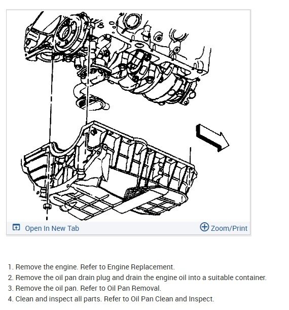

Hi, I'm trying to change my oil pan and gasket. I have drained everything and took all the bolts out. I can find I can move it, but it won't drop all the way out. Is there anything else I should remove in order to drop the pan all the way?

The pan won't come out without raising the engine up so the pan can clear the oil pump pickup strainer. Even then it is very tight. That is why the first step in the service information is to remove the engine. I have, however, seen a process where you drop the pan, raise the engine up and then clean up the surfaces and install the gaskets with the pan just hanging under the engine. However, that assumes the current pan is okay. You say you are changing yours? Why? If it's a stripped drain plug you could just install a good thread insert into it, like a time-sert or other thin wall locking thread insert. With the pan down you could clean it out easier as well.
