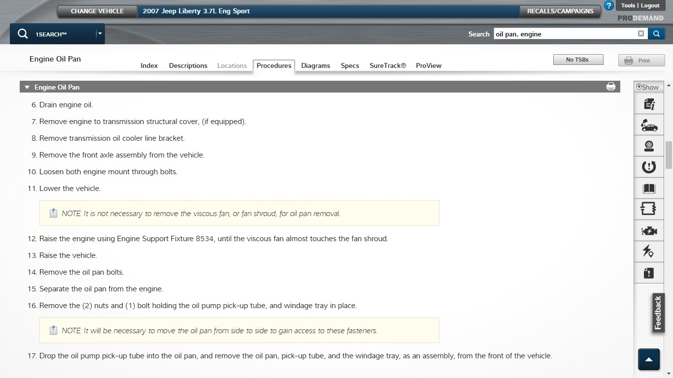

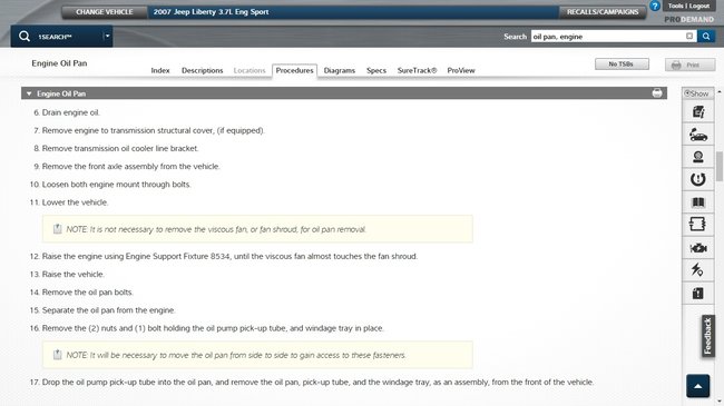

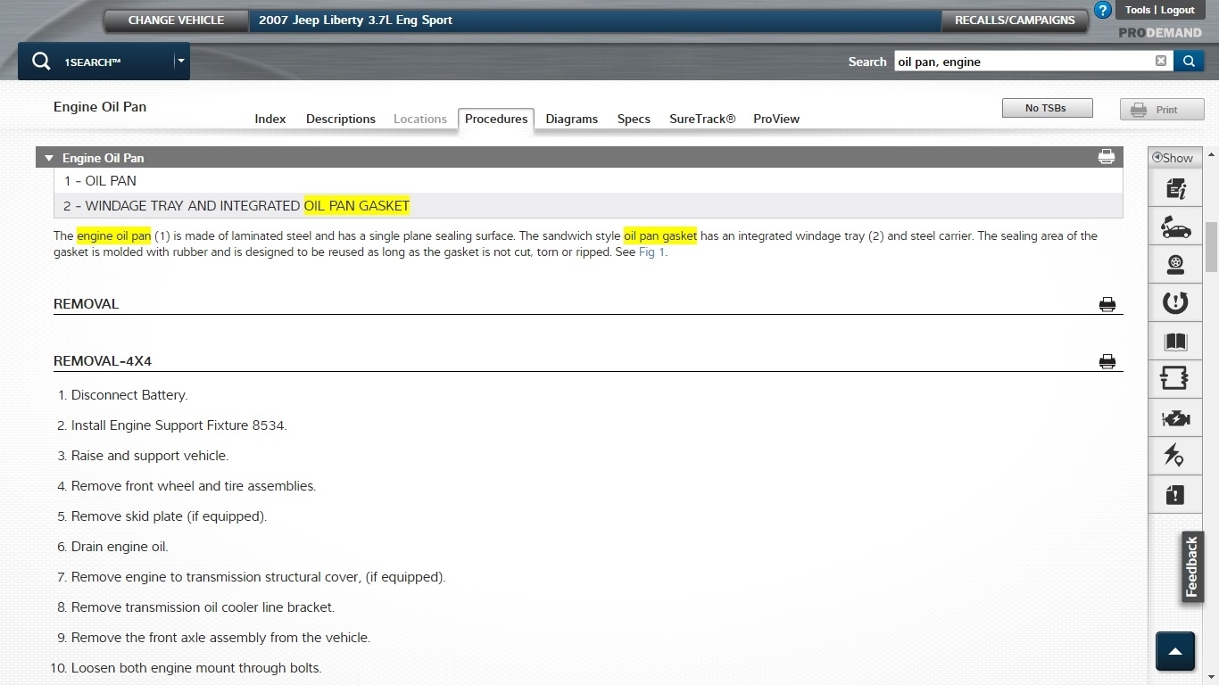

Hi, Does anyone have a trick to removing the oil pan? this thing is all wheel drive for 1, 2 the oil pick up is in the pan, is bolted to the pan, and i can only get it to drop to drop 1/2 inch. Looks like a motor pull? thanks
