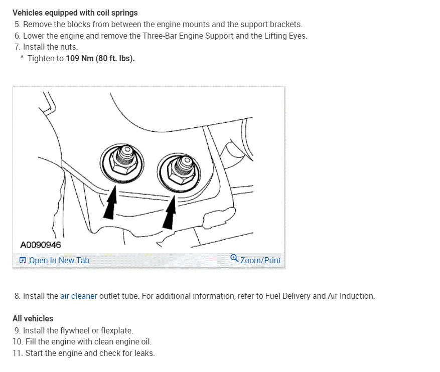

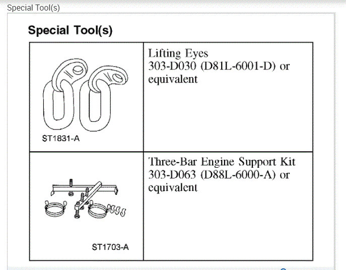

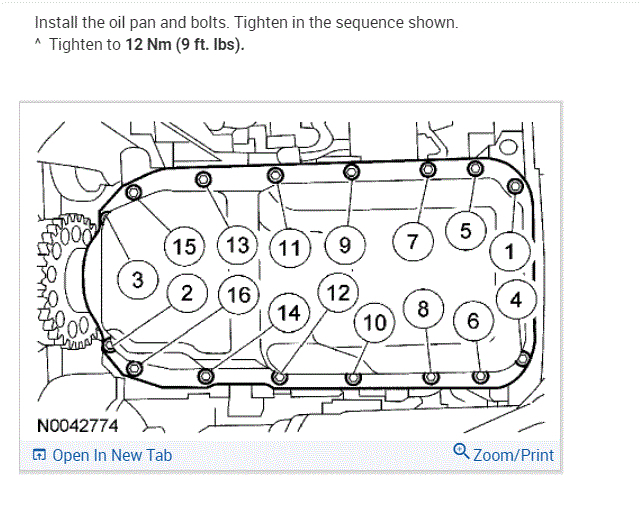

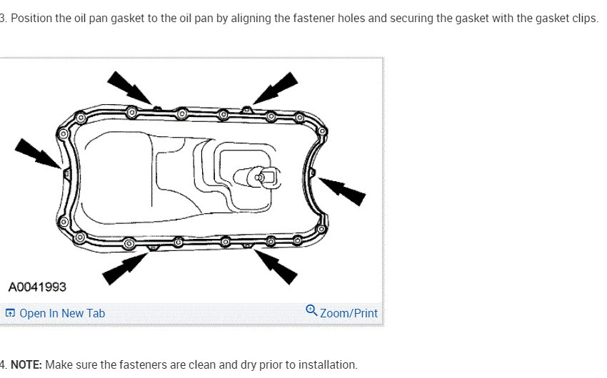

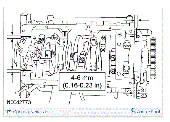

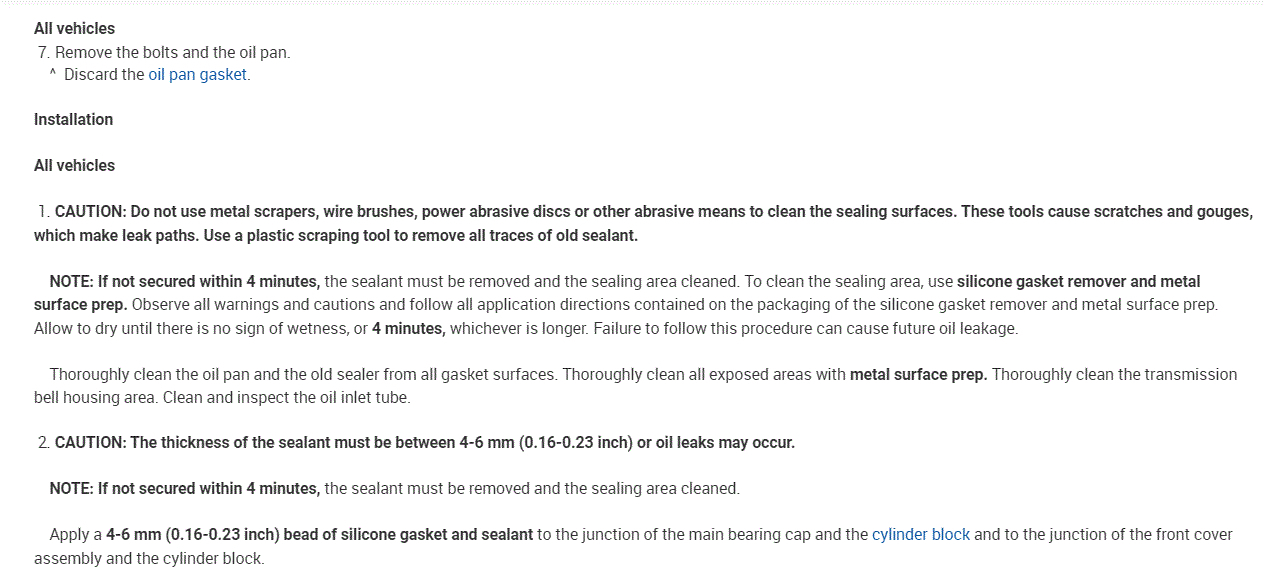

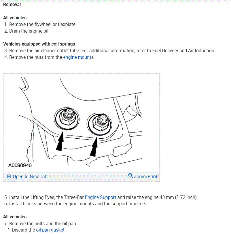

You do have to lift the engine a bit to remove the pan. Believe it or not, it needs to be lifted less than 2 inches.

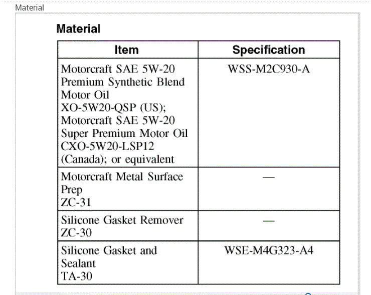

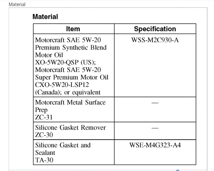

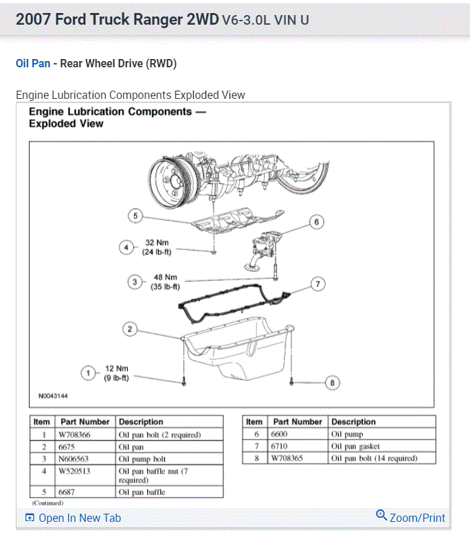

If you look at the attachments below, I provided the directions for oil pan/gasket replacement. Since you already have the transmission removed, it will cut out part of the work because the directions indicate the flex plate needs to be removed as well.
The directions include torque specs and tightening sequence.
See pics below.
