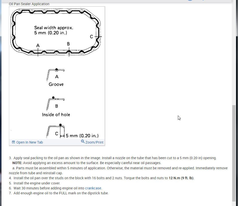

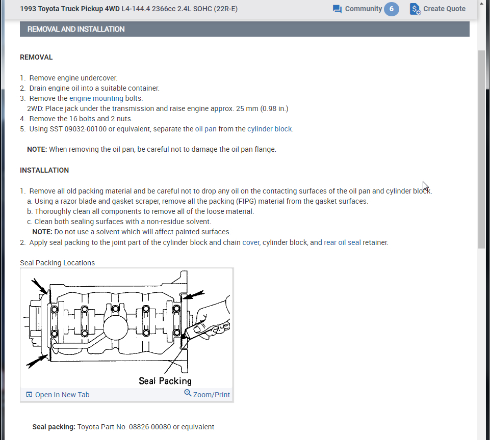

I am attaching the info from the manual on the 22 RE motor which appears is what you have on this truck.
There are also a lot of videos from DIYers on the internet but some of them are pretty out there so I didn't add them to this post as I don't want to support that nonsense. However, some of them will give a visual of what it takes.
It doesn't appear to be too bad but let us know if you need more info on it and we can dig deeper. Thanks
