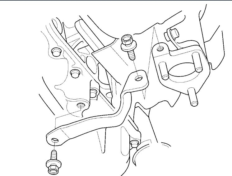

6. Remove the rear warm up TWC bracket.

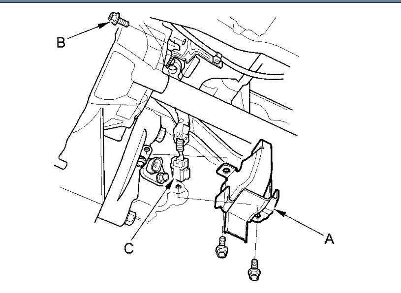

7. Remove the CKP sensor cover (A) and the bolt (B), then disconnect the CKP sensor connector (C).

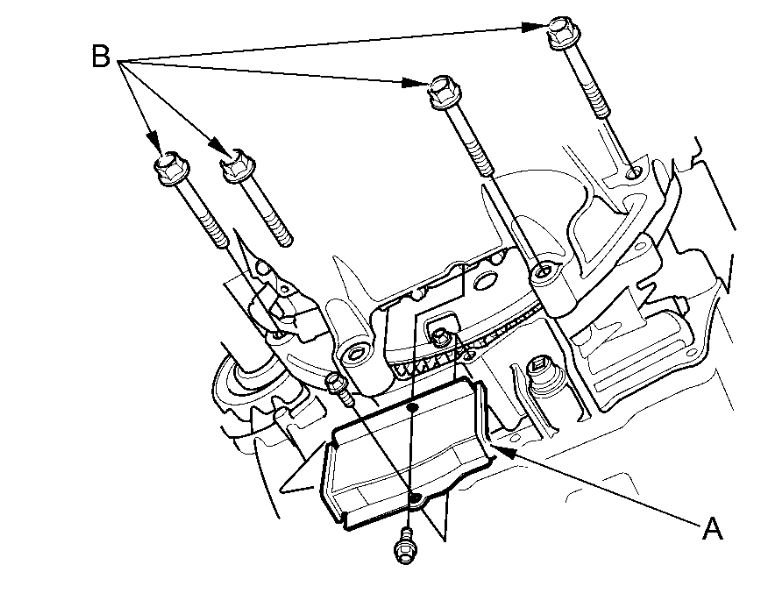

8. Remove the torque converter cover (A) and the four bolts (B) securing the transmission.

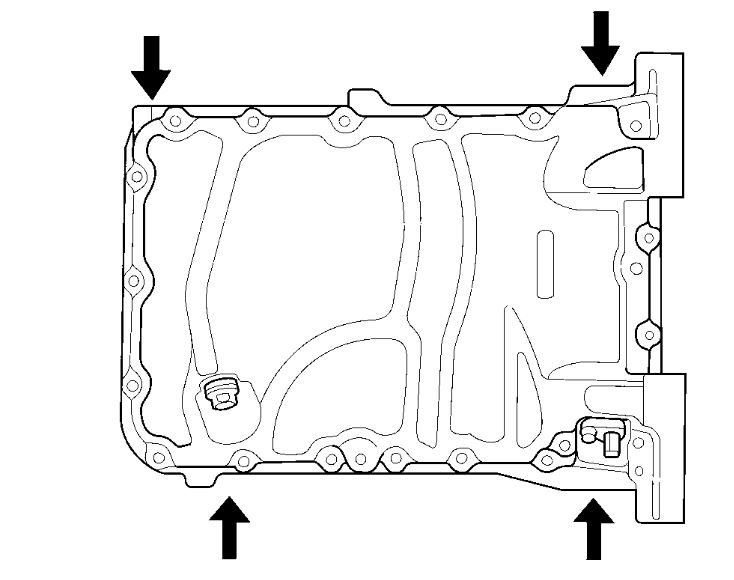

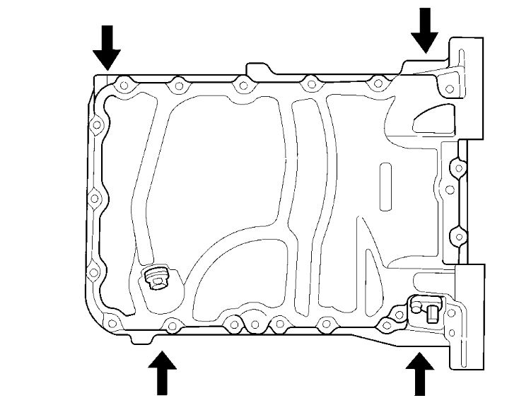

9. Remove the bolts securing the oil pan.
10. Using a flat blade screwdriver, separate the oil pan from the block in the places shown.
11. Remove the oil pan.
