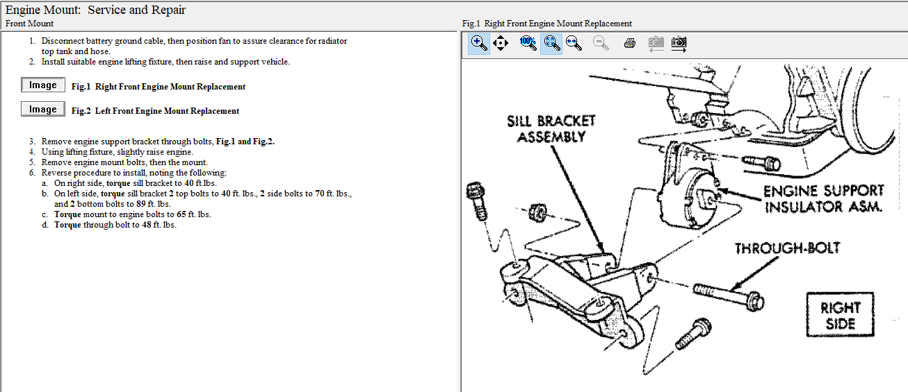

you feel any vibration at idle, it seems engine mounts are defected that its seating position lowered that touches the differential housing. can you send us some pictures? check fig 1 for complete procedure how to replace engine mount.
This is our guide how to replace engine mounts:
https://www.2carpros.com/articles/replace-motor-mounts
let us know what happens with you.
