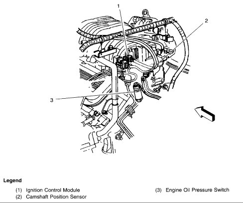

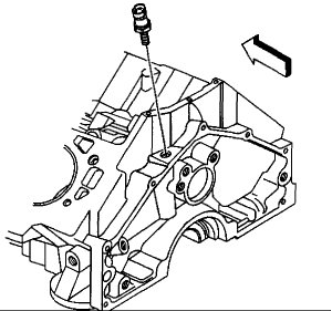

If you decided to do it yourself, here are directions and pics to locate the component.
SERVICE AND REPAIR
Removal Procedure
Tools Required
J 25254-10A Oil Pressure Sensor Socket
Disconnect the electrical connector from the engine pressure sensor/switch.
Remove the oil pressure sensor using J 25254-10A.
Installation Procedure
Tools Required
Install the oil pressure sensor.
Hold the oil pressure sensor fitting with a wrench to prevent from turning.
Using J 25254-10A tighten the oil pressure sensor to 30 Nm (22 ft. lbs.) .
Install the electrical connector.
Let me know if you have other questions. Also, I would like to know how things work out for you.

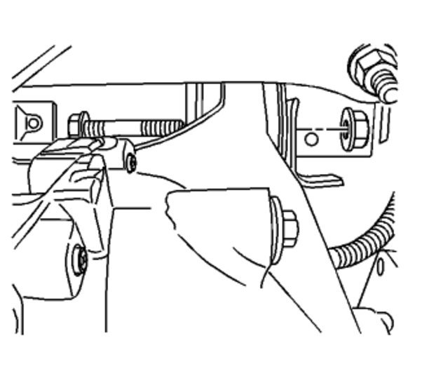

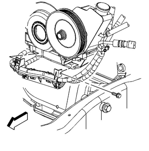

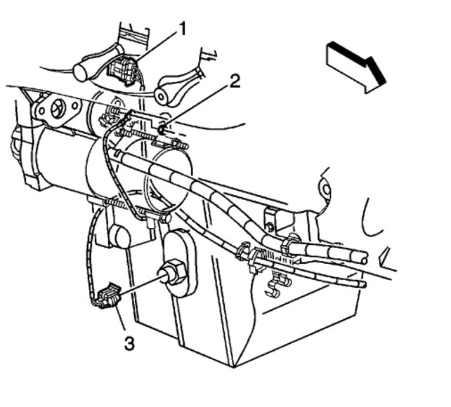

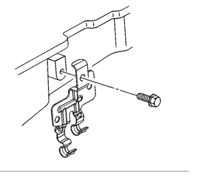

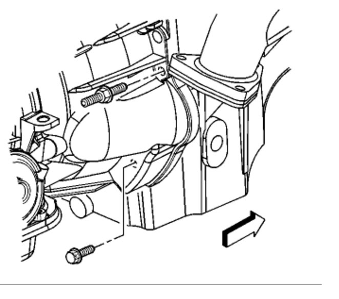

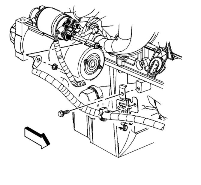

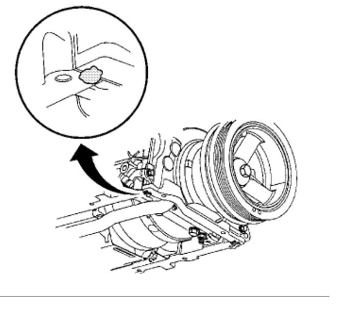

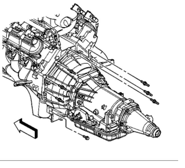

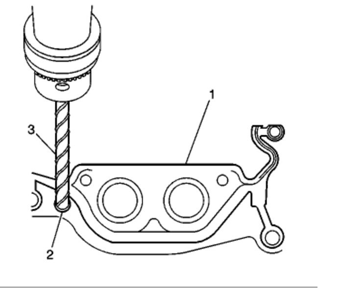

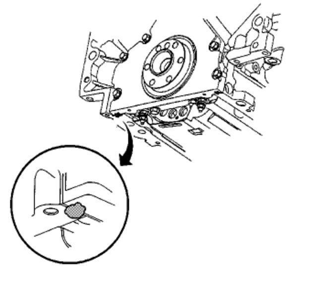

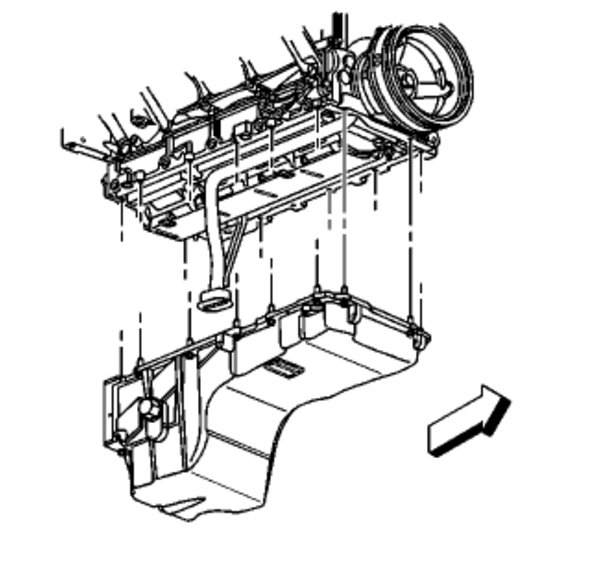

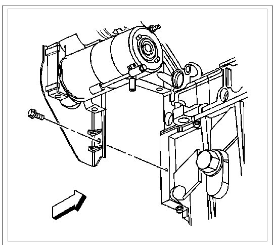

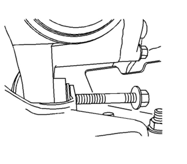

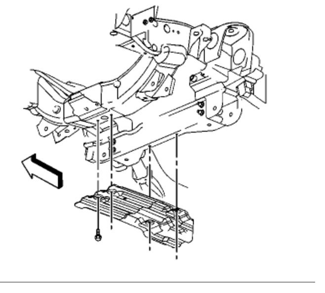

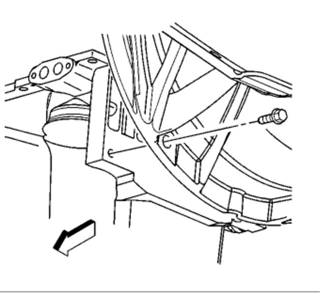

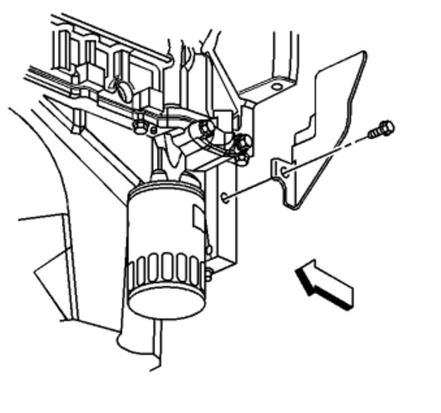

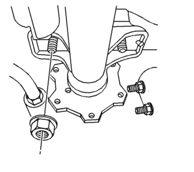

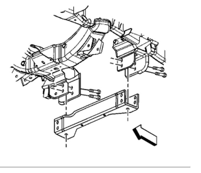

One of two things could have happened either the oil pump regulator spring it stuck or the oil pump pick up is clogged. Either way the oil pump must be changed. Here are diagrams to help you with the job.
Check out the diagrams (below). Please let us know what you find.
