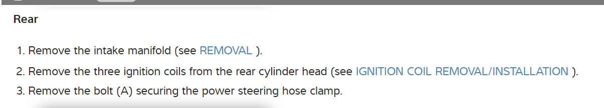

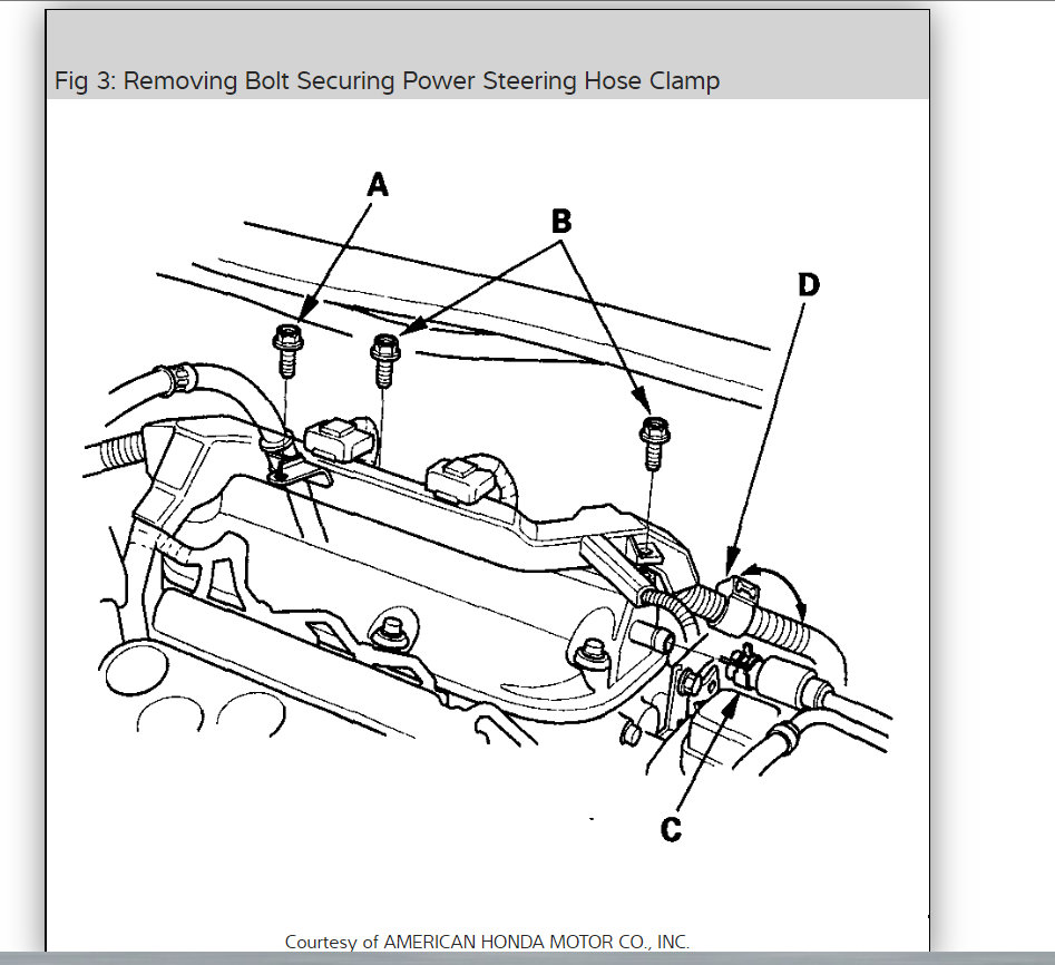

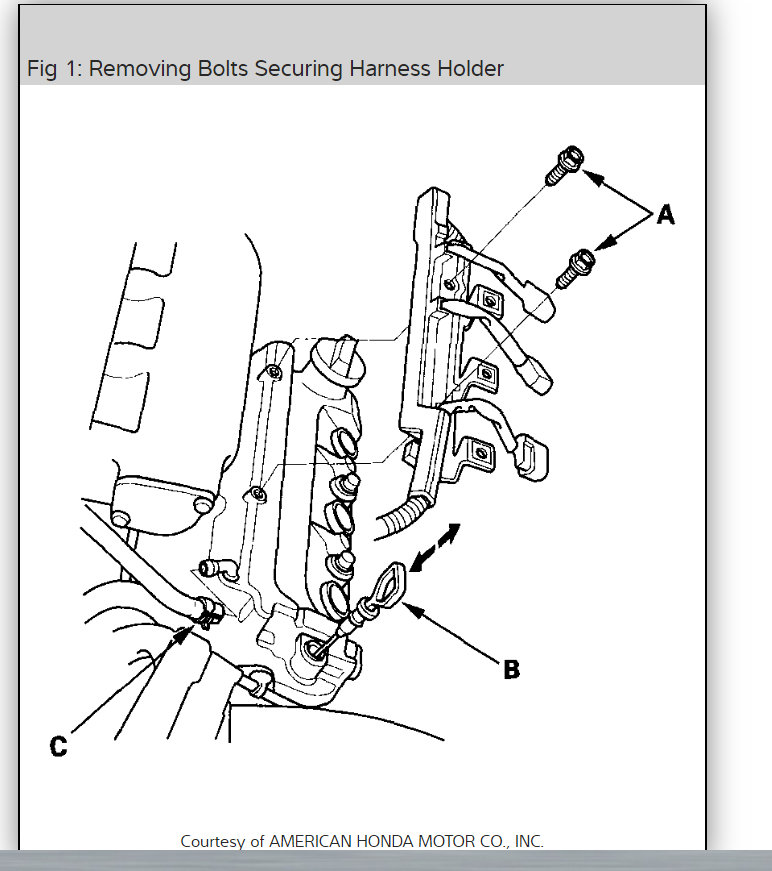

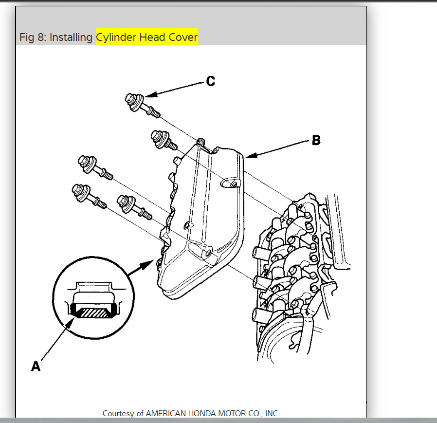

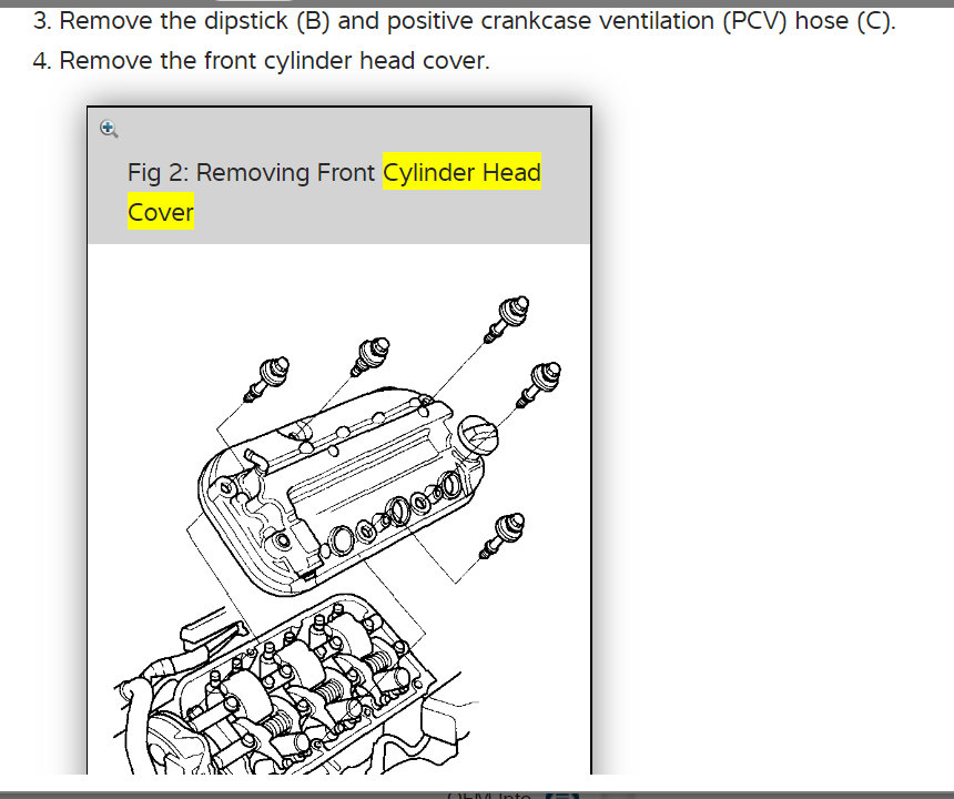

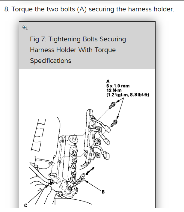

I have misfire on cylinder three, when I checked if the problem with coil or the spark plug, I was shocked the coil was full of oil and the plug was terribly burned.
I need to know what parts I need to replace (if part numbers please).
Also, if there is a link of video on how to do so.
If no video, photos and diagrams will help.
Many thanks...
