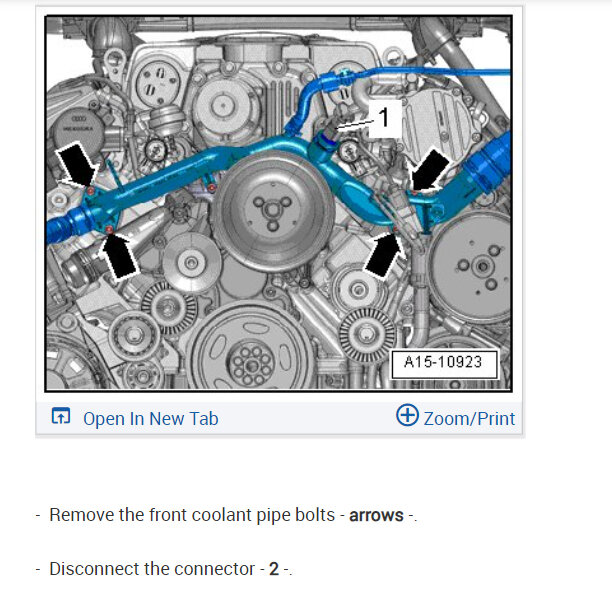

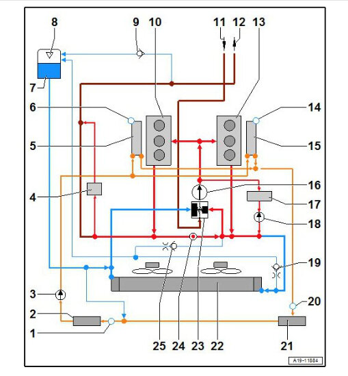

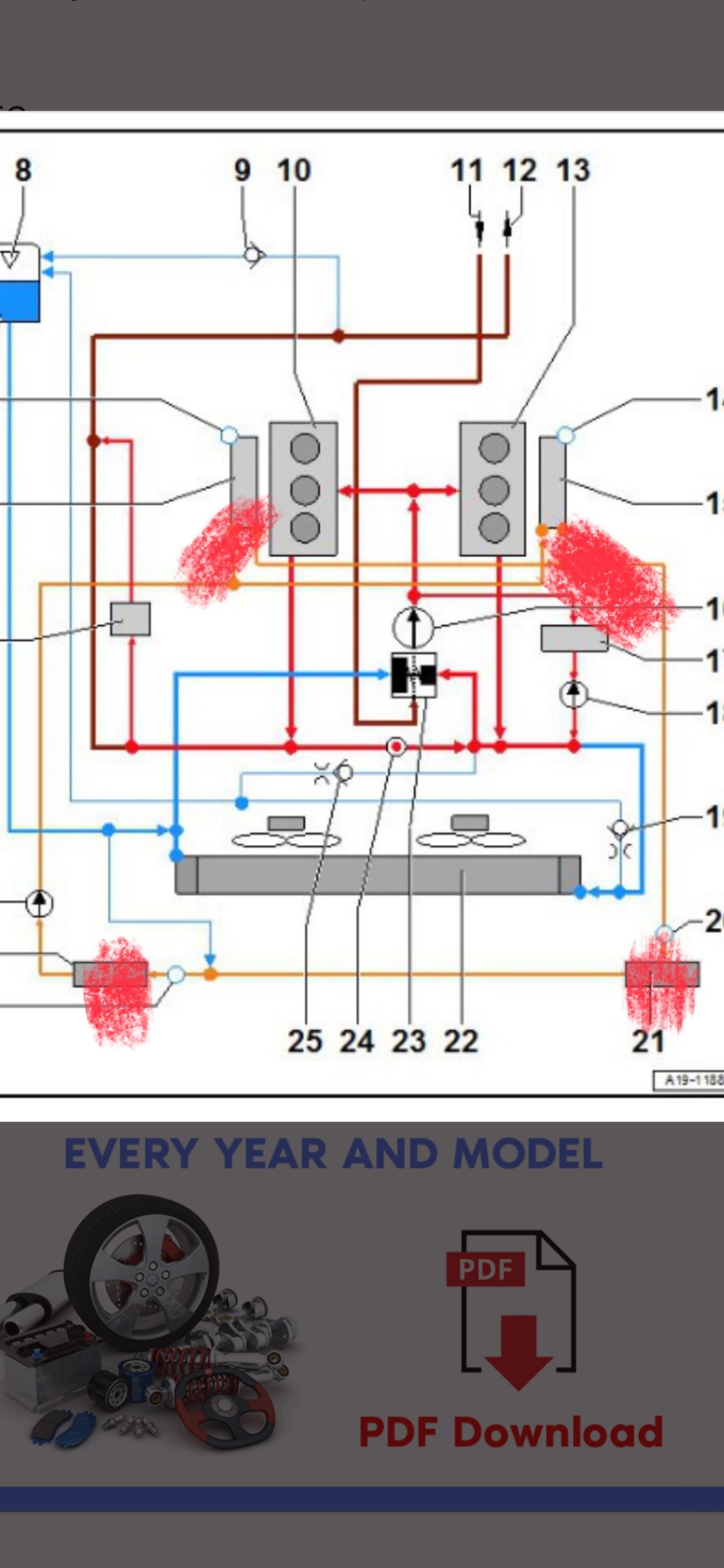

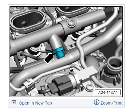

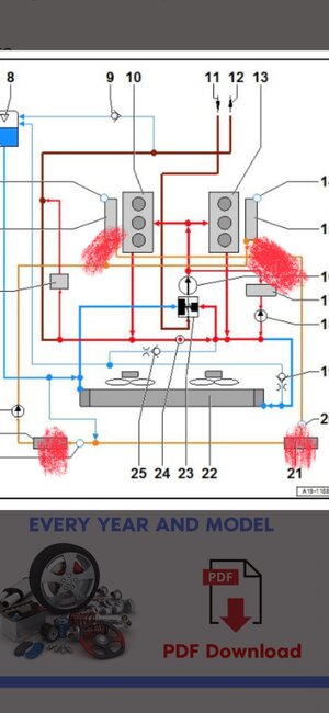

I'm not sure I understand what was done. Do you mean this started after the lower intake was removed and reinstalled?
Do me a favor. I attached a pic below of the coolant flow throughout the engine and engine compartment. Take a look at it and let me know what you had to replace.
See pic below.

Please advise on the colors, the red is hot water blue is coolant, brown and the other colors, could you help me with the color meaning, from that I can retrace my steps.
Mar 3, 2024 at 12:37 PM
ANDRIN ATEM
  • 393 POSTS
From this diagram, does water go through the air intake manifold?
ANDRIN ATEM
  • 393 POSTS
These four points I marked with red, does water go through them or air? Because I manually filled them with water hoping to bleed air out of the system.
Mar 3, 2024 at 12:42 PM
ANDRIN ATEM
  • 393 POSTS
From this diagram I can clearly see I am dealing with a blown head gasket. Because I noticed water leaking out from the spark plug holes on bank two after car idled for about 10 minutes, I shut off the engine and took out the plugs on cylinder 4,5 and realized coolant coming out. The diagram explains why and how coolant could come out. Please advise me if I am wrong. Also, oil mixes with water.

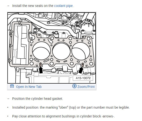

Please also help me with the diagram on replacing a head gasket and tuque specifications on tying bolds trimming. At this point I am looking at head gasket replacement.

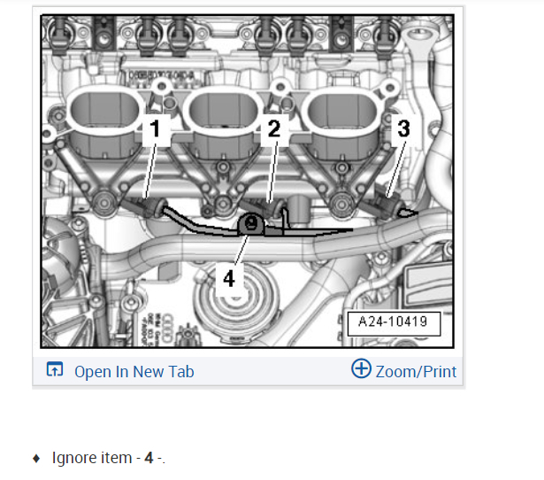

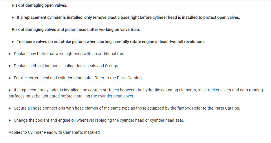

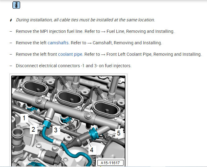

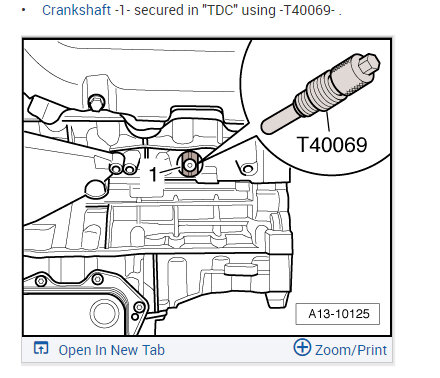

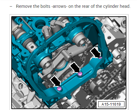

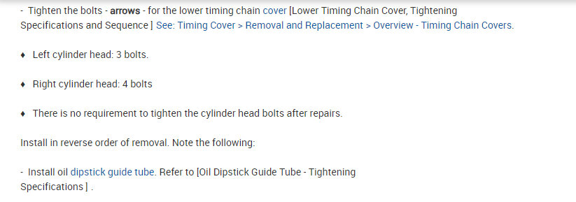

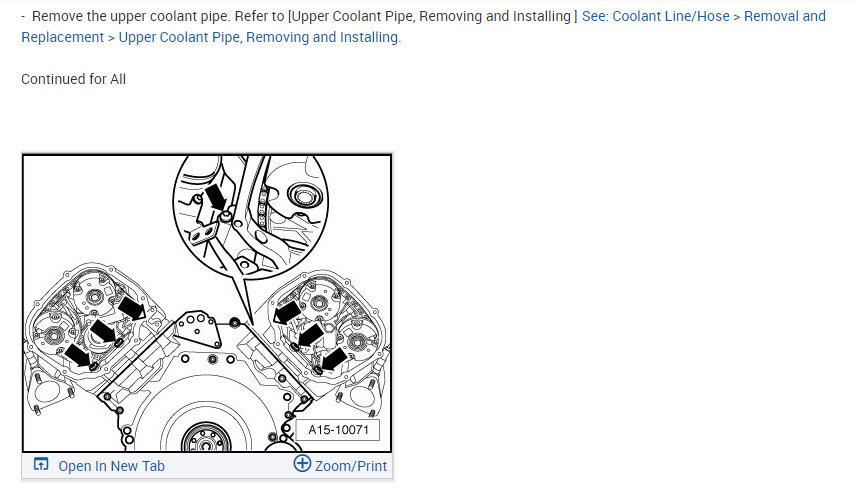

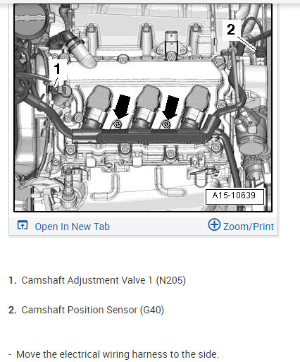

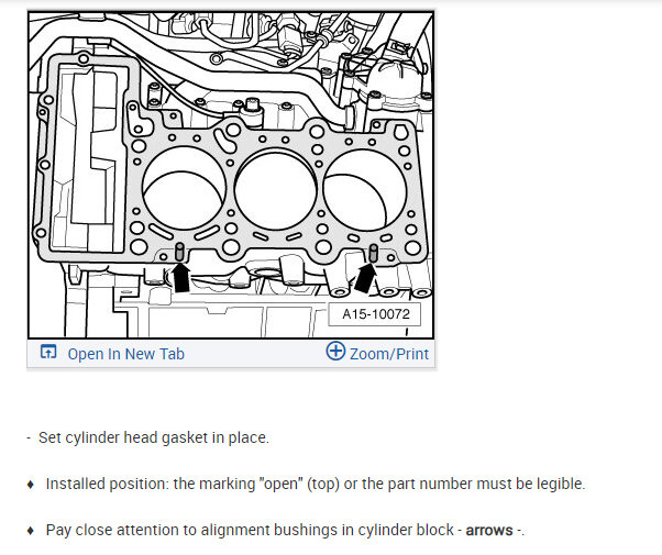

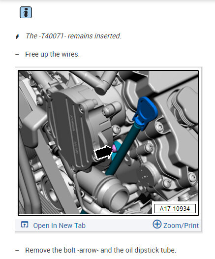

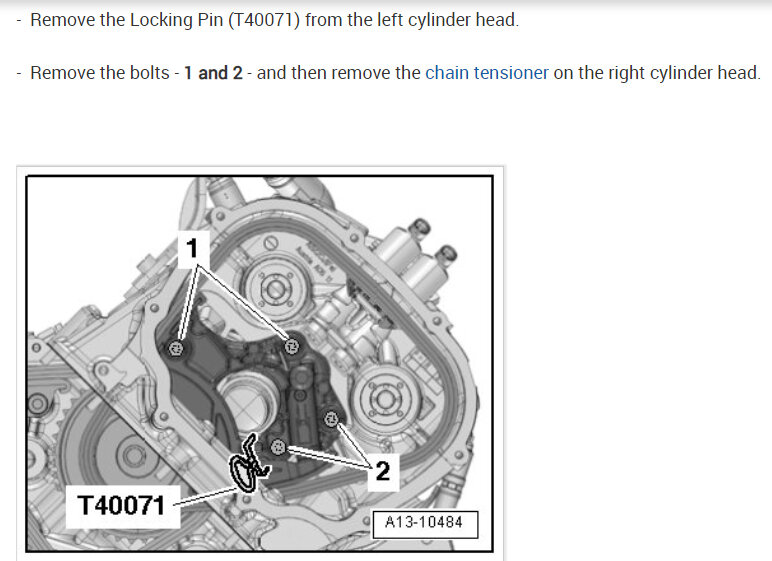

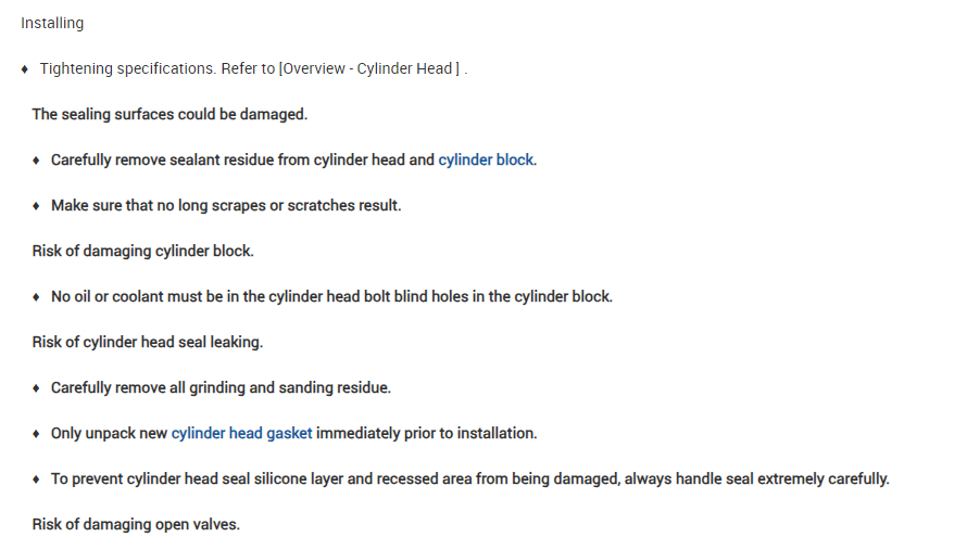

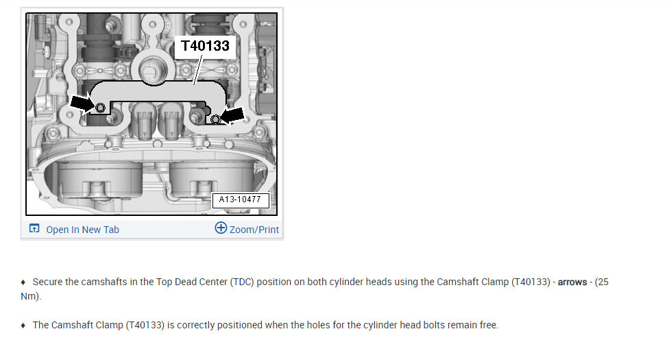

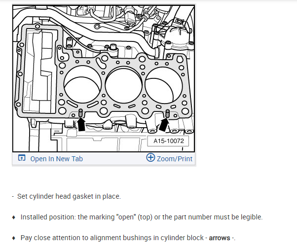

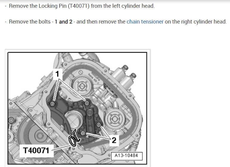

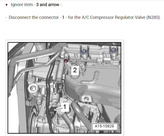

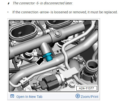

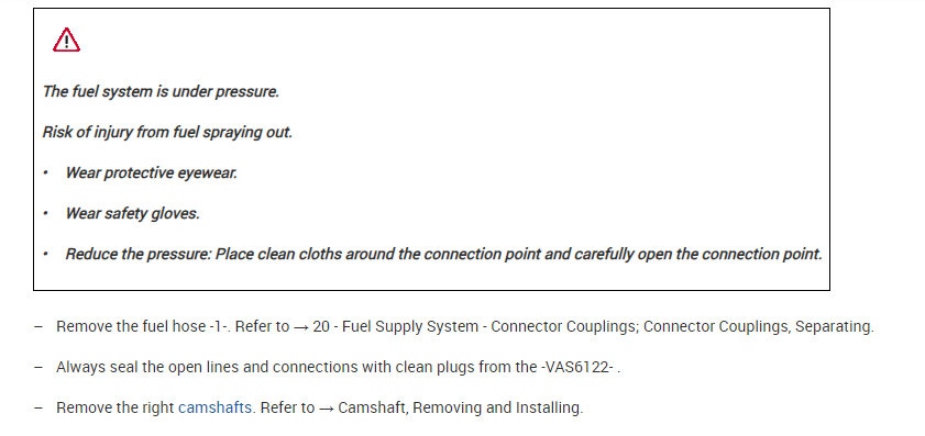

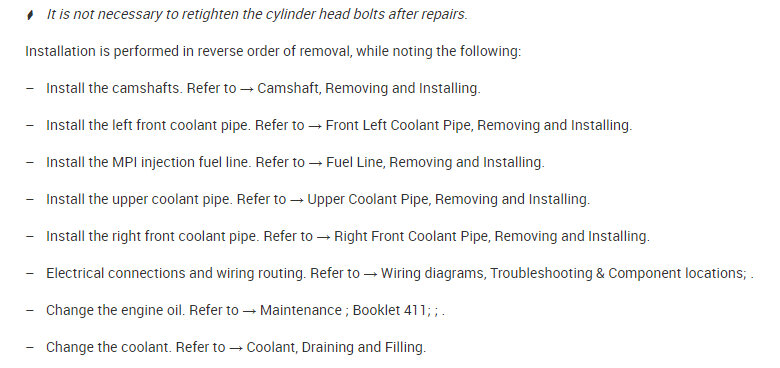

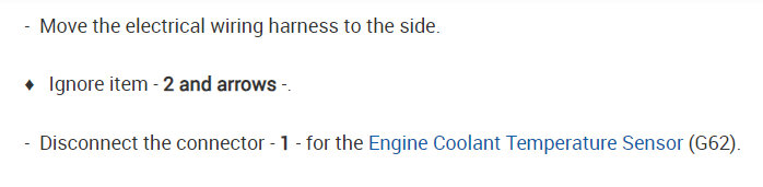

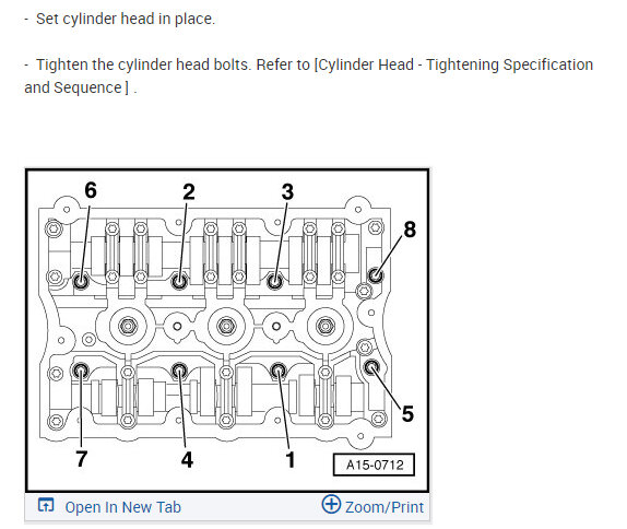

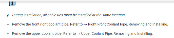

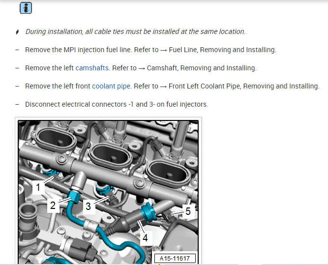

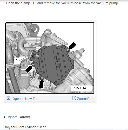

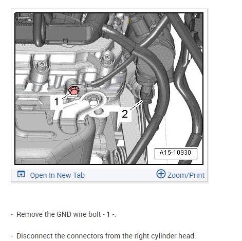

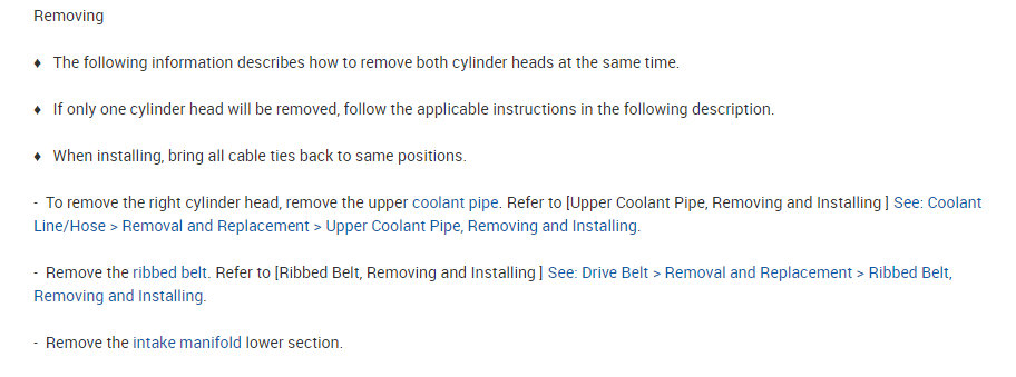

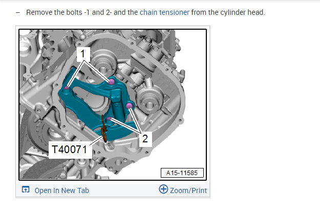

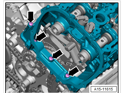

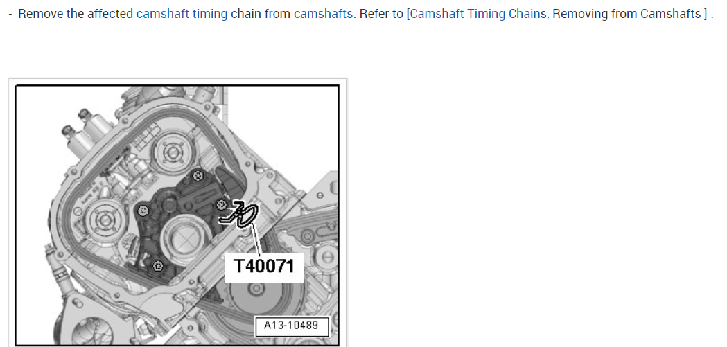

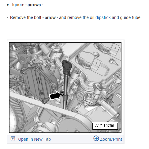

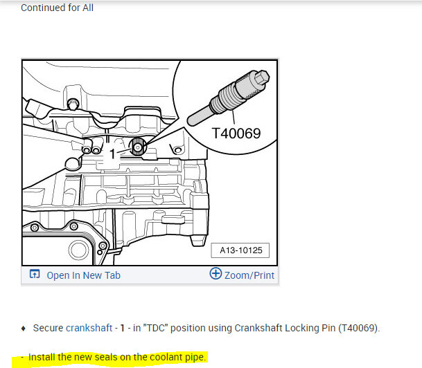

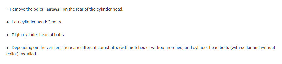

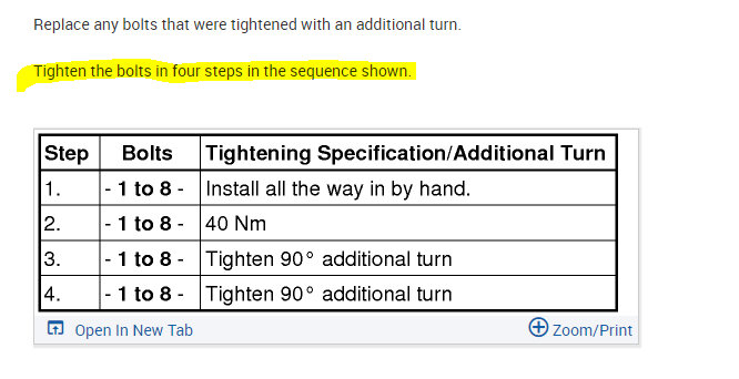

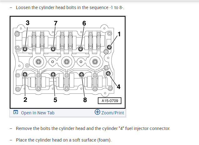

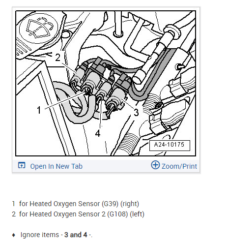

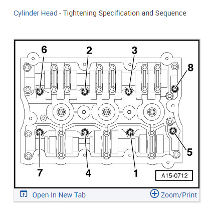

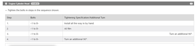

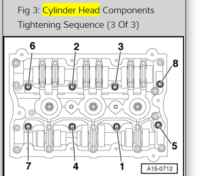

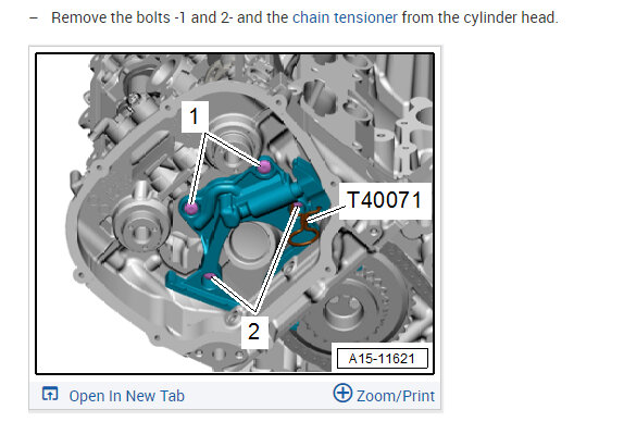

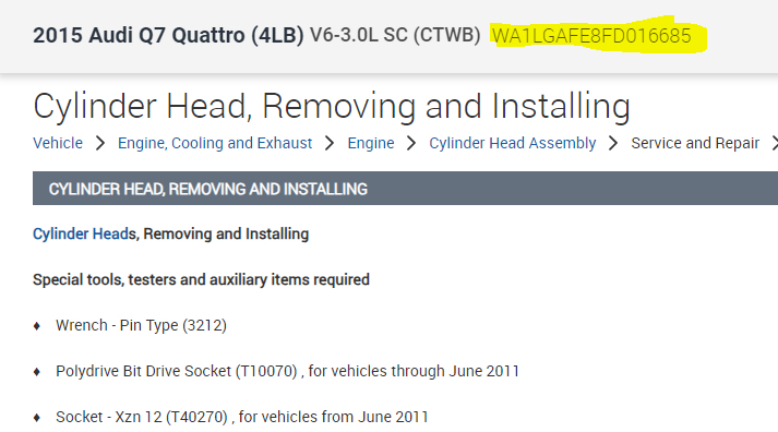

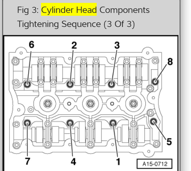

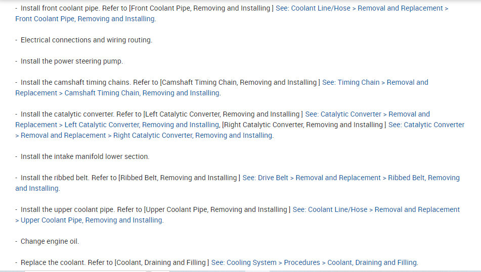

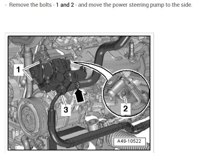

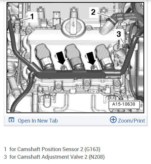

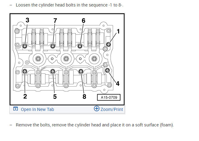

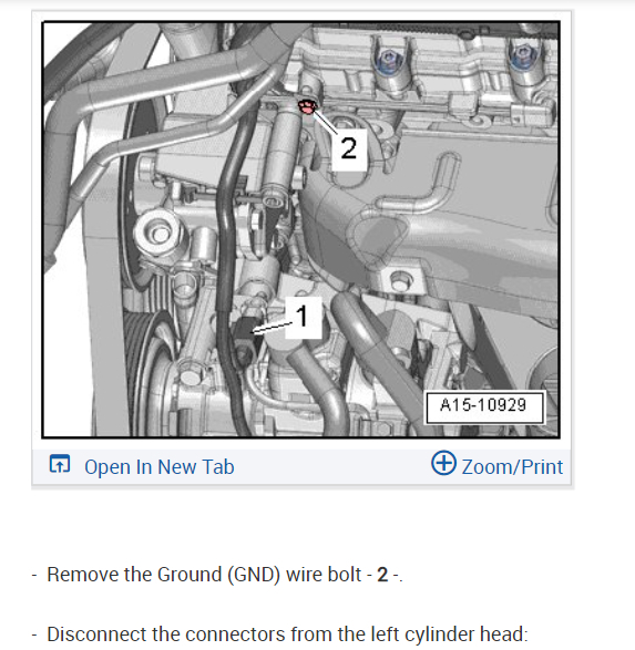

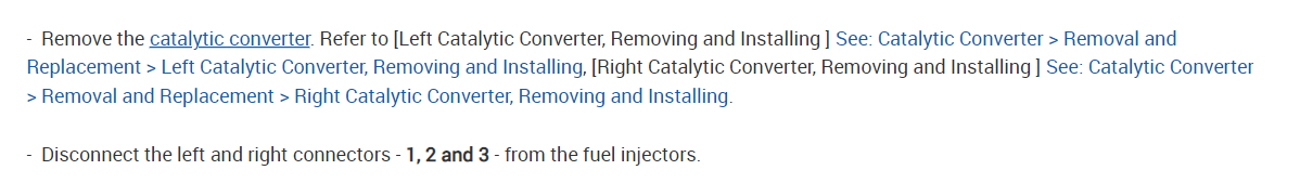

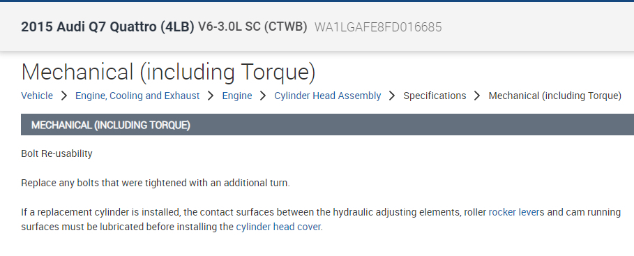

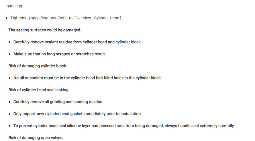

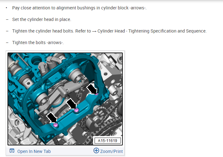

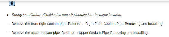

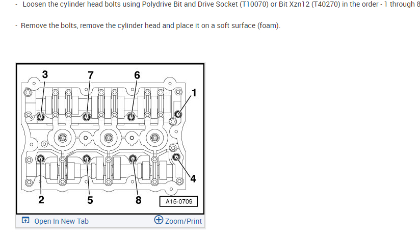

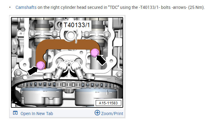

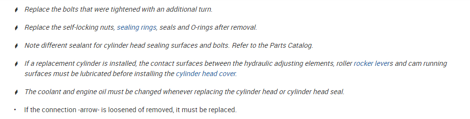

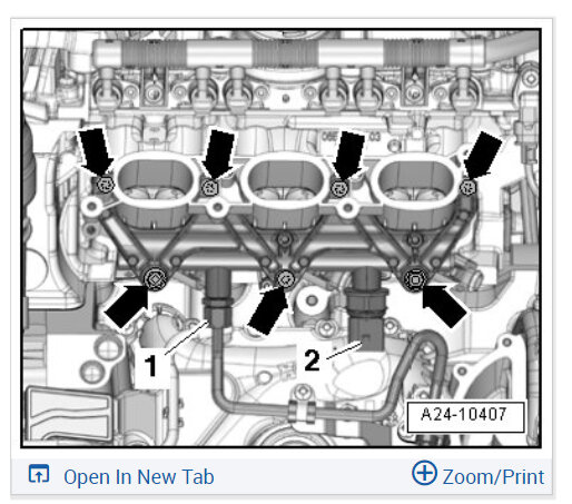

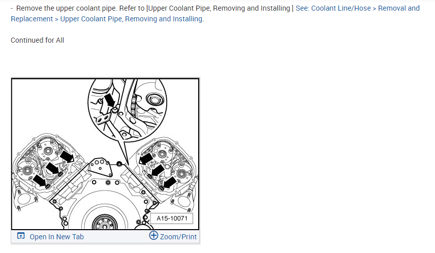

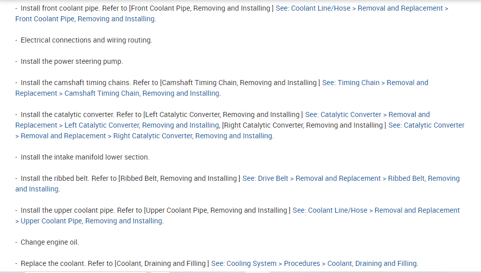

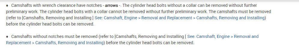

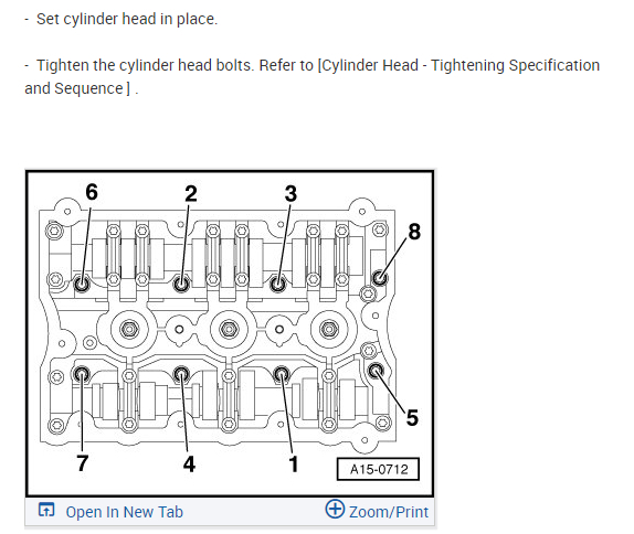

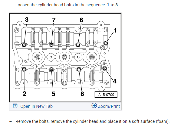

That isn't good news. Please note, this is a difficult procedure. It will require specialized tooling to retime the engine and camshafts.
Take your time and it is important to have the timing correct before turning the engine.
Take a look at the directions below. The directions are set up for removal of the cylinder heads and then install. The last two pics are the tightening sequence and torque specifications.
Let me know if this helps.
See pics below.
Mar 3, 2024 at 9:04 PM

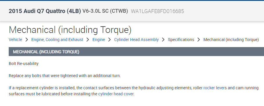

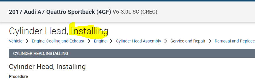

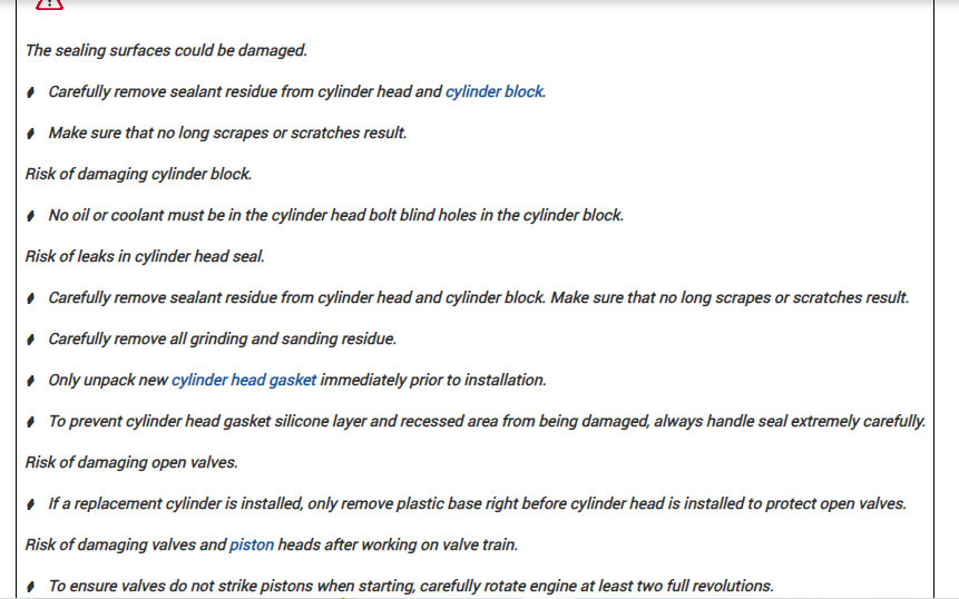

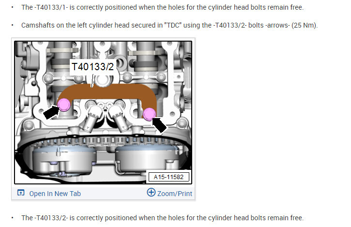

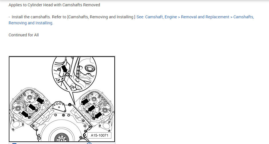

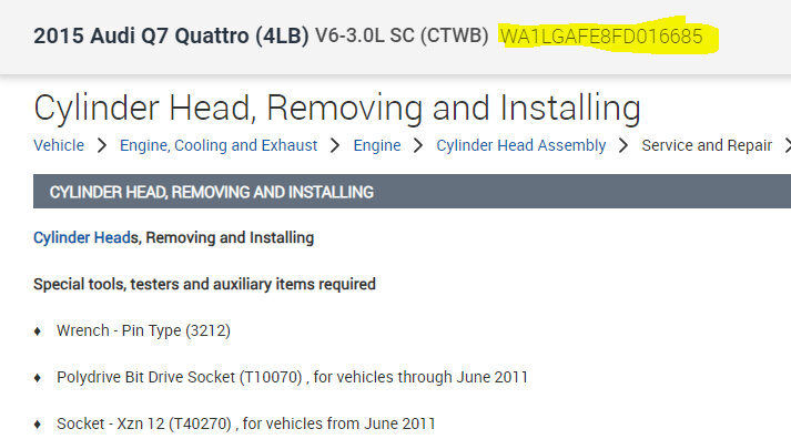

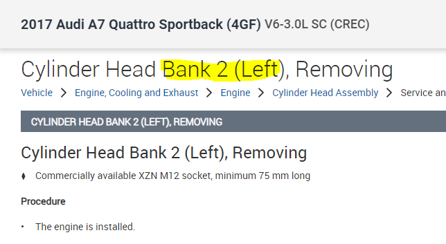

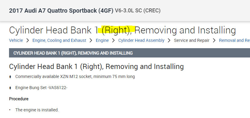

Does this manual apply for a 2015 AudiQ7 supercharged? Thank you.
Mar 4, 2024 at 12:01 AM

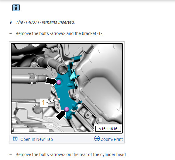

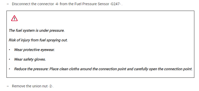

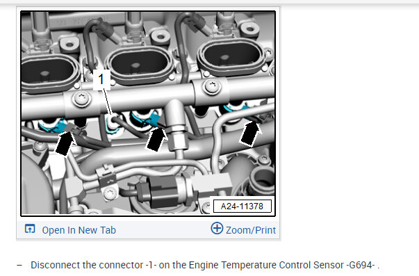

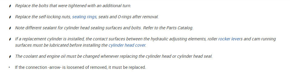

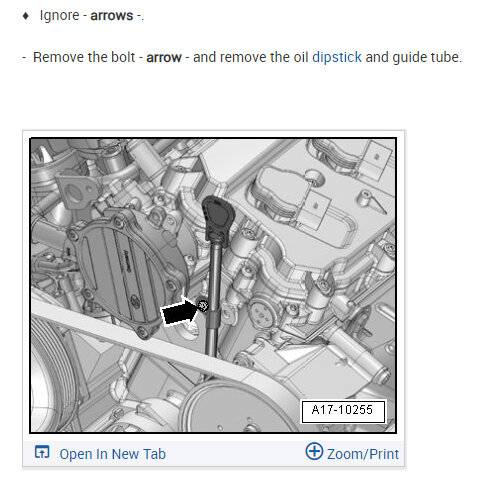

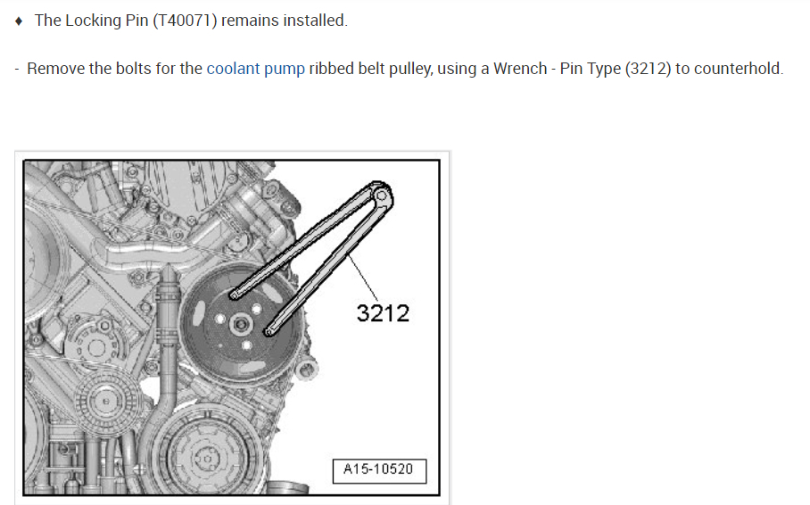

No. I looked at the heading where you indicated a 2017 A7. However, they will be similar. Sorry about that.

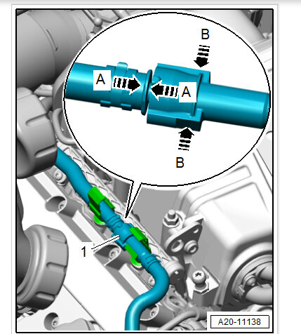

I attached the directions below based on the VIN. When you are putting things together, make sure to lubricate the coolant pipe o-rings with either coolant or a thin coating of oil. That will help prevent damage to them.
I hope this helps.
See pics below.
