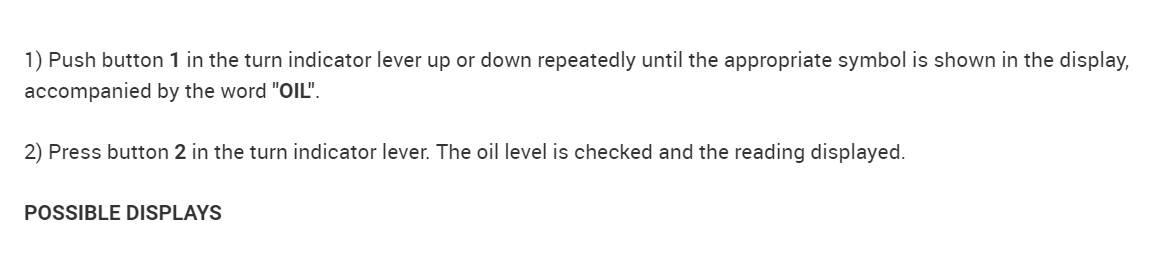

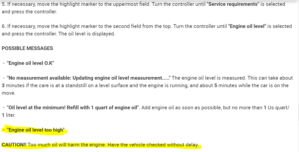

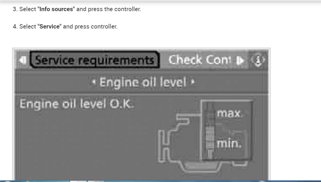

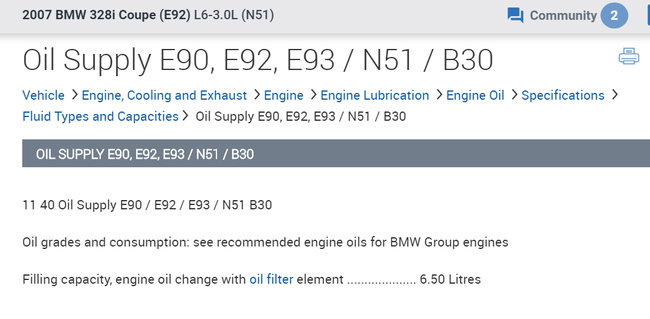

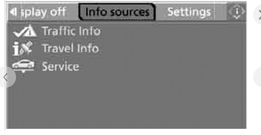

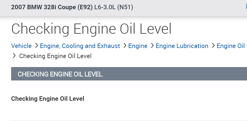

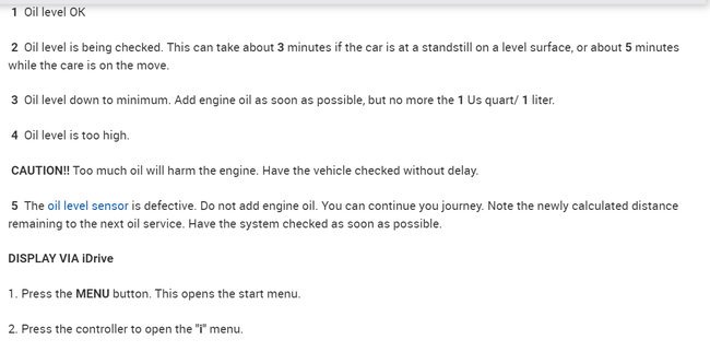

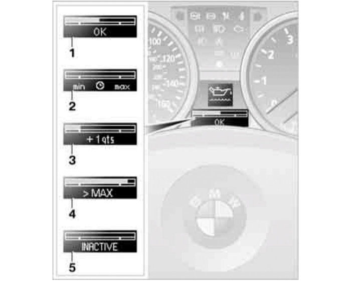

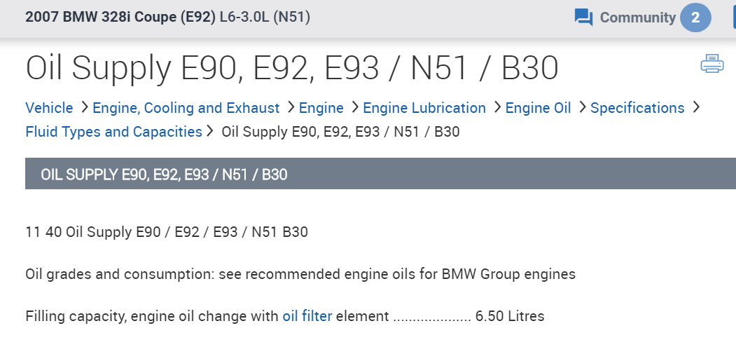

The oil sensor light came on saying 1 quart low I added one quart and the light is still on. I thought it may be lower than just one quart so I kept adding another quart one at a time to see if it would go away the light won't go away. I added four quarts in there and I still have a light. it drives better now with the extra oil. could It still below? I don't believe I overfilled it because I drove it about 20 to 25 miles and had no problems. do you think it's still low or I overfilled it? I don't think I overfilled it I think it might be still low of oil. please help, thank you.
