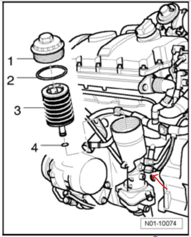

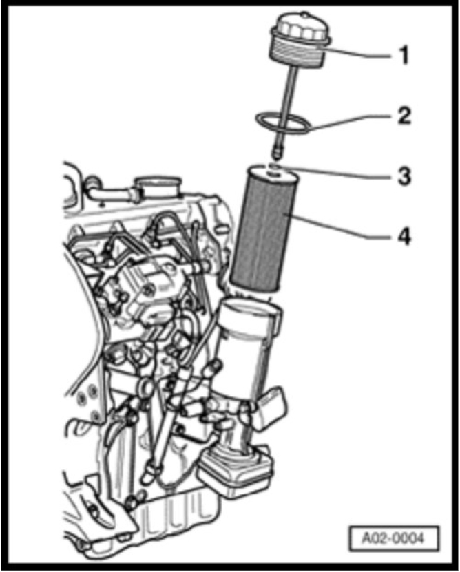

It sounds like the oil pressure sensor has gone out, here is the location so we can be on the same page. I know you just removed it but this way others can see the location that visit this post. Also, make sure the O ring seal for the filter is in correctly and that none of the old O ring seals are stuck inside the oil filter adapter.
Oil Pressure Switch (1.8L) On left side of engine, on oil filter flange.
Oil Pressure Switch (1.9L) On left side of engine, right side of oil filter flange.
Oil Pressure Switch (2.0L) Left side of engine, on left side of oil filter flange.
Check out the images (below). Let us know what you find.
