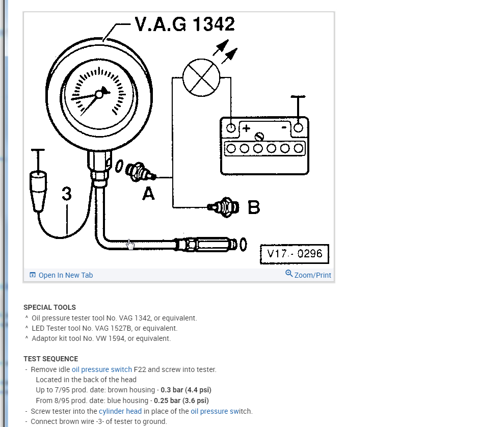

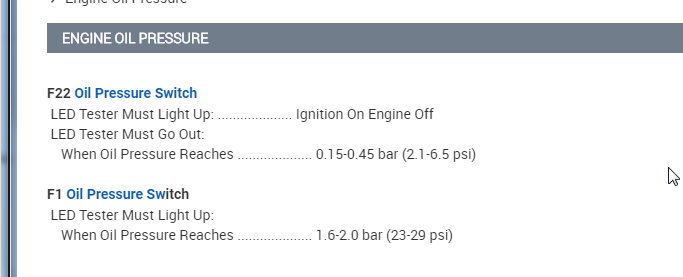

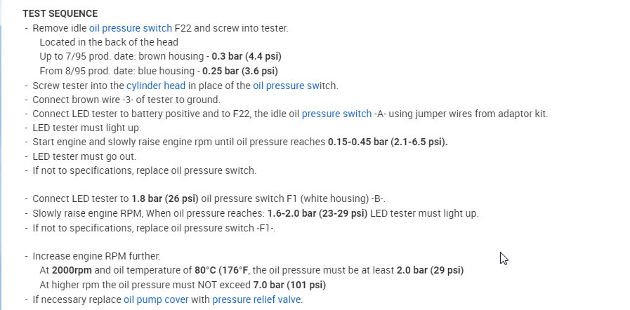

We need to start with checking the oil pressure with a mechanical gauge so that we can find out if this is truly low pressure or a sensor/gauge issue. Here is a guide:
https://www.2carpros.com/articles/high-or-low-engine-oil-pressure
I attached the process from the manual so let's check the pressure and go from there. If this is low oil pressure then we may need to go into the engine to solve it so we need to make sure. Thanks
