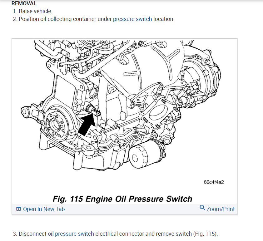

You need to have a manual oil pressure test done to verify that you have low oil pressure. The sensors sound like they are working.

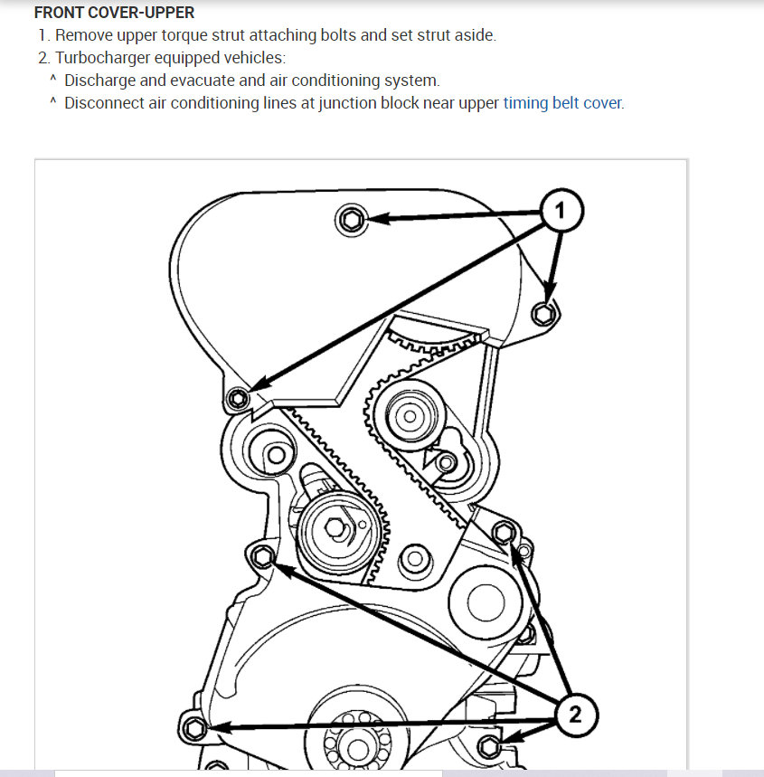

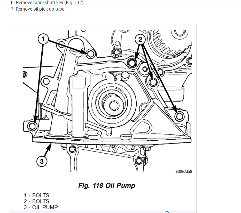

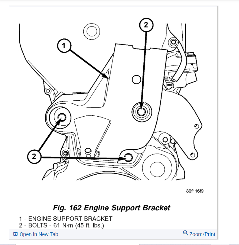

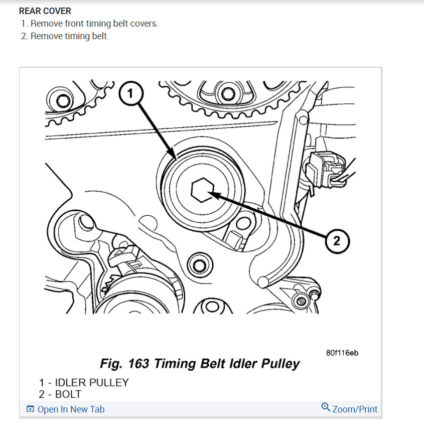

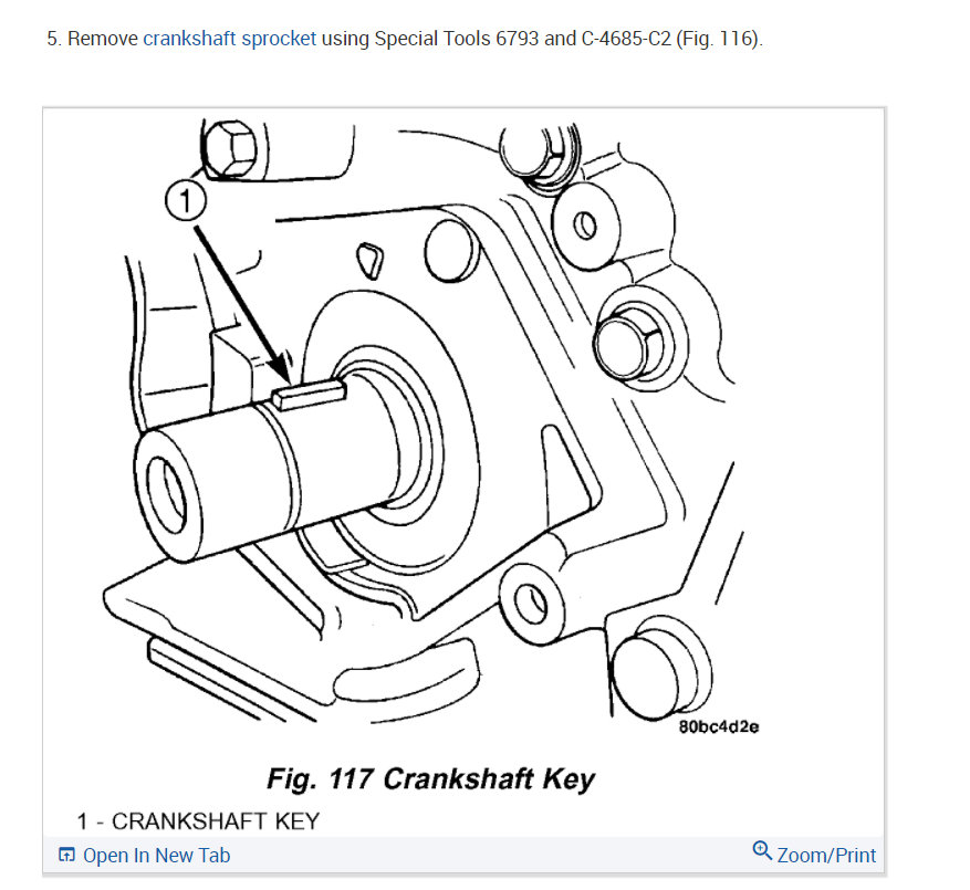

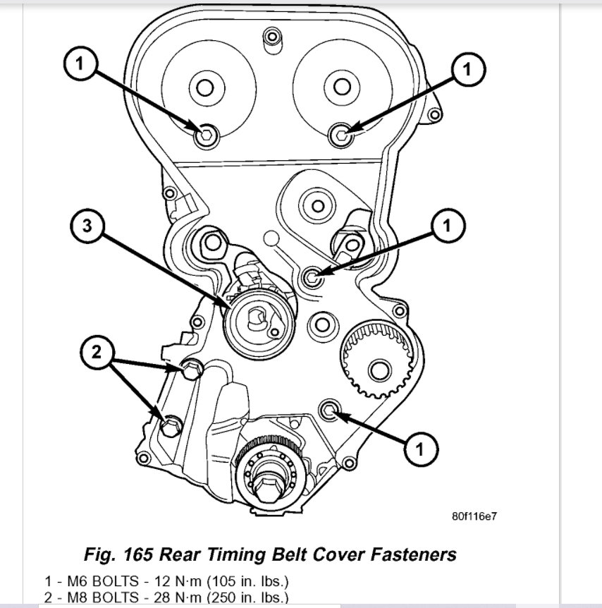

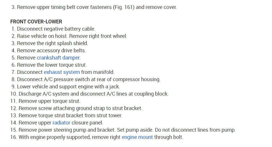

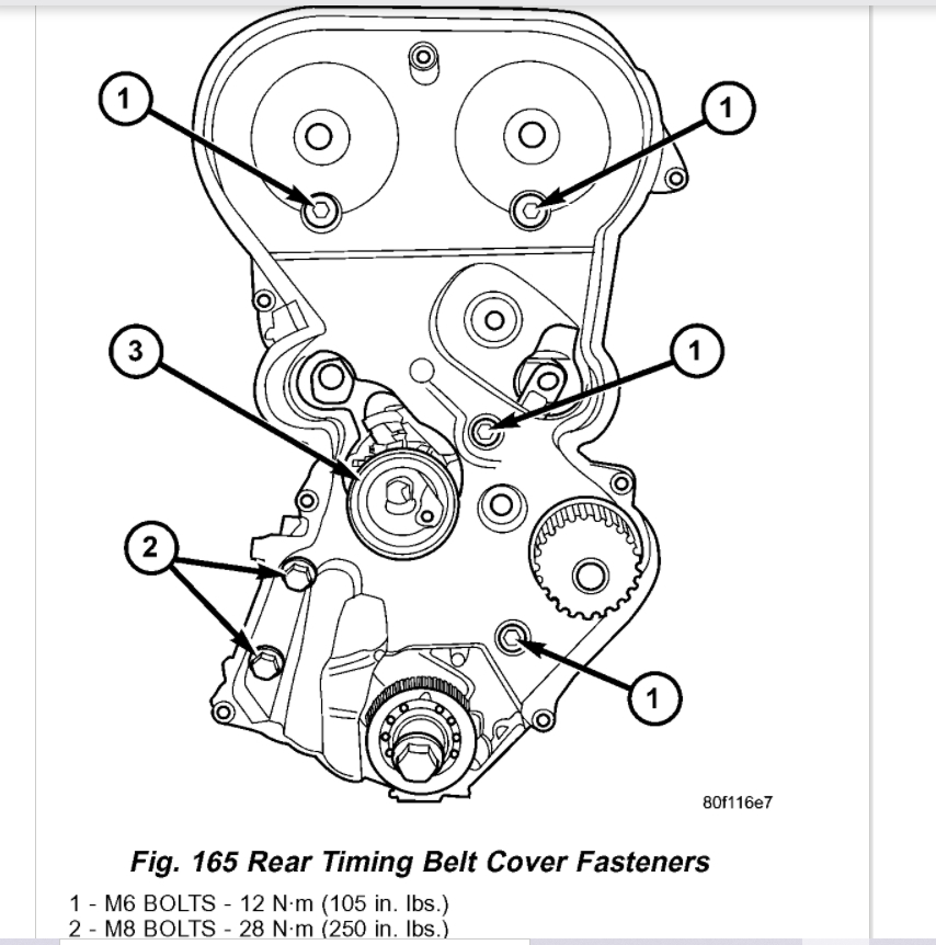

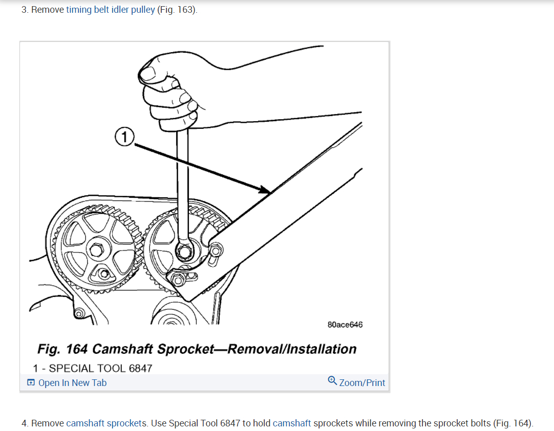

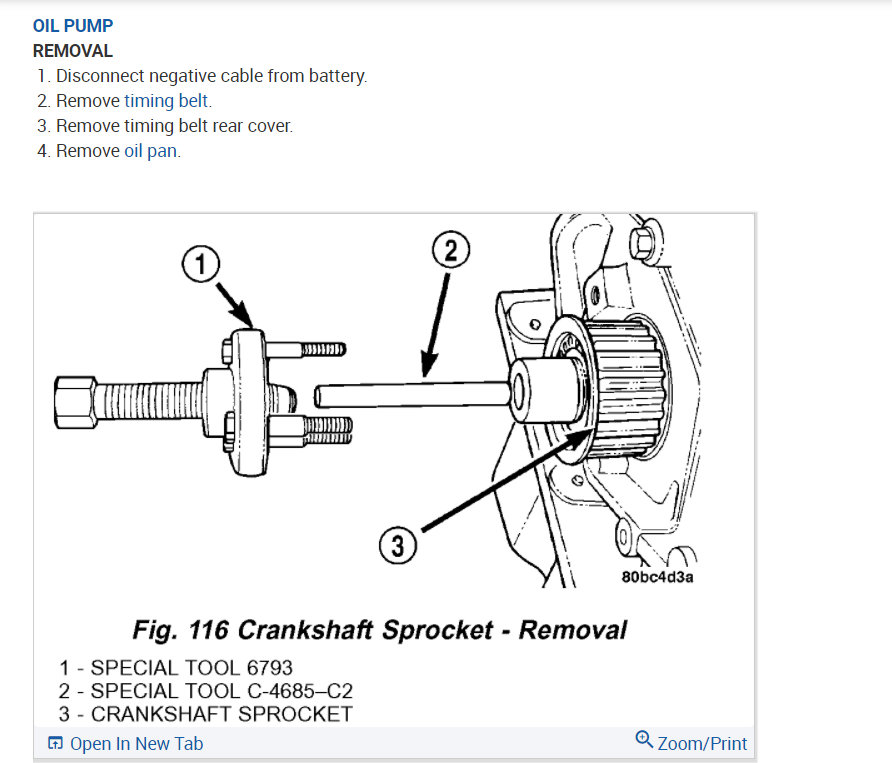

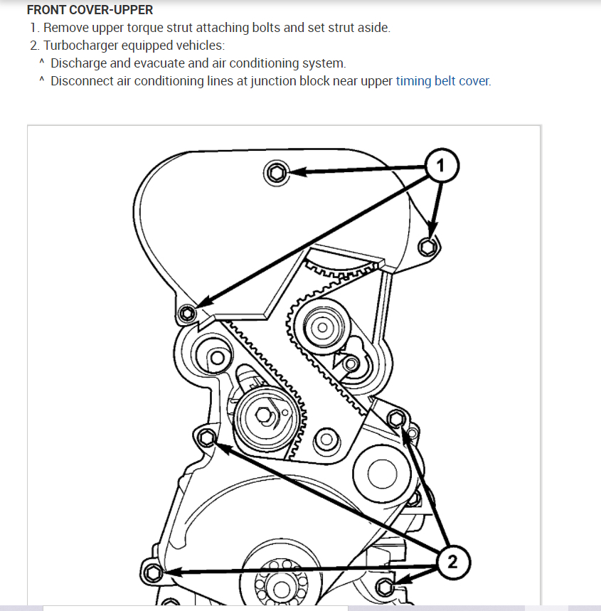

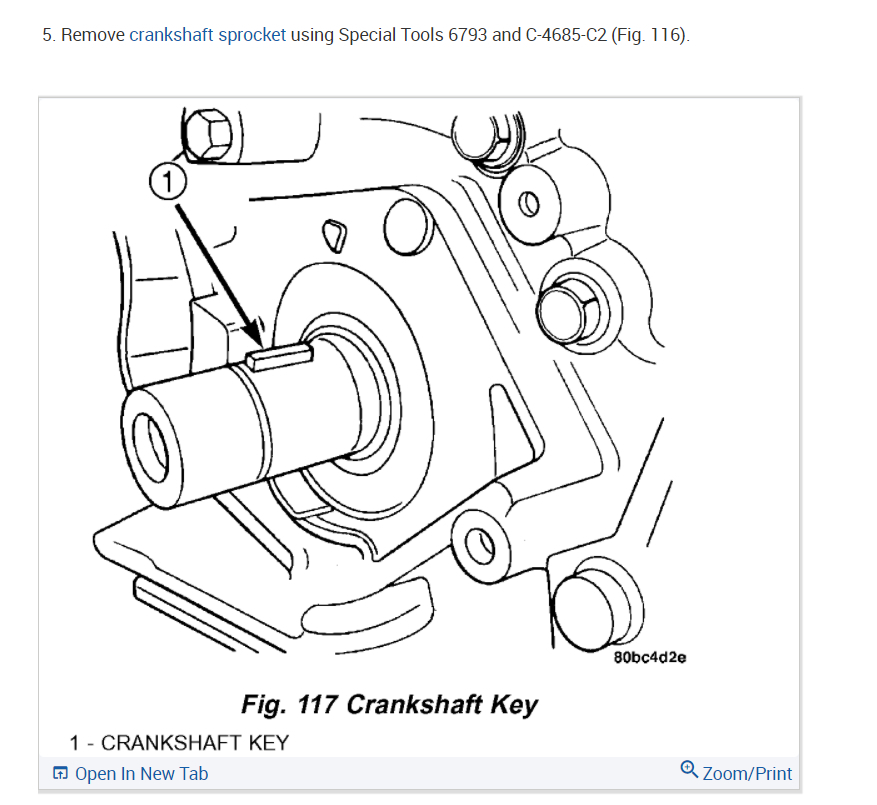

This could be the oil pump itself failing. I attached the procedure for replacing the oil pump below. It is very involved as the front of the motor has to be stripped down of all components.
