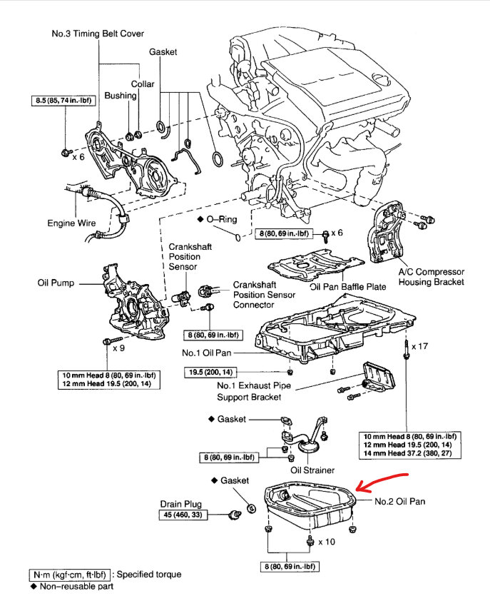

So this happens when the oil pump pick up gets clogged up with gunk. I would remove the oil pan sump and clean it out; here is how in the images below. Check out the images (below). Please let us know what happens.

What do you think about trying Seafoam first to see if light will stay off for a temporary fix and then drop oil pan later. Middle of a heat wave right now? Thanks.
Jul 19, 2025 at 8:21 AM
Sure, you can give it a shot, I have had good luck with seafoam. Let me know how it goes.
