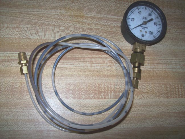

If it were constant (light or low gauge) reading low, I might substitute the "sender" for the connection of my mechanical gauge and get a true reading (not electrical) of what the oil pressure is actually doing. This takes a little time and maybe a bit more effort, especially if you have to get a mechanical gauge. This is the best way to verify your pressure.
Picture of my "thrown together" gauge at bottom (picture one).

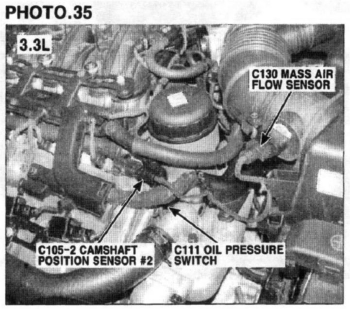

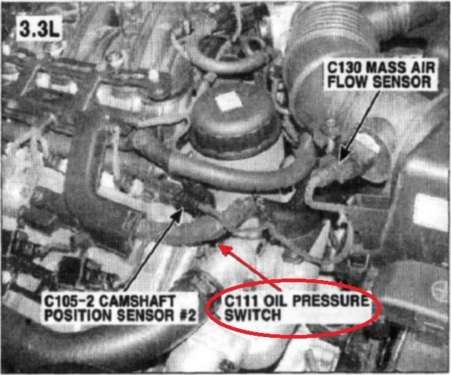

Yours looks to be easy to access. See my second picture at the bottom (screenshot of your vehicle from "All Data") I highlighted in red.
