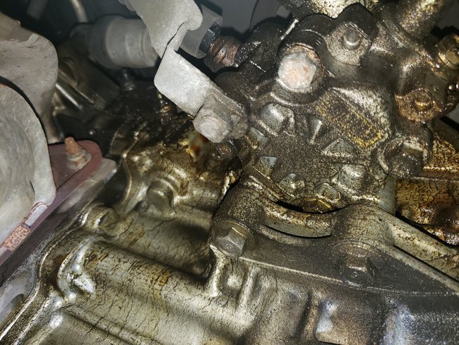

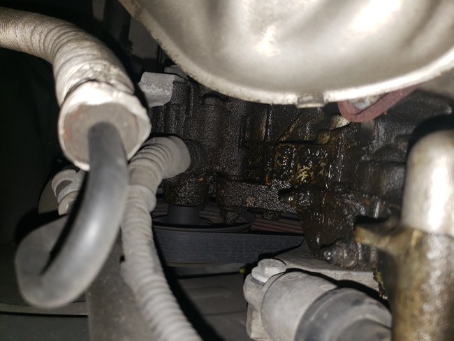

The way it is being thrown around, I doubt it.

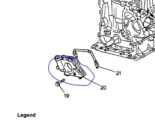

It look like the front seal behind the harmonic balancer.
To be sure, I would go to a self serve car wash and clean off the motor and then watch it over time to be sure it is coming from there.
With all that mess, how do you know it is not the valve cover?

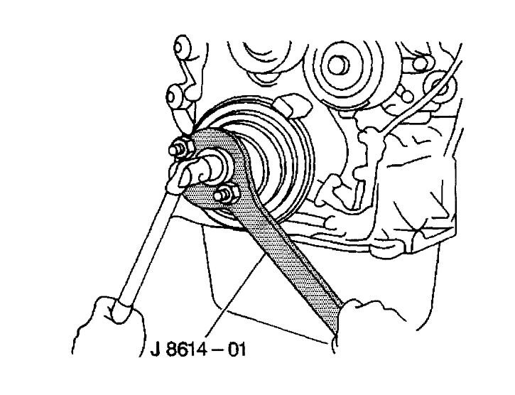

Tools Required
J 8614-01 Pinion Flange Holder
Removal Procedure
Caution: Refer to Battery Disconnect Caution in Service Precautions.
1. Disconnect the negative battery cable.
2. Remove the accessory drive belt.
3. Raise and suitably support the vehicle. Refer to Vehicle Lifting.
4. Remove the right splash shield.
5. Remove the crankshaft pulley retaining bolt using J 8614-01 to prevent crankshaft rotation when loosening the bolt.
