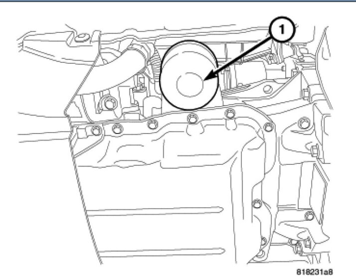

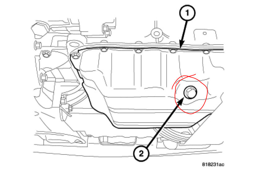

Not knowing the model year, here is what I would suggest. Note the pics are for a 2008.
First, confirm the oil drain plug under the engine and on the oil pan is tight and not leaking. If that appears good, check the oil filter to make sure it's tight. If it is, wipe it off clean. Make sure there is oil in the engine, start the engine for a couple of seconds, and turn it off. Check around the oil filter again to see if there is new oil on it.
See pics below for 2008 filter and drain plug locations.

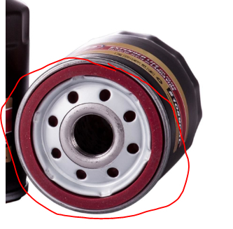

If the leak only happens when the engine is running, the oil is likely under pressure. What can happen is this. On the oil filter where it attaches to the engine is a large rubber O-ring. If you look at the pic below, I circled it. In the picture the o-ring is red. In most cases, they are black.
When removing the old oil filter, that o-ring can stick to the engine and the person doing the work doesn't realize it. When they install the new filter, it already has the new o-ring on it. As a result, you have two o-rings rather than one. This always leads to a large leak when the engine is running. I have a feeling that is what happened. The only way to confirm is to remove the oil filter.
If you can do that, let me know. Also, if there is any way you can get a pic of the opening in the rear of the engine that appears to have something missing, please upload it for me to see.
