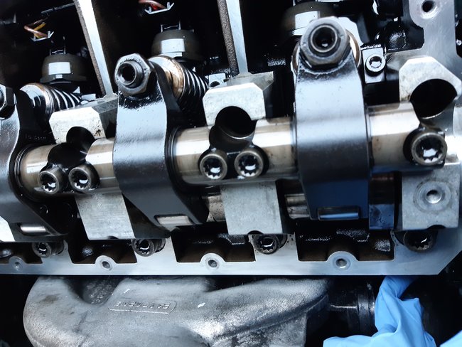

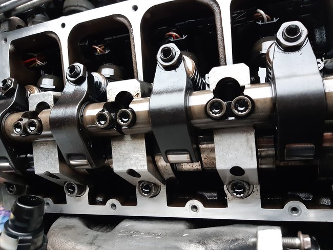

Can you get some pictures of where the leak is coming from? Clearly if the valve cover is leaking then either the valve cover is bent and not sealing or it was not tightened to spec allowing the cover to continue to leak.
So let's start with some pictures but we most likely will need to remove the cover again and ensure it is not bent. Thanks

I've recently cleaned all this down.
Image (Click to enlarge)
