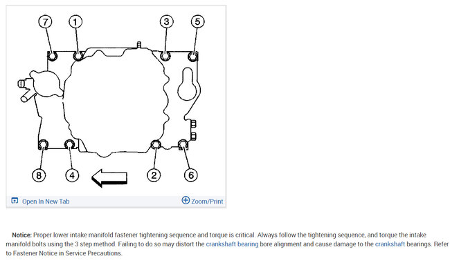

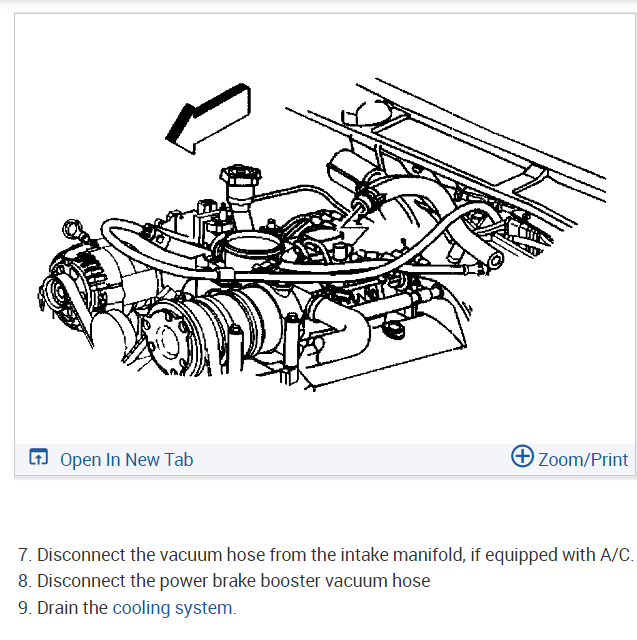

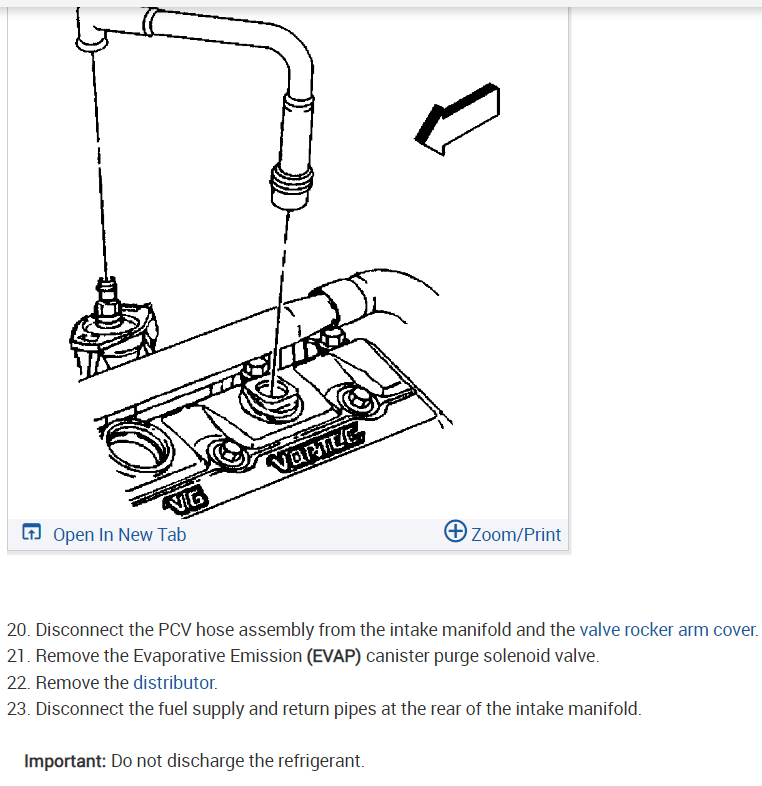

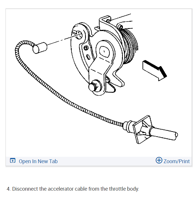

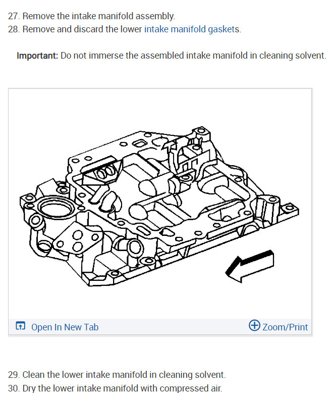

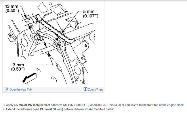

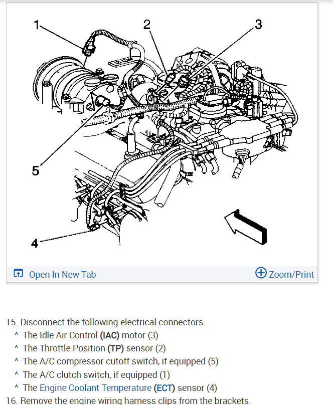

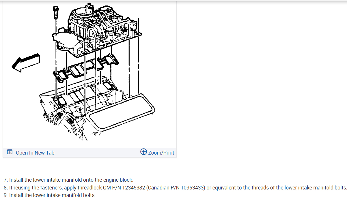

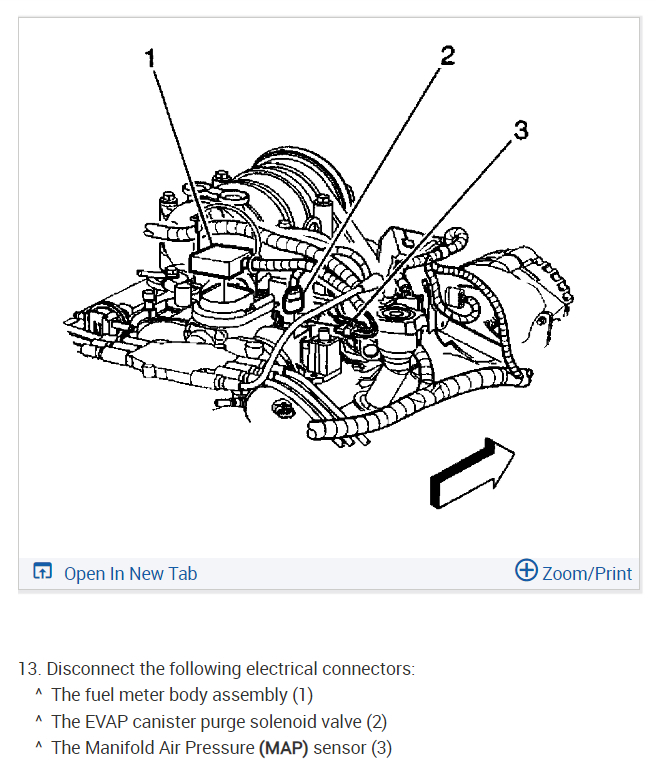

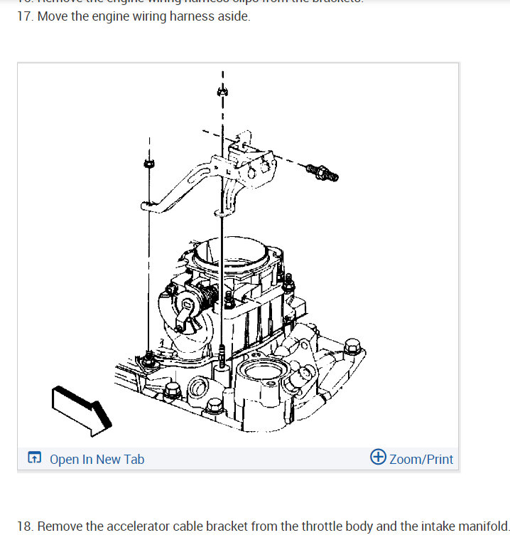

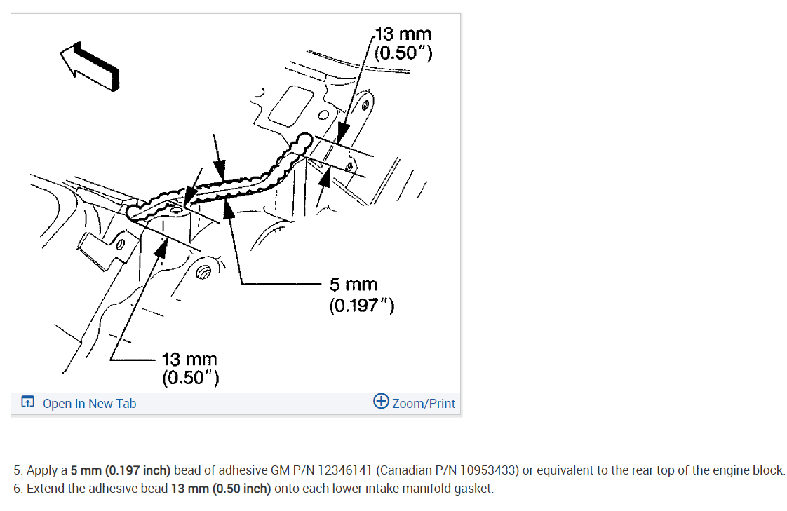

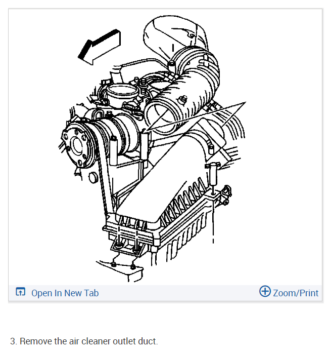

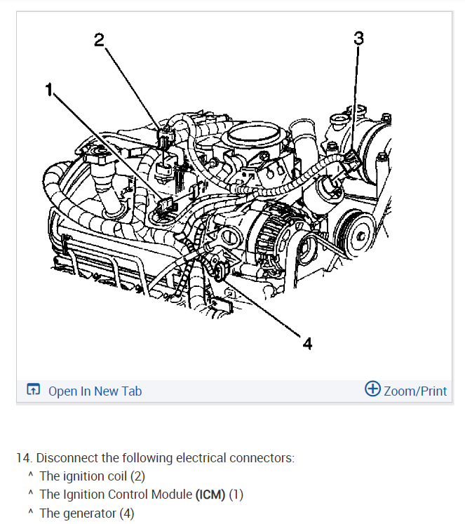

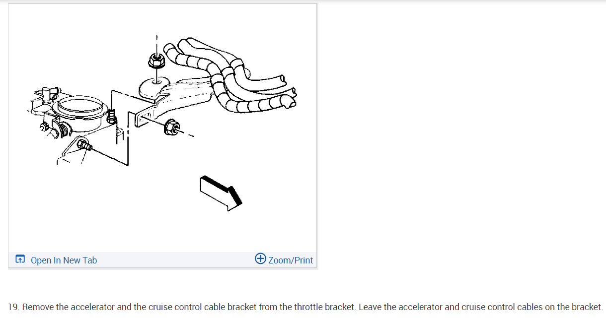

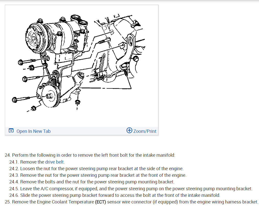

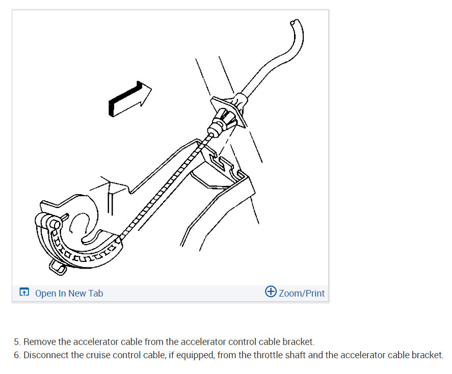

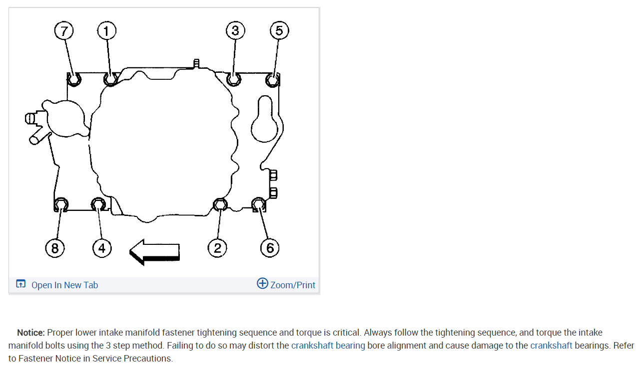

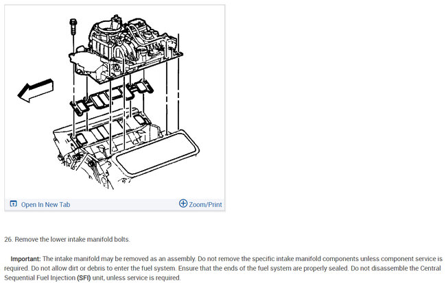

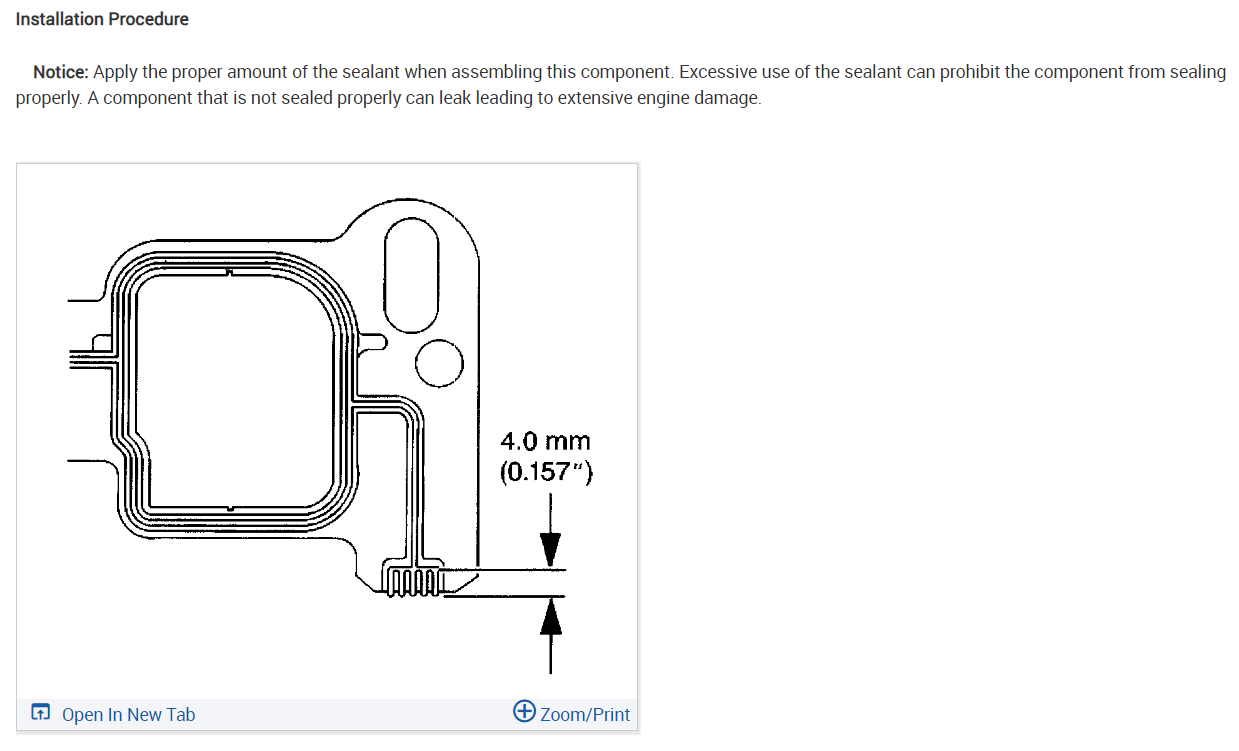

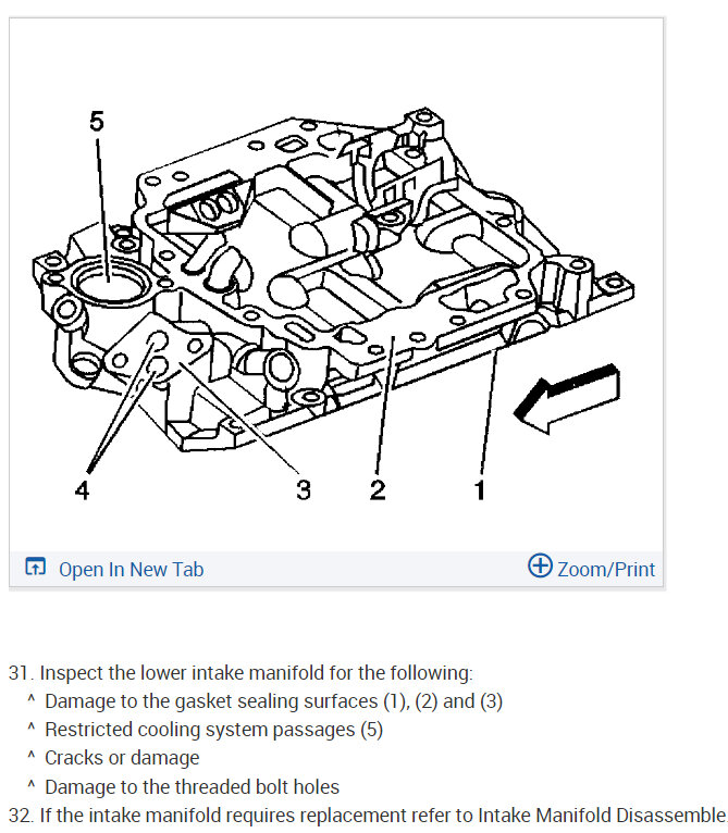

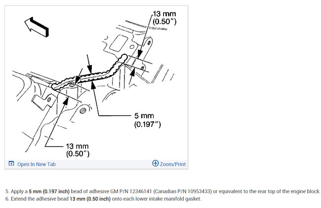

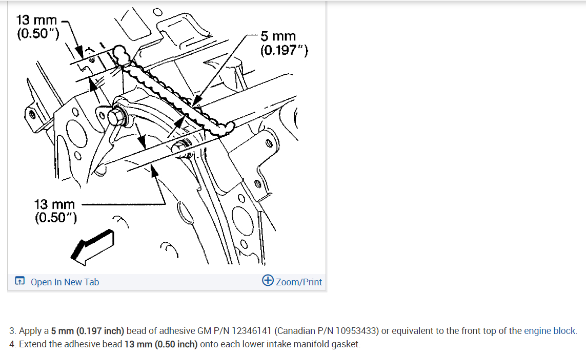

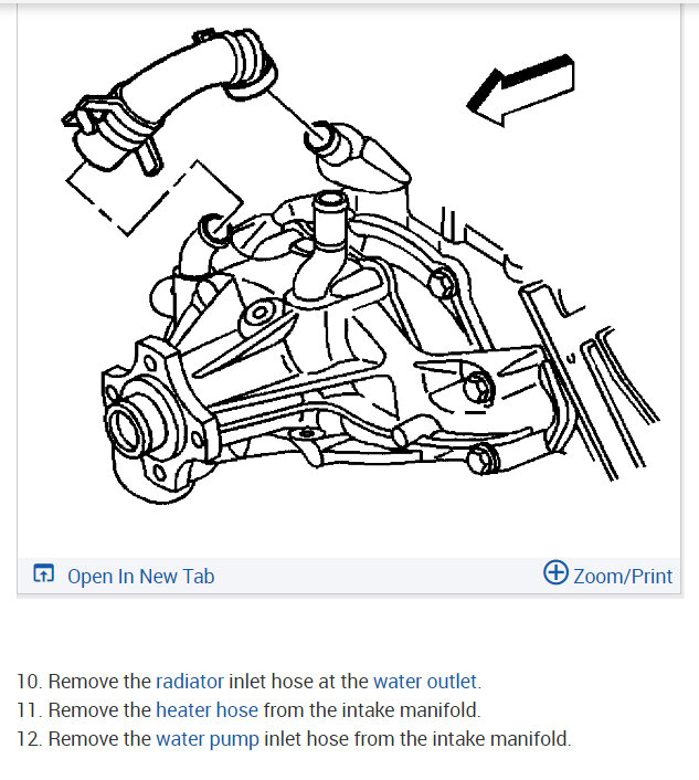

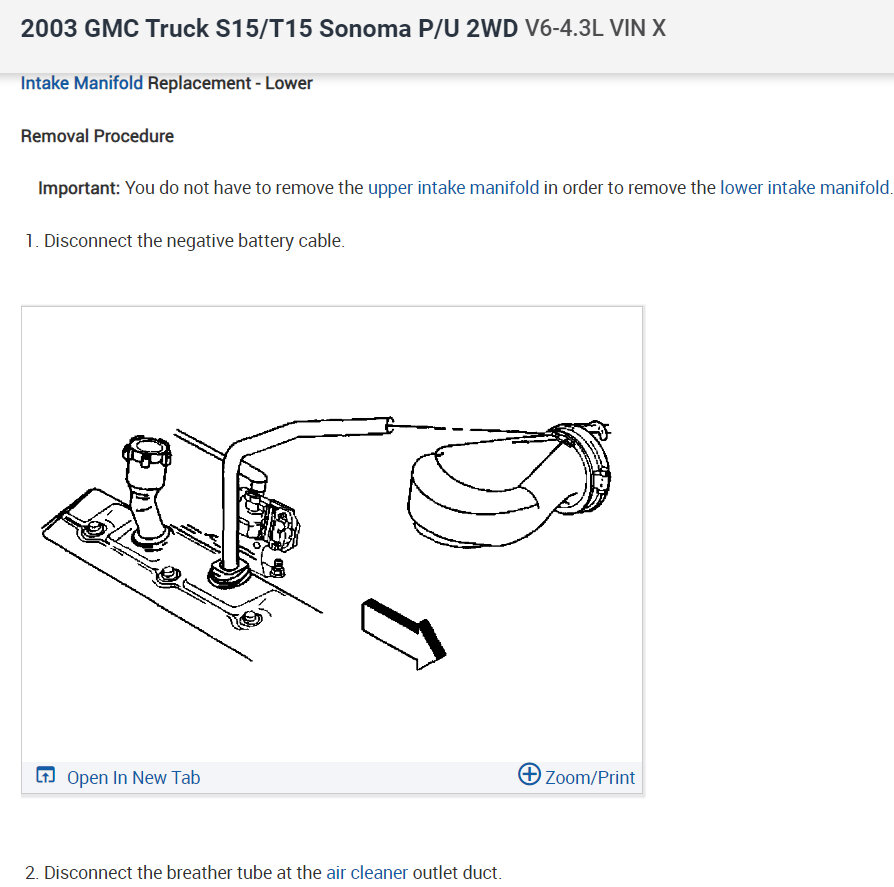

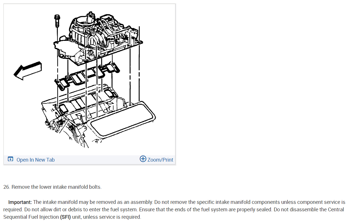

Please upload pictures or videos in your response to the problem so we can see what's going on. Here are the instructions on how to replace the intake manifold gaskets. Check out the images (below).
