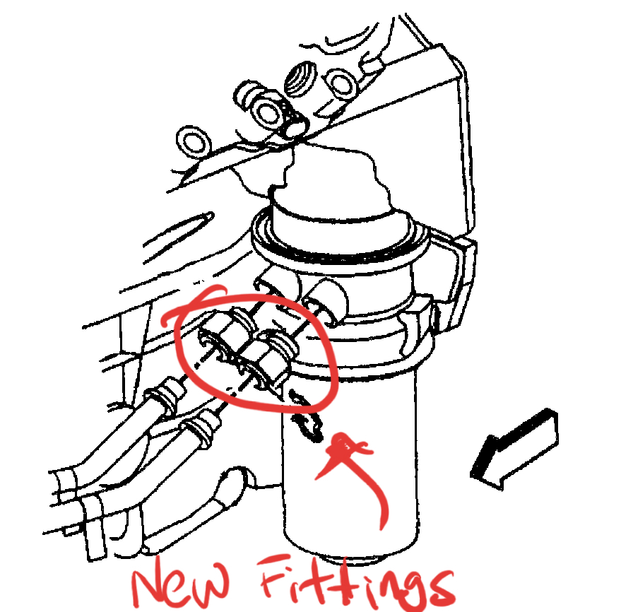

I have been trying to find o-rings that go inside where the lines push in but can"t find anything online that resembles that. are there replacement o-rings for that?

Hello and thank you for using 2CarPros. The diagram I have shows fittings you would actually need to replace at the oil filter housing. The seals are inside and are not sold separate. The fittings can actually be bought at any parts store.
Hope the diagram helps and if you need any more information don't hesitate to ask.
