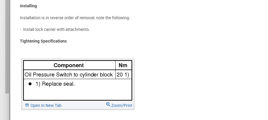

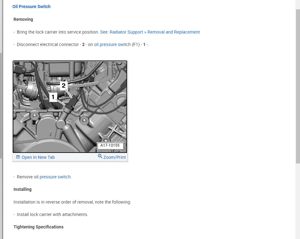

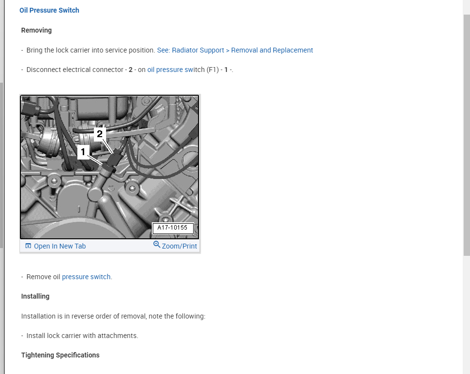

I am attaching the info below on the switch so we need to start with this, but I think seeing it will help.
If we can't then we are going to need to put dye in the oil and then clean it off to see where it is coming from.
