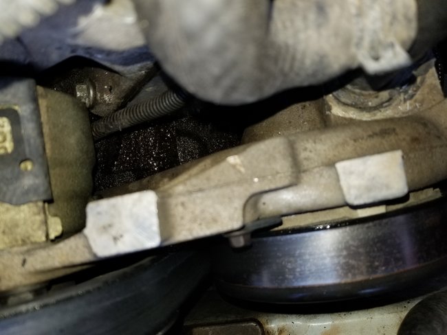

photo.

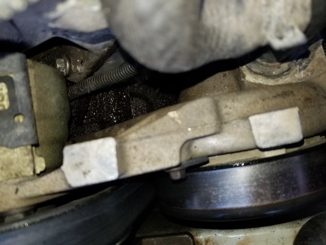

another photo.

Get some engine degreaser and spray it all around there. They have got instructions on the can, just make sure not to spray any electrical connectors. Then see if it comes back. To me that looks like just years of gunk and grime building up. It could be a leak of some sort, but I am not sold on it being a leak. Do go ahead and check all of your fluids, so if one is leaking you will know for sure.
If it is engine oil, it is probably from old dried out valve cover gaskets. A common issue on these cars. That is a common issue on all cars. It would be a slow leak, that runs down the front and/or side(s) of the engine.

If the gaskets have already been replaced, then that is probably just old crud that was not cleaned up. Still a good idea to degrease it and see if there is a leak there. If there is a valve cover gasket leak, it would probably just mean that the bolts need re-tightening.

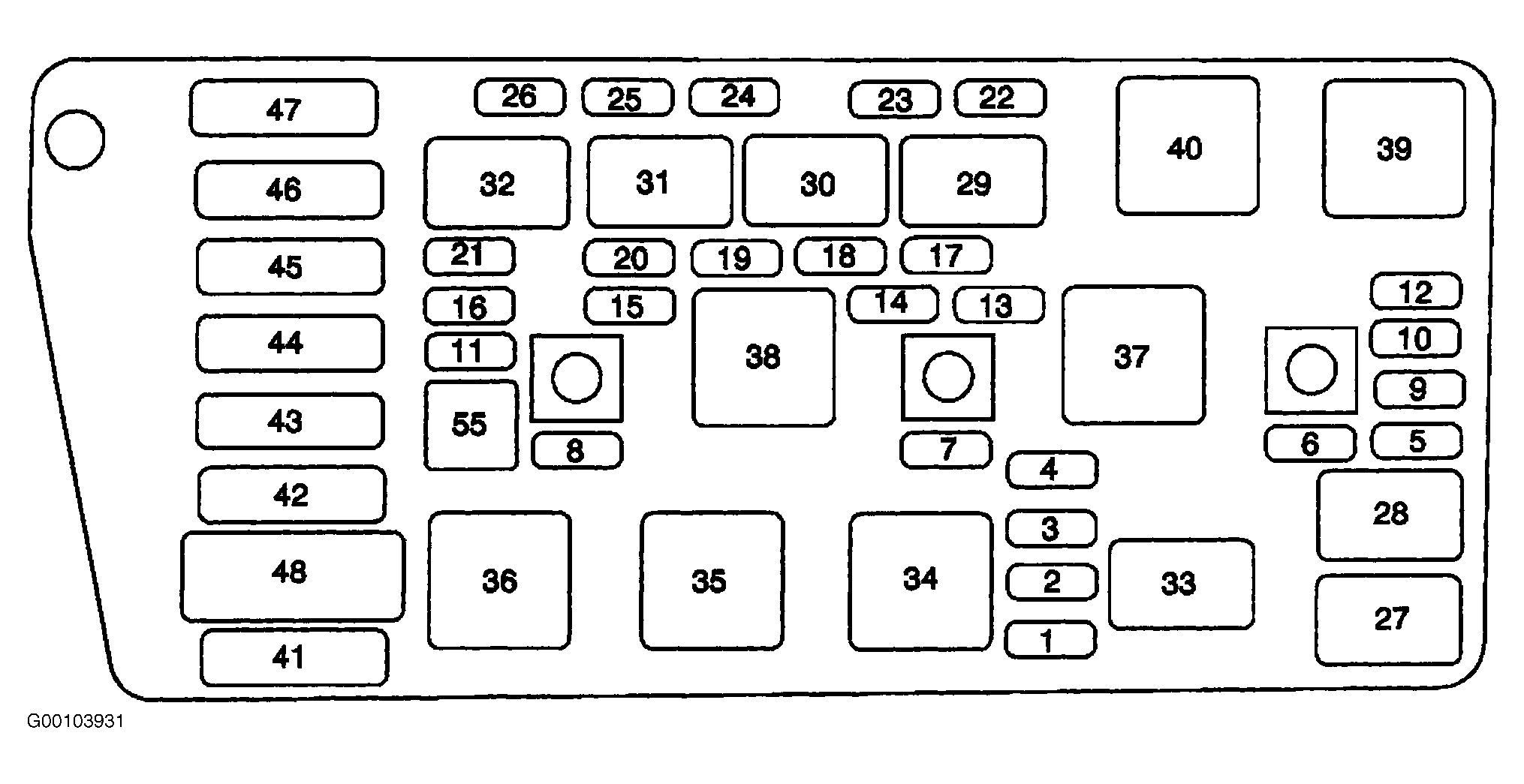

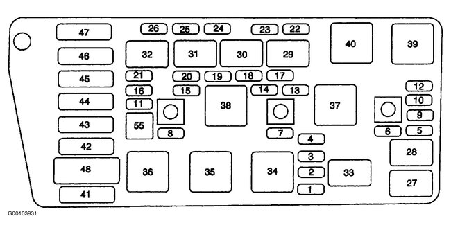

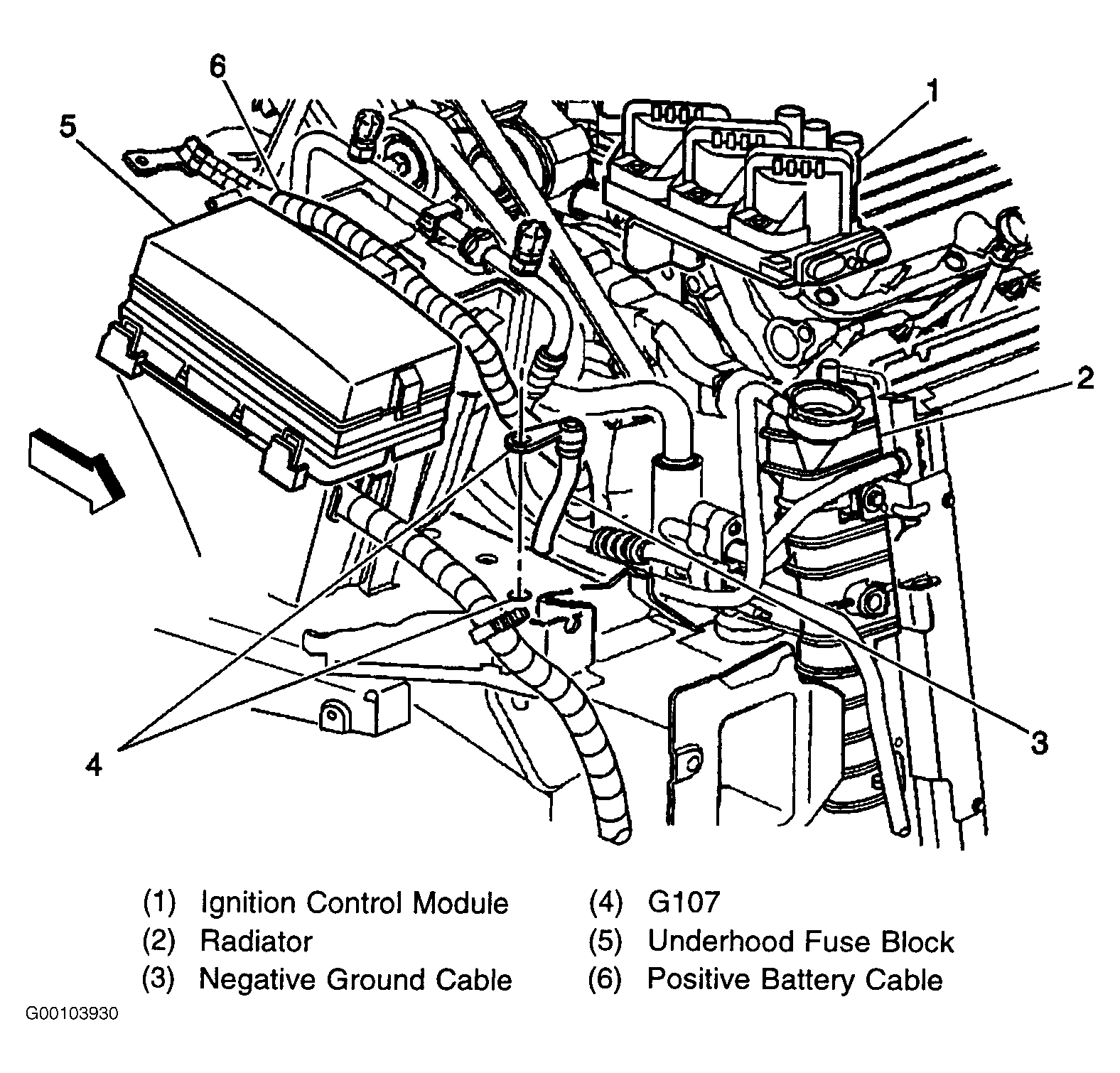

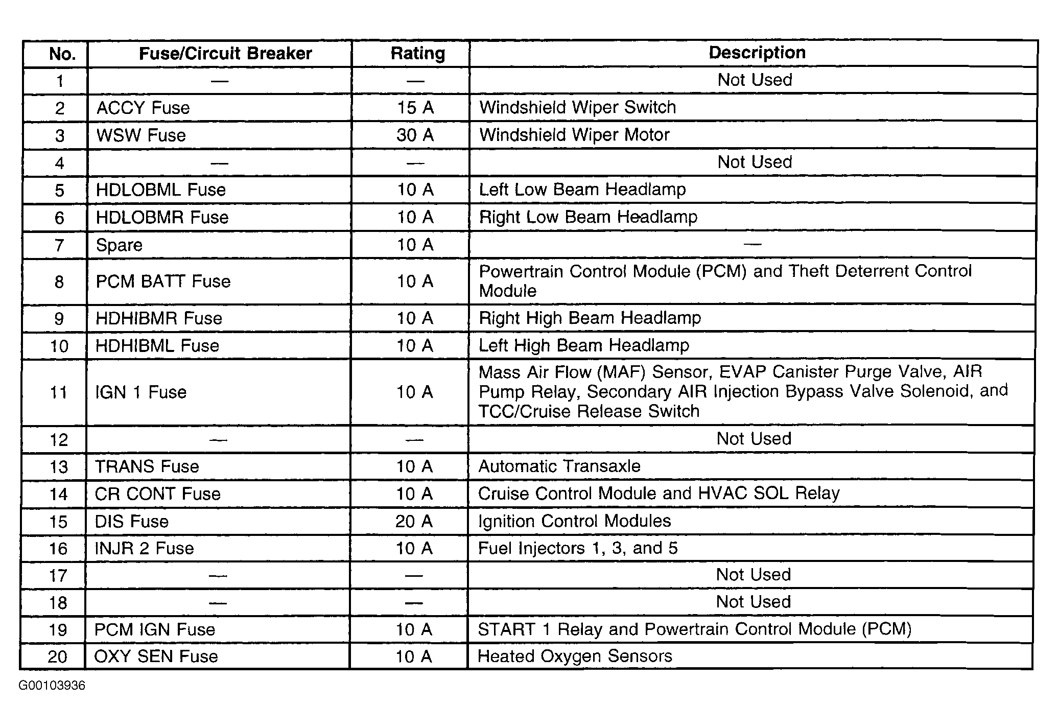

Regarding the P0410 - Check #35 in the images below. It is the relay for the air pump. You can buy a relay for a few bucks and try it. Cannot hurt.

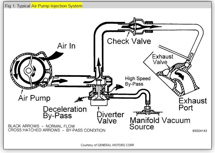

There is a check valve in there. I *believe* it is in the hose leading from the pump to the exhaust. I am attaching a diagram that is provided by GM. Personally, I would bet that that check valve is not opening and that is what is causing your issue. It is likely a dealership only part, but it would not hurt to try the local auto parts shops and rock auto.

Well from what I understand, the code indicates that there's some sort of flow error from the pump. So if you're hearing the pump run, and feeling it blowing air, then there has to be a blockage or something along those lines.

There has to be an airflow issue somewhere in there. If the pump is pumping air, then there's something else going on. Either no air is getting through (jammed check valve, clogged tube) or too much air is getting through (check valve stuck open or a leak in the tube).
