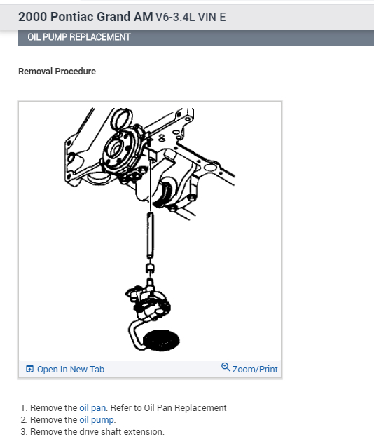

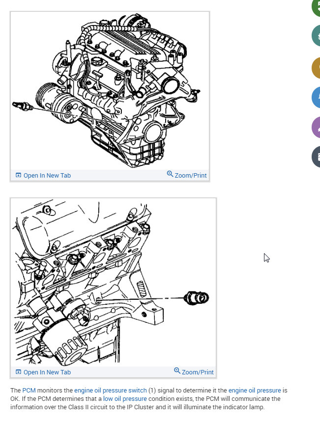

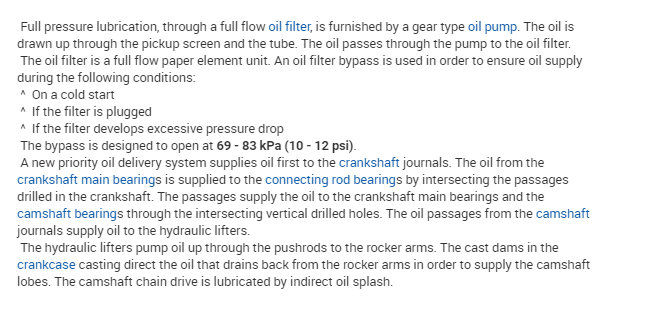

When you say "sender" are you talking about the oil pump? I have found that some confuse the pump/sender with the sensor.

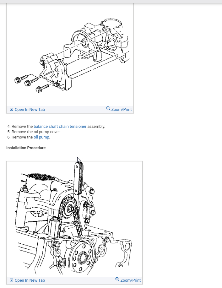

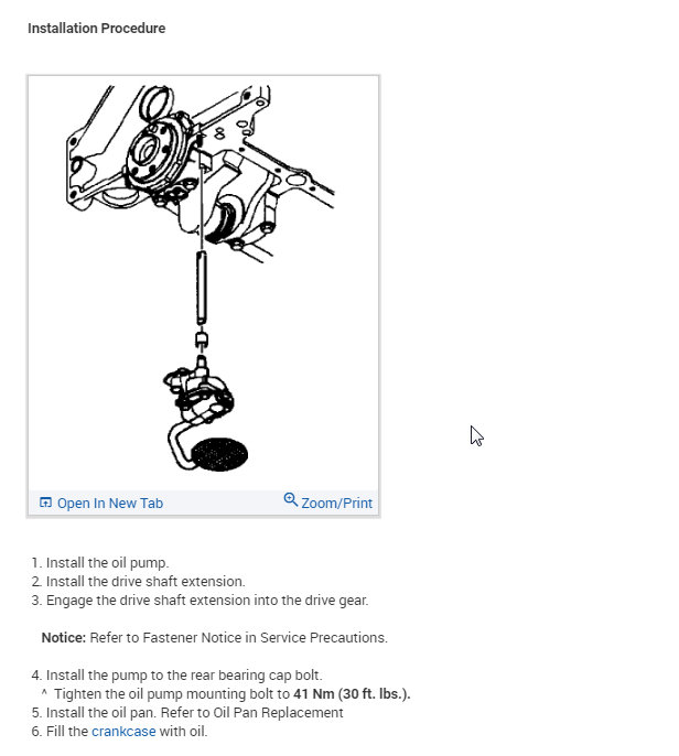

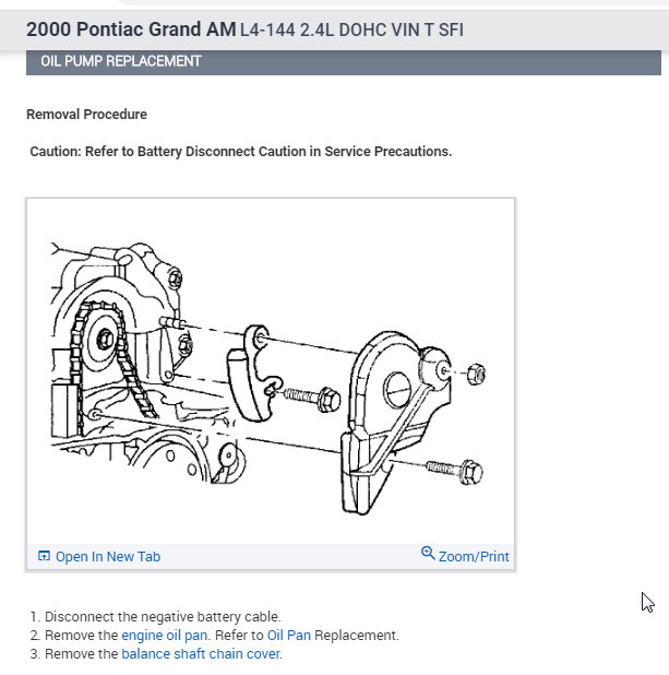

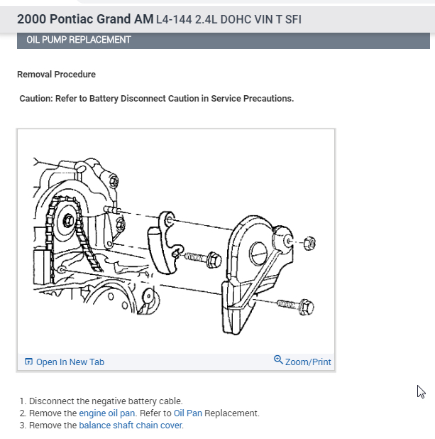

Assuming you are talking about the pump, I included the process to replace the pump on both engines because I am not sure which one you have. Either way, it is in the oil pan.
Let me know if I am missing something. Thanks
