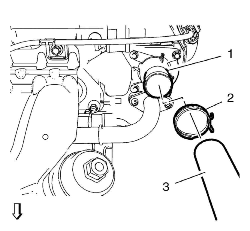

7. Loosen the radiator inlet hose clamp (2).
8. Remove the radiator inlet hose (3) from the engine coolant thermostat (1).

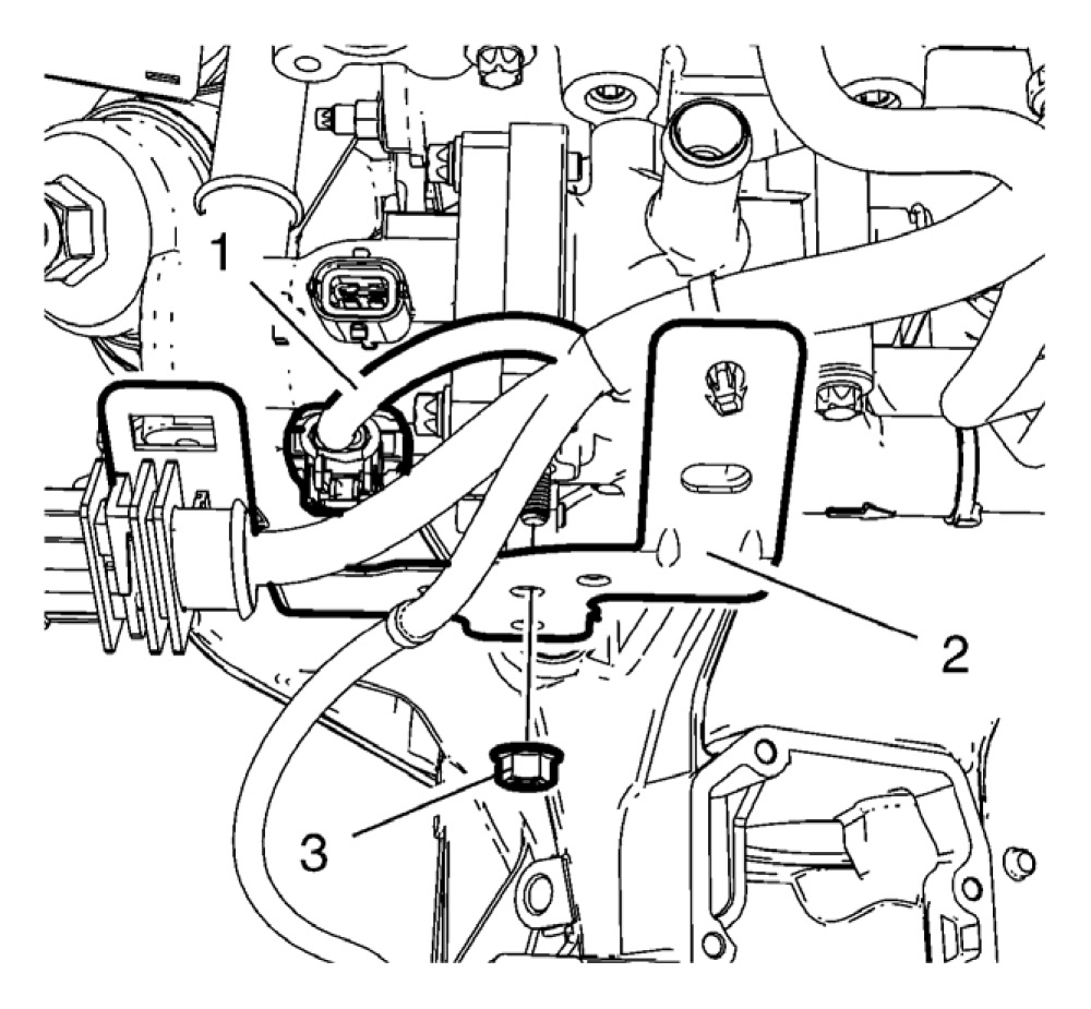

11. Disconnect the thermostat wiring harness plug (1).
12. Remove the thermostat housing bracket nut (3).
13. Hang the thermostat housing bracket (2) with attached wiring harness aside.

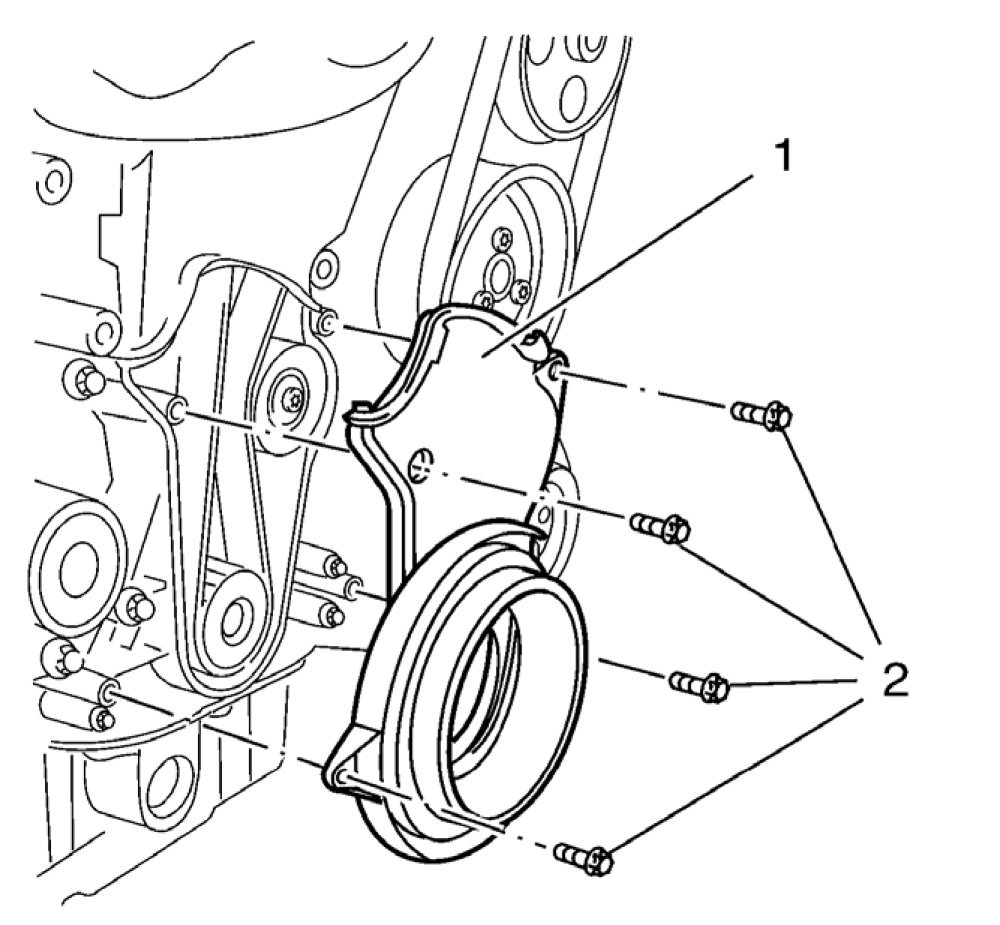

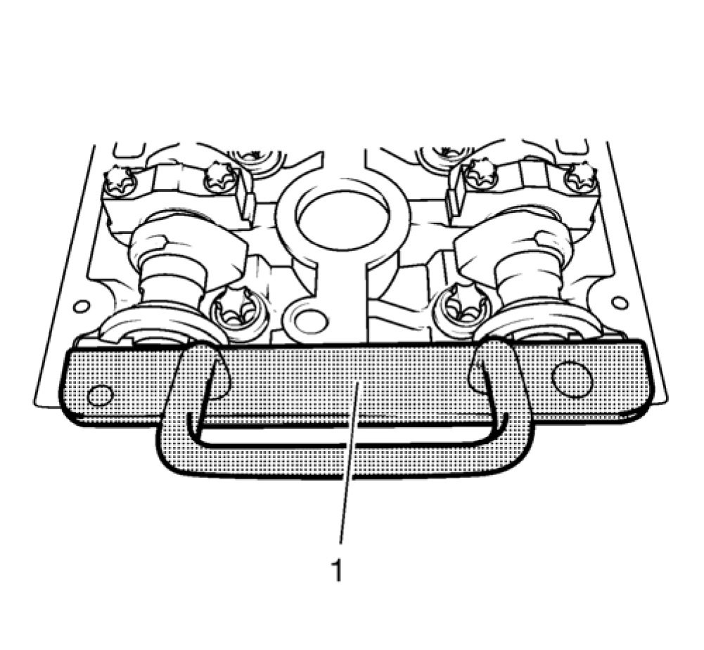

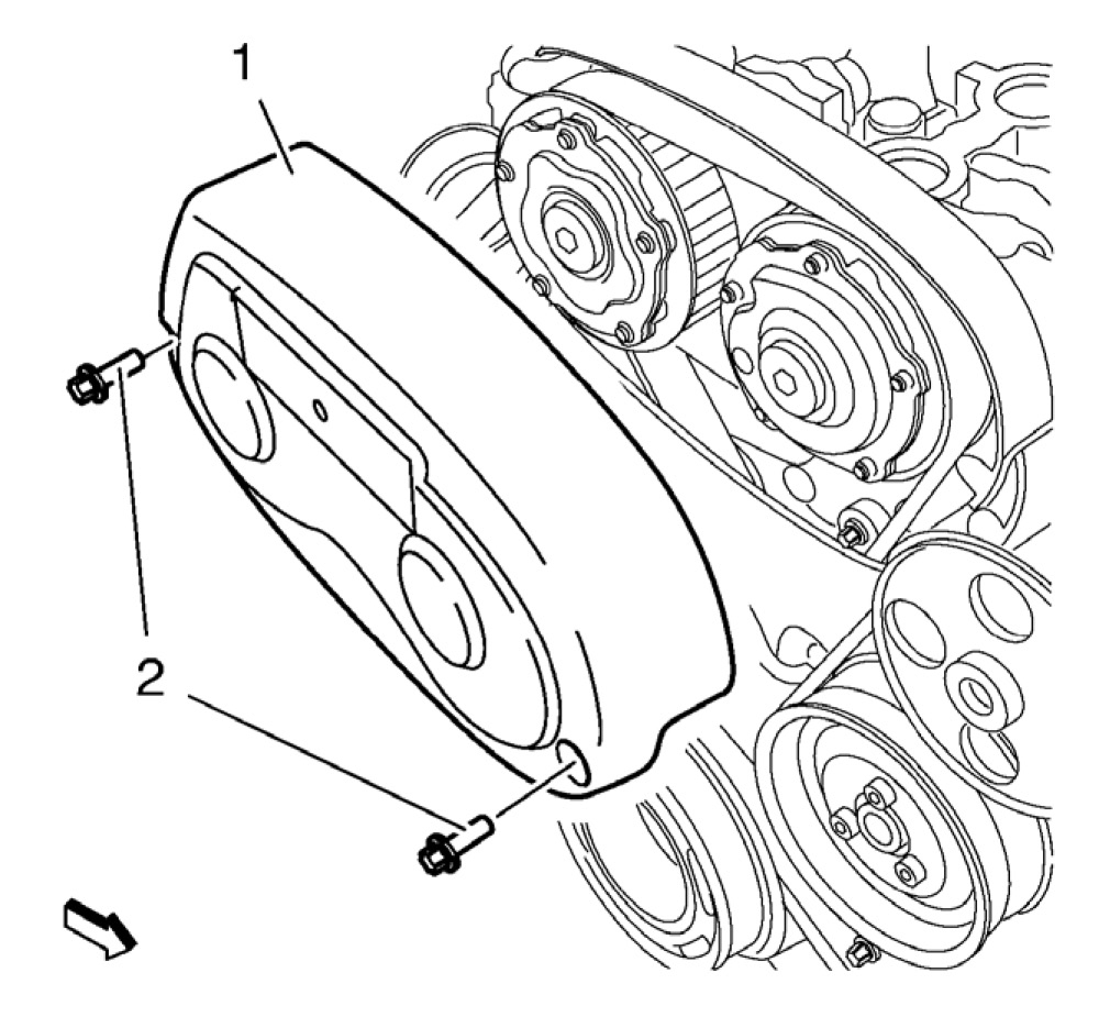

15. Remove the 2 timing belt upper front cover bolts (2).
16. Remove the timing belt upper front cover (1).

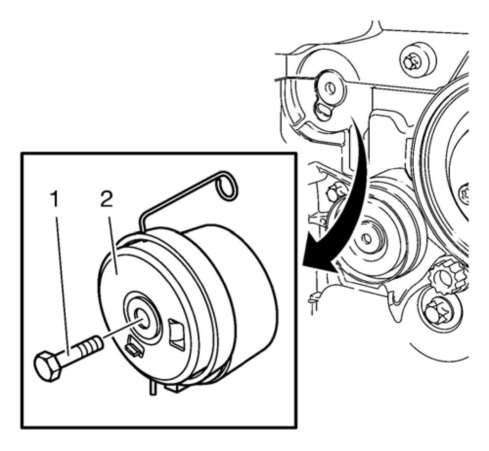

20. Remove the drive belt tensioner. See: Engine > Overhaul

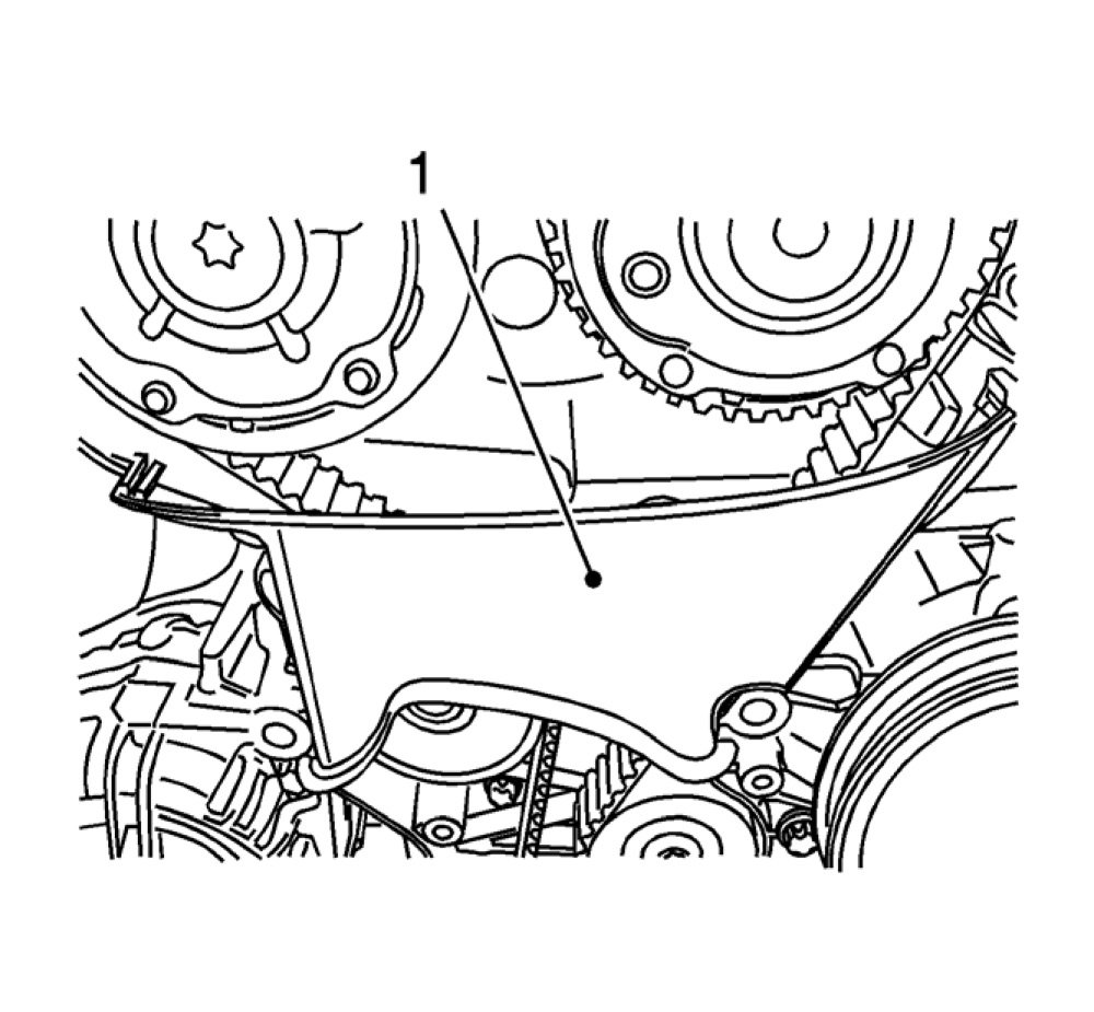

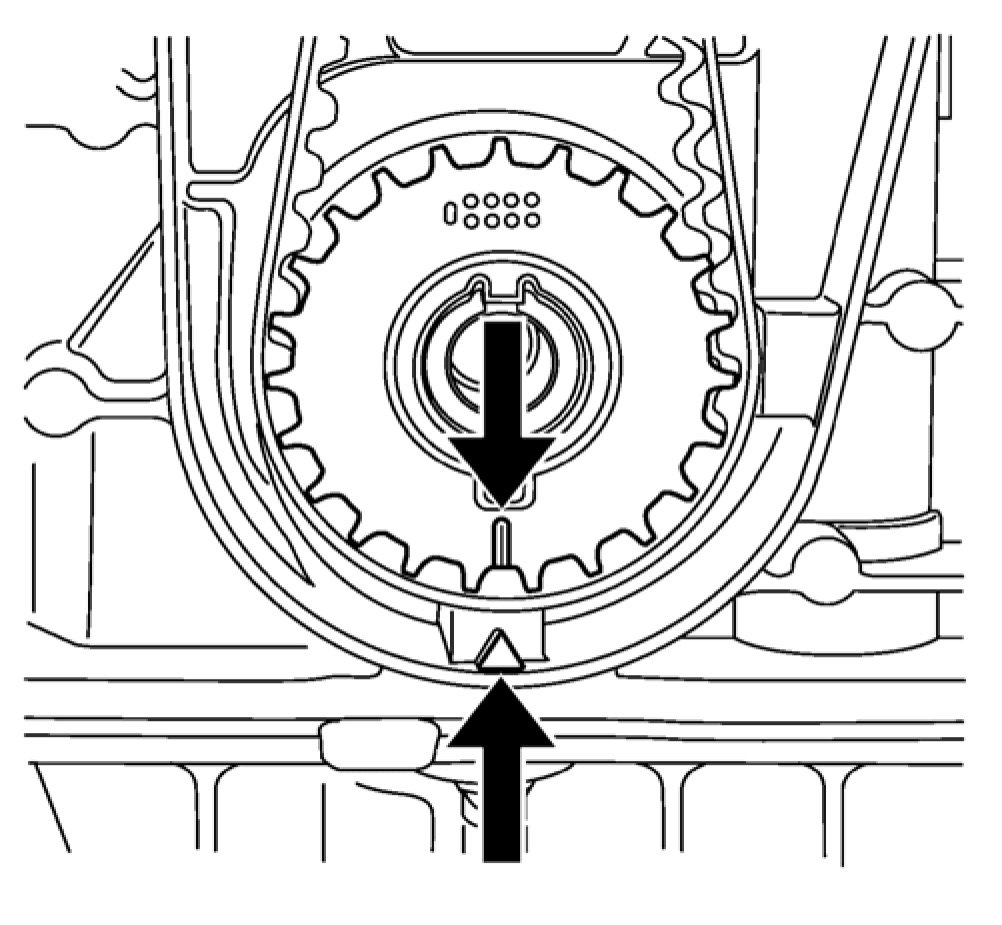

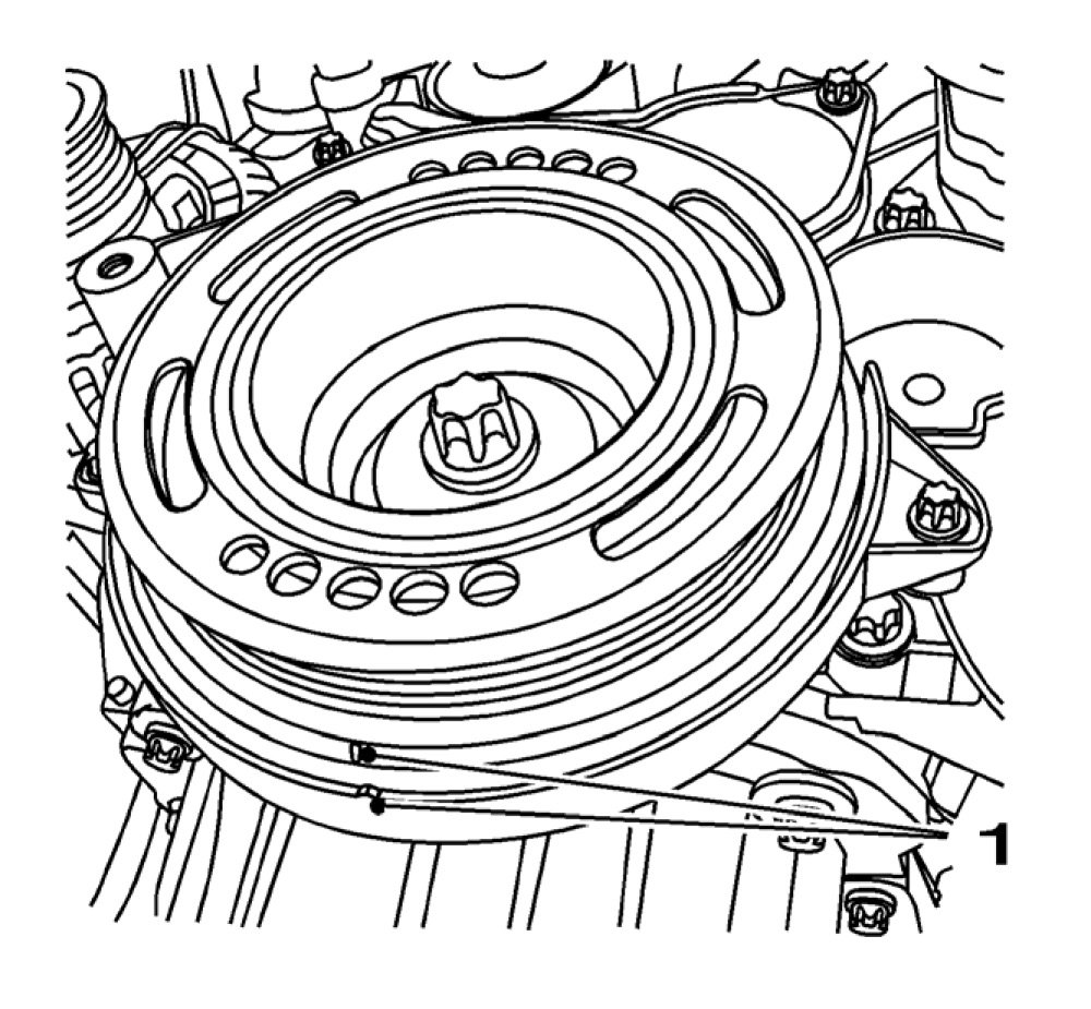

21. Set the crankshaft balancer in direction of engine rotation until the markings (1) line up with the cylinder 1 at TDC.
22. Remove the crankshaft balancer. See: Engine > Overhaul

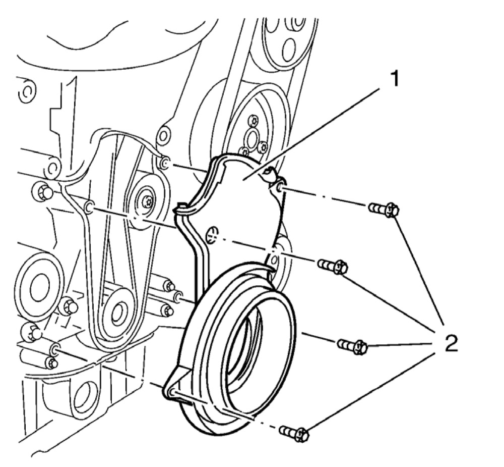

23. Remove the 4 lower timing belt cover bolts (2).
24. Remove the lower timing belt cover (1).

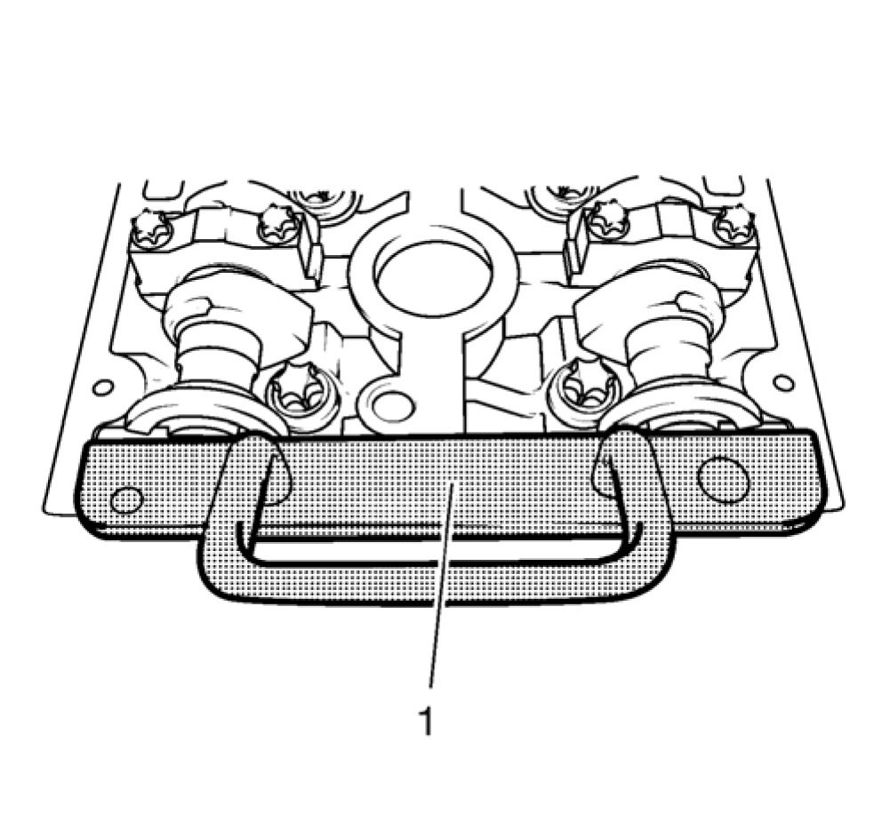

26. Support the engine under the oil pan.

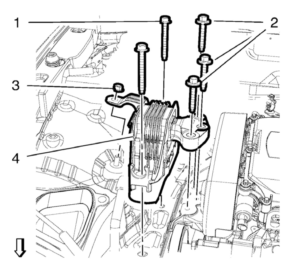

27. Remove the engine mount nut (3).
28. Remove the 5 engine mount bolts (1, 2).
29. Remove the engine mount (4).

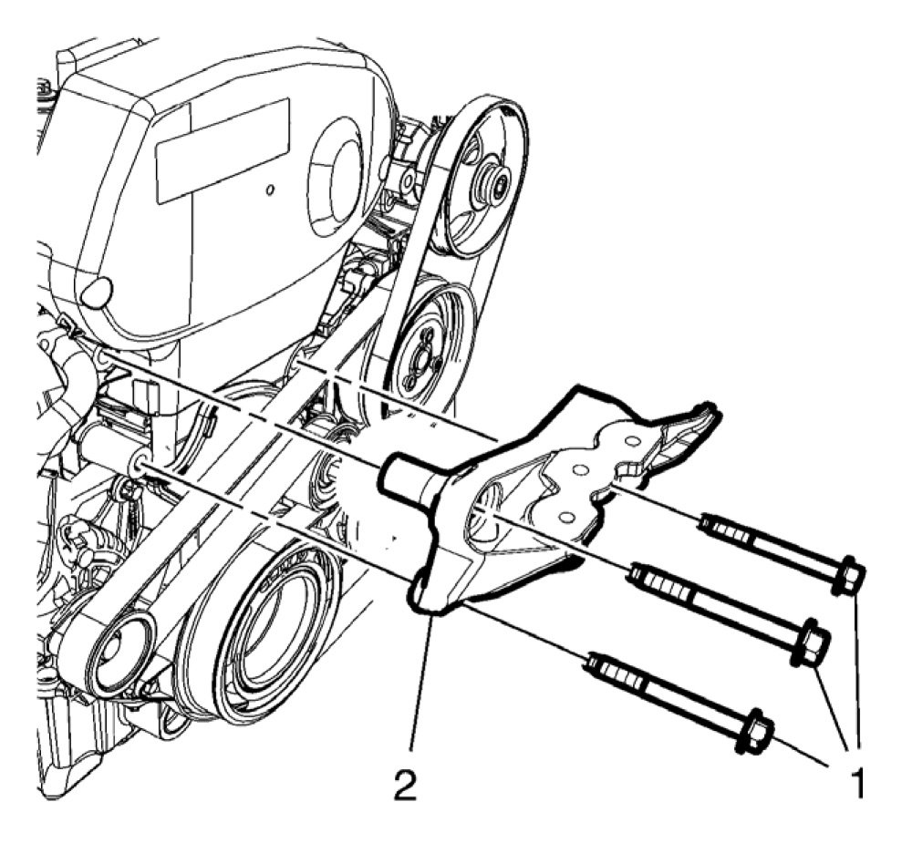

30. Remove the 3 engine mount bracket bolts (1).
31. Remove the engine mount bracket (2).

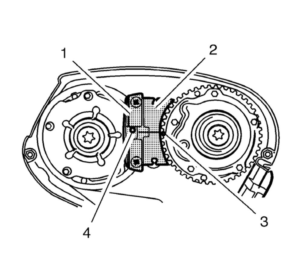

34. Install the EN-6340 locking tool into the camshaft adjusters.
Note: The spot type marking (4) on the intake camshaft adjuster does not correspond to the groove of EN-6340 locking tool - left during this process but must be somewhat above as shown.
^ Install the EN-6340 locking tool - left (1) in the camshaft adjusters as shown.
Note: The spot type marking (3) on the exhaust camshaft adjuster must correspond to the groove on EN-6340 locking tool - right.
^ Install EN-6340 locking tool - right (2) in the camshaft adjusters as shown.

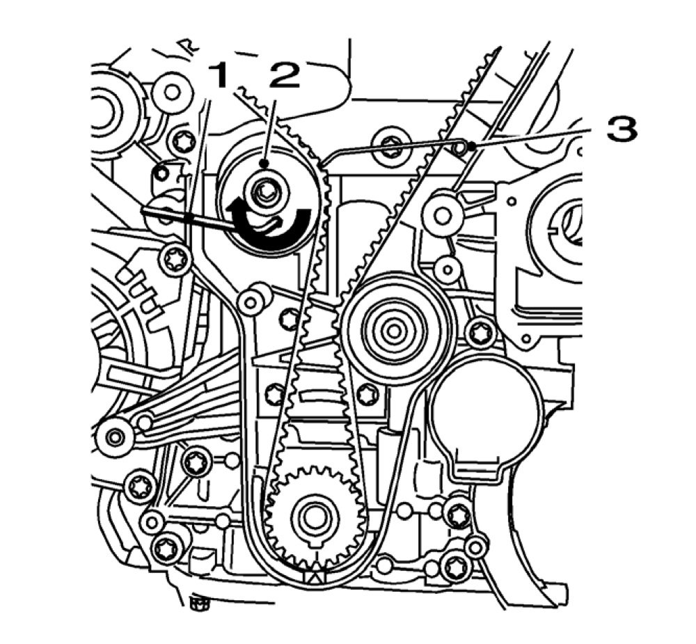

35. Apply tension to the timing belt tensioner (2) in the direction of the arrow, using an allen key (1).
36. Install the EN-6333 pin (3).

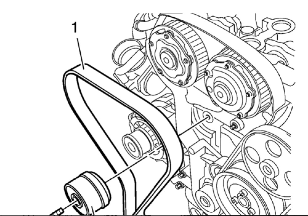

37. Remove the timing belt (1).
38. Remove and DISCARD the timing belt tensioner bolt (3).
39. Remove the timing belt tensioner (2).

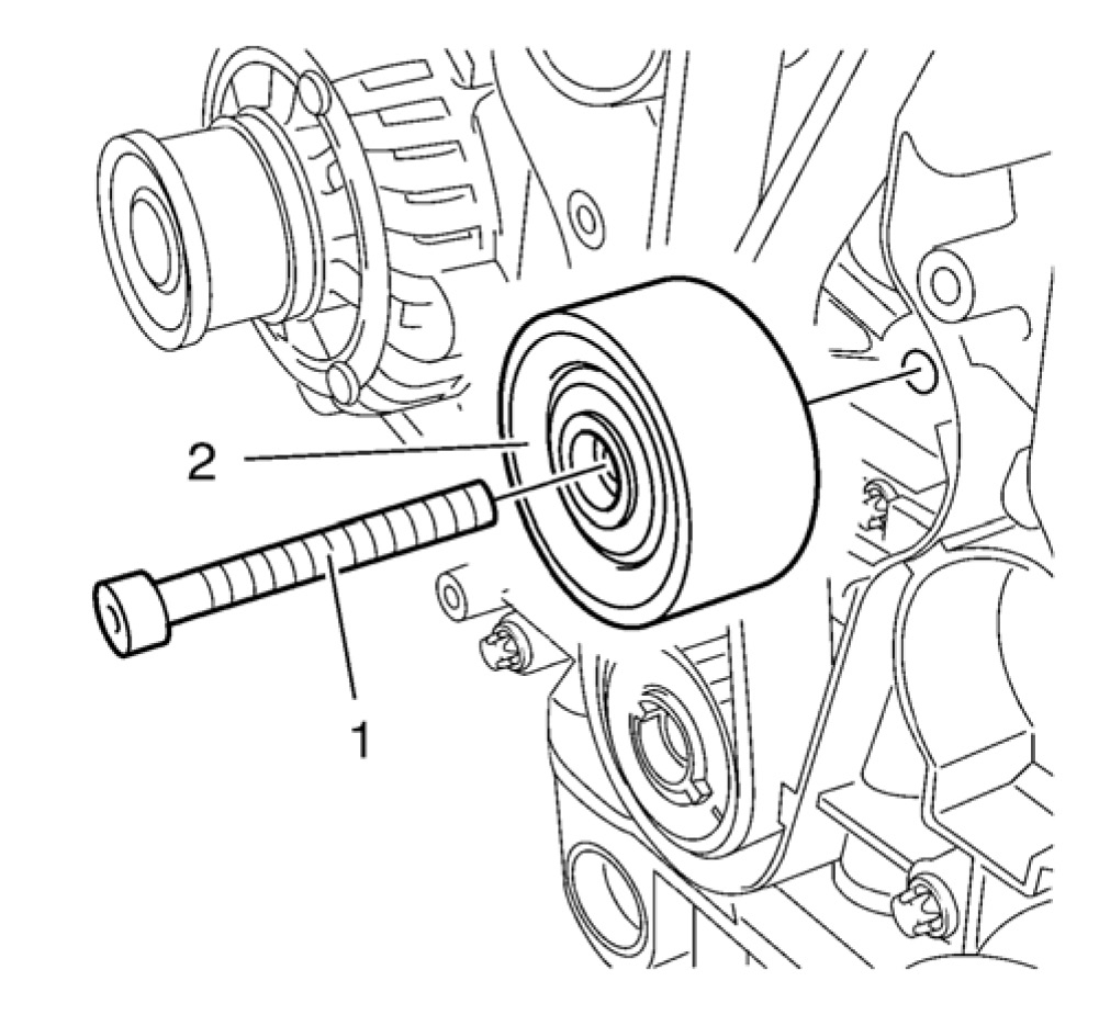

41. Remove the timing belt idler pulley bolt (1).
42. Remove the timing belt idler pulley (2).

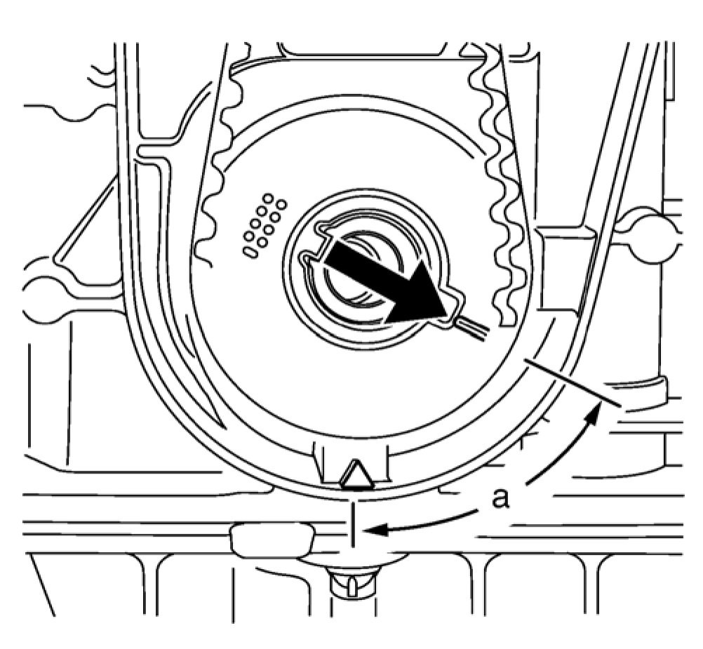

44. Set the crankshaft in direction of engine rotation to 60 degrees (a) before TDC. Use the EN-45059 meter and the crankshaft balancer bolt.

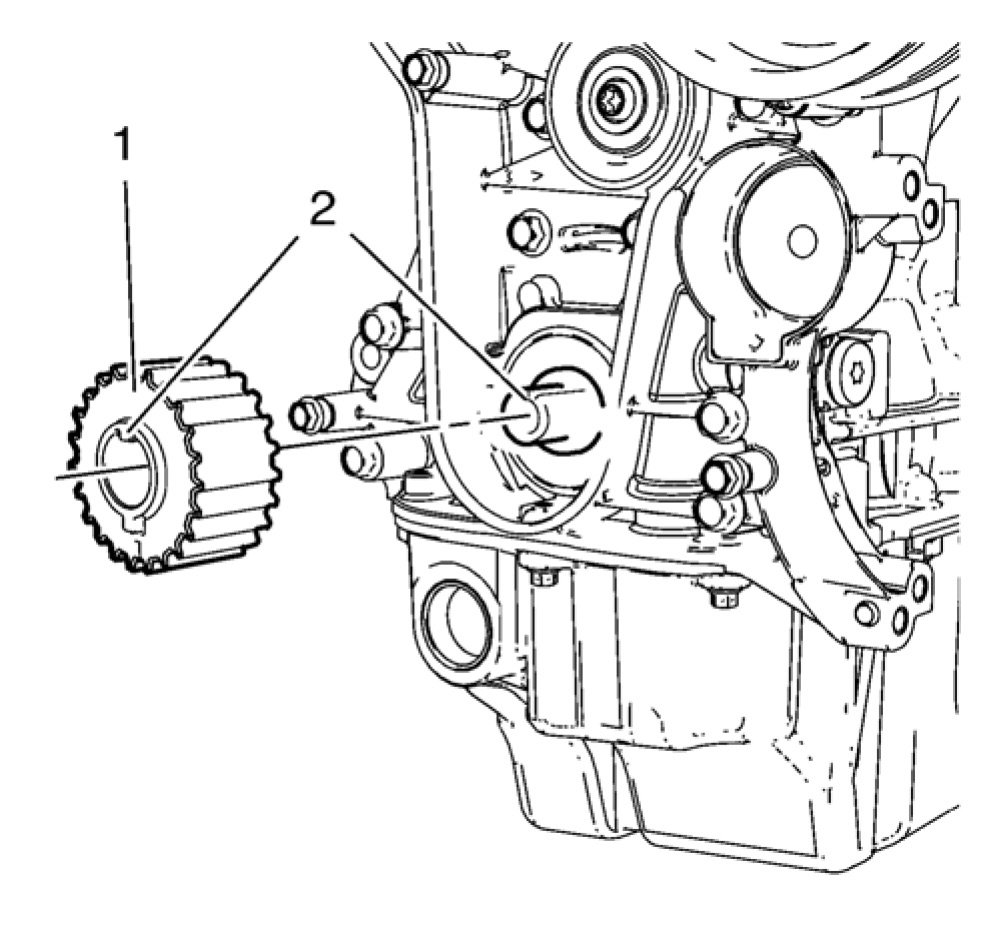

45. Remove the crankshaft sprocket (1).

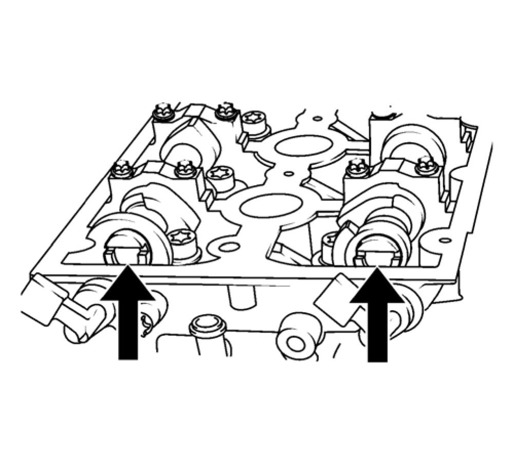

pic 15
Note: Note the arrows.
48. Turn the camshaft by the camshaft position actuator adjuster until the groove on the end of the camshafts is horizontal.
pic 16
49. Install the EN-6628-A locking tool (1).

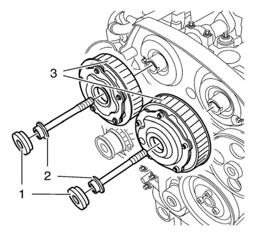

51. Remove the camshaft position actuator adjuster closure bolt (1) of the intake camshaft position actuator adjuster and the exhaust camshaft position actuator adjuster (3).
Note: A second technician is required.
Note: Use an appropriate open-end wrench in order to counterhold the camshaft hexagon. A thin cross-section wrench is required for a better fit. The usage of EN-6628-A locking tool is for the camshaft adjustment to prevent misalignment of the camshafts. The wrench is required to counterhold the camshafts during bolt torque procedure.

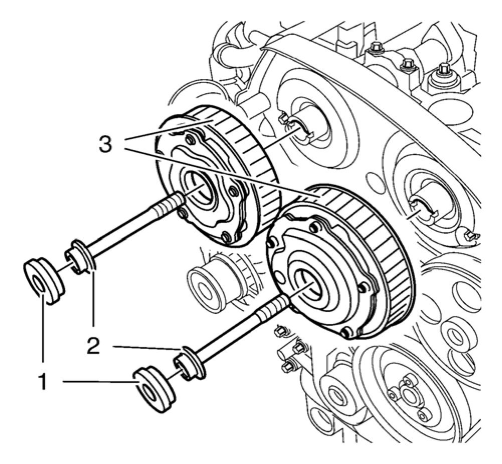

52. Remove and DISCARD the intake camshaft position actuator adjuster bolt and/or the exhaust camshaft position actuator adjuster bolt (2).
53. Remove the intake camshaft position actuator adjuster and the exhaust camshaft position actuator adjuster (3).

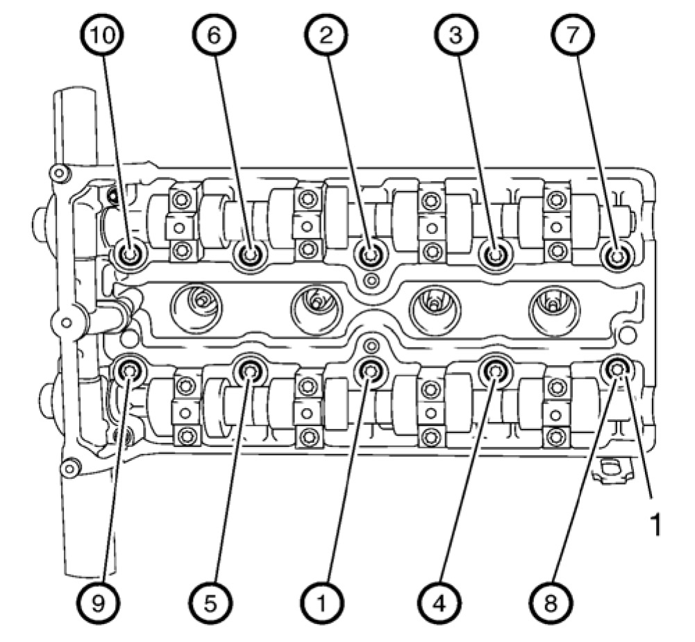

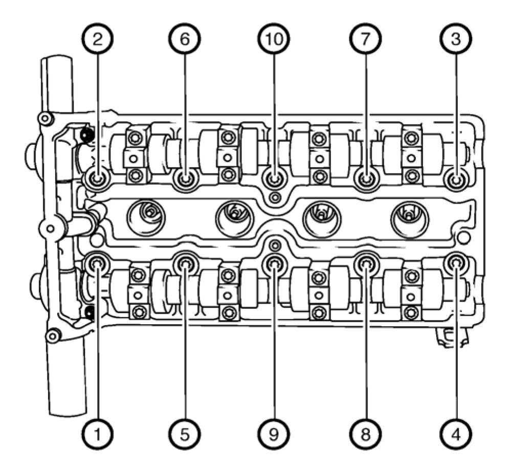

55. Loosen the 10 cylinder head bolts in sequence as shown.
55.1. Loosen the 10 bolts 90 degrees.
55.2. Loosen the 10 bolts 180 degrees.

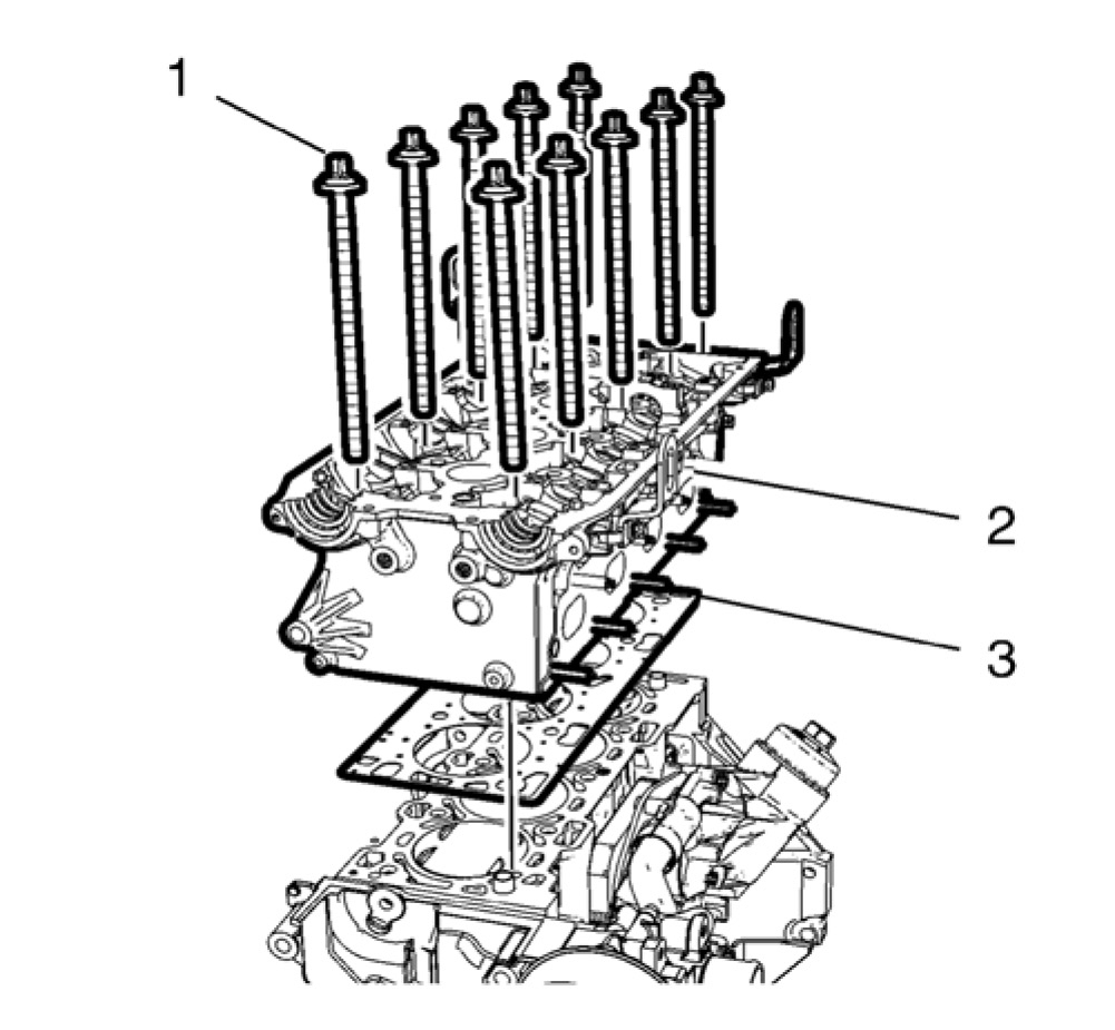

56. Remove and DISCARD the 10 cylinder head bolts (1).
57. Remove the cylinder head (2).
58. Remove and DISCARD the cylinder head gasket (3).

9. Install 10 NEW cylinder head bolts (1).
10. Tighten the bolts as shown in sequence in 5 passes, using the EN-45059 meter:
10.1. First pass to 25 N.m (18 lb ft)
10.2. Second pass to 90 degrees
10.3. Third pass to 90 degrees
10.4. Fourth pass to 90 degrees
10.5. Final pass to 45 degrees

14. Install intake camshaft position actuator adjuster and/or the exhaust camshaft position actuator adjuster (3).
15. Install a NEW intake camshaft position actuator adjuster bolt and/or a NEW exhaust camshaft position actuator adjuster bolt (2).
pic 25
16. Install the EN-6340 locking tool into the camshaft position actuator adjusters.
Note: The spot type marking (4) on the intake camshaft position actuator adjuster does not correspond to the groove of EN-6340 locking tool - left during this process but must be somewhat above as shown.
16.1. Install the EN-6340 locking tool - left (1) in the camshaft position actuator adjusters as shown.
Note: The spot type marking (3) on the exhaust camshaft position actuator adjuster must correspond to the groove on EN-6340 locking tool - right.
16.2. Install the EN-6340 locking tool - right (2) in the camshaft position actuator adjusters as shown.

17. Tighten the camshaft position actuator adjuster bolts (2) in three passes use the EN-45059 meter:
Hold at the appropriate camshaft hexagon.
17.1. First pass tighten to 50 N.m (37 lb ft).
17.2. Second pass to 150 degrees.
17.3. Final pass to 15 degrees.
Note: Check the closure bolt seal ring.
18. Install the 2 camshaft position actuator adjuster closure plugs (1) and tighten to 30 N.m (22 lb ft).

33. Install the engine mount (4).
34. Install the 2 engine mount bolts (1) and tighten to 62 N.m (46 lb ft).
Caution: Refer to Torque-to-Yield Fastener Caution.
35. Install the 3 engine mount bolts (2) and tighten in three passes use the EN-45059 meter.
35.1. First pass tighten to 50 N.m (37 lb ft).
35.2. Second pass to 60 degrees.
35.3. Third pass to 15 degrees.

Note: The crankshaft sprocket and oil pump housing must align.
39. Check the crankshaft position.
pic 36
40. Install the lower timing belt cover (1).
Caution: Refer to Fastener Caution.
41. Install the 4 lower timing belt cover bolts (2) and tighten to 6 N.m (53 lb in).

44. Remove the EN-6340 locking tool.

pic 38
51. Install the radiator inlet hose (3) with the radiator inlet hose clamp (2) to the engine coolant thermostat (1).
52. Install the heater inlet hose to the engine coolant thermostat housing.
53. Install the heater outlet hose to the engine coolant thermostat housing.
pic 39
54. Install the engine coolant thermostat housing bracket (2).
55. Install the engine coolant thermostat housing bracket nut (3) and tighten to 6 N.m (53 lb in).
56. Connect the thermostat wiring harness plug (1).
