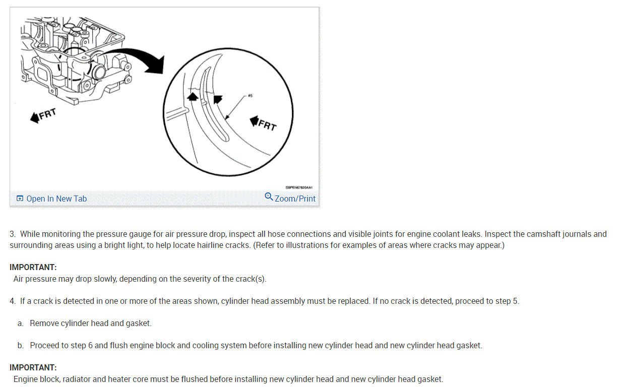

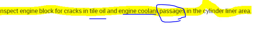

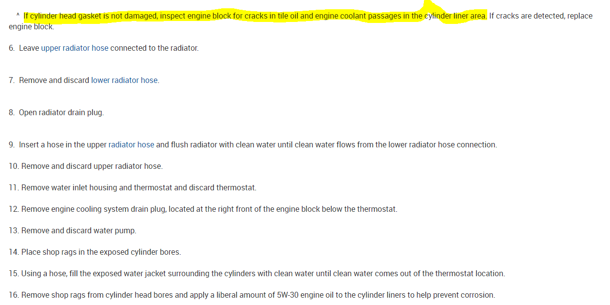

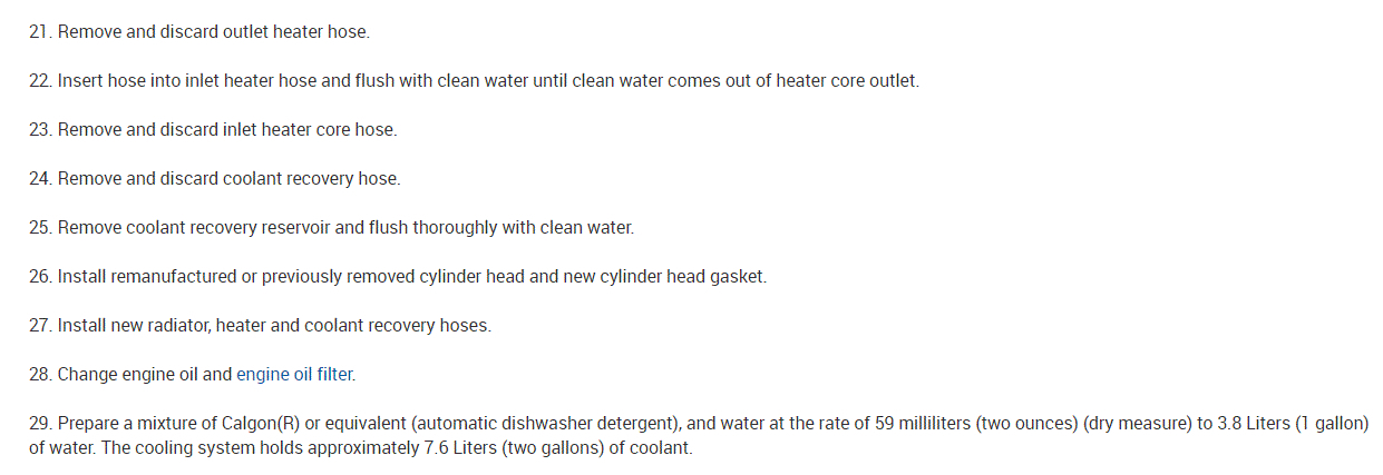

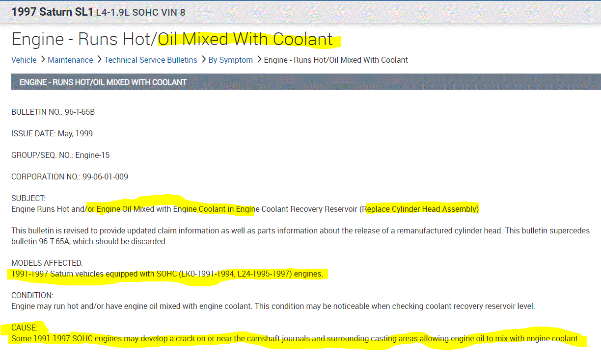

Oil was being pumped into the coolant system.

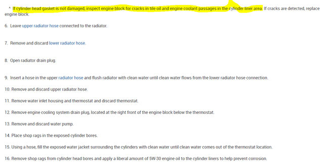

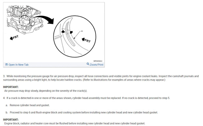

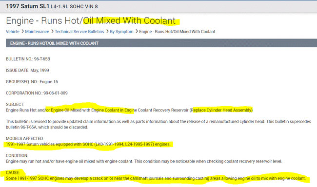

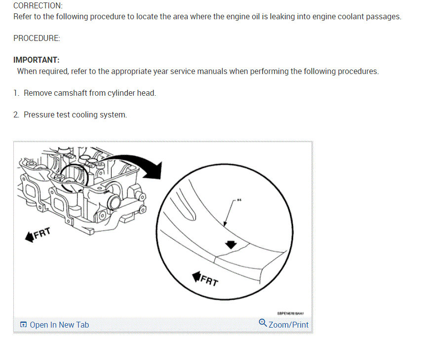

Ordered a rebuilt and pressure tested head, installed head at a professional repair shop, cleaned and checked block deck, new head gasket, and bolts. Had a heck of a time removing all oil from the coolant even after replacing all hoses and flushing the radiator. Drove for less than 1/4 tank of gas, way more oil in coolant than the original head.
Called the head rebuilder, they sent another head, same problem, only even more oil. Help!
