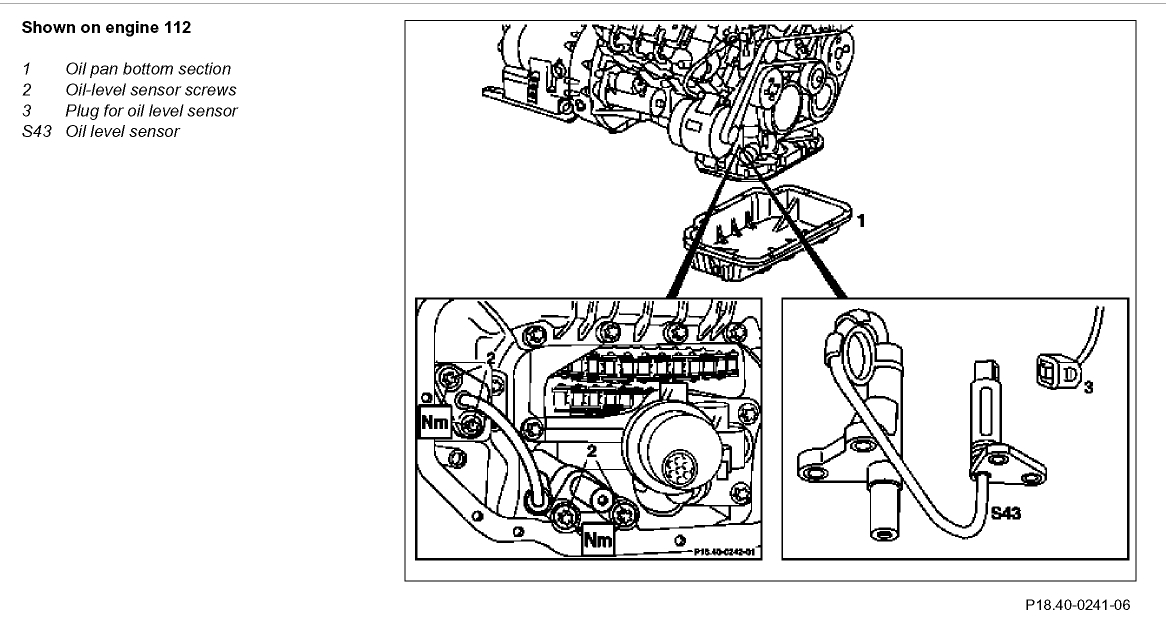

Hi, I checked oil level it is good, but show me on dashboard oil high. What would cause the warning light to come on?
Jun 1, 2018 at 11:58 AM

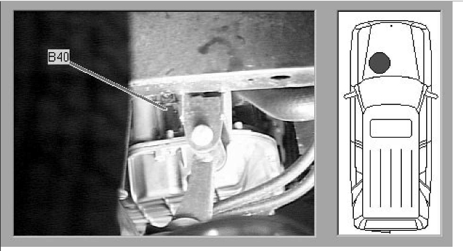

The oil level sensor has gone out and needs to be replaced. Below is the location of the sensor. Check out the diagrams (below). Please let us know if you need anything else to get the problem fixed.
