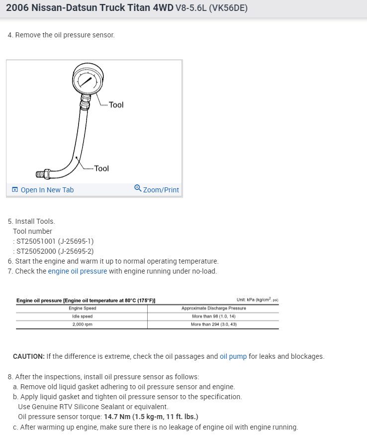

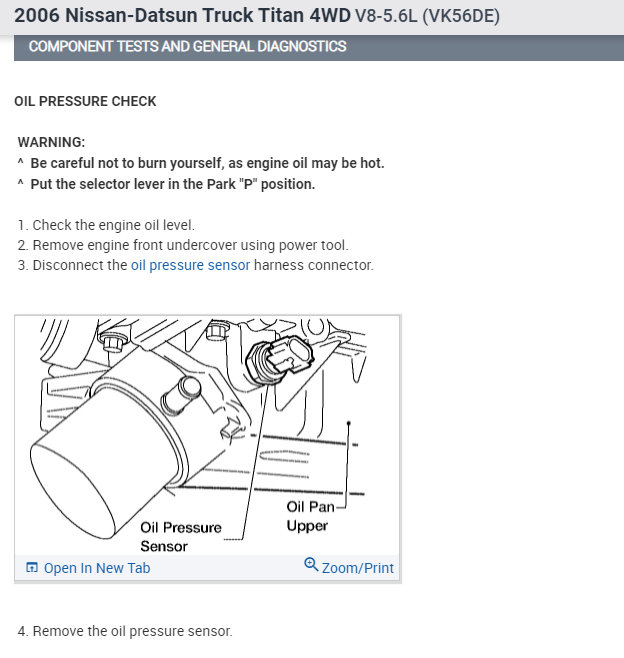

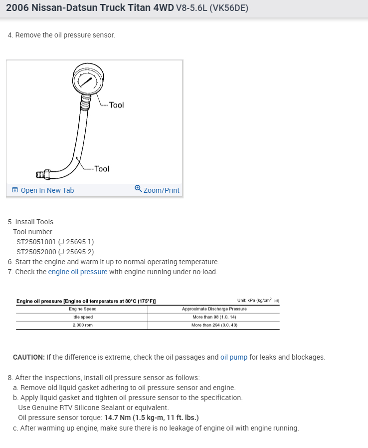

To figure out if it is a bad sensor or actual oil pressure issue, you will have to test the oil pressure using a pressure gauge. Those gauges can be found at your local auto parts store. Most of them will let you borrow them to use.
https://www.2carpros.com/articles/high-or-low-engine-oil-pressure
I have attached diagrams for the testing procedure below for your reference.

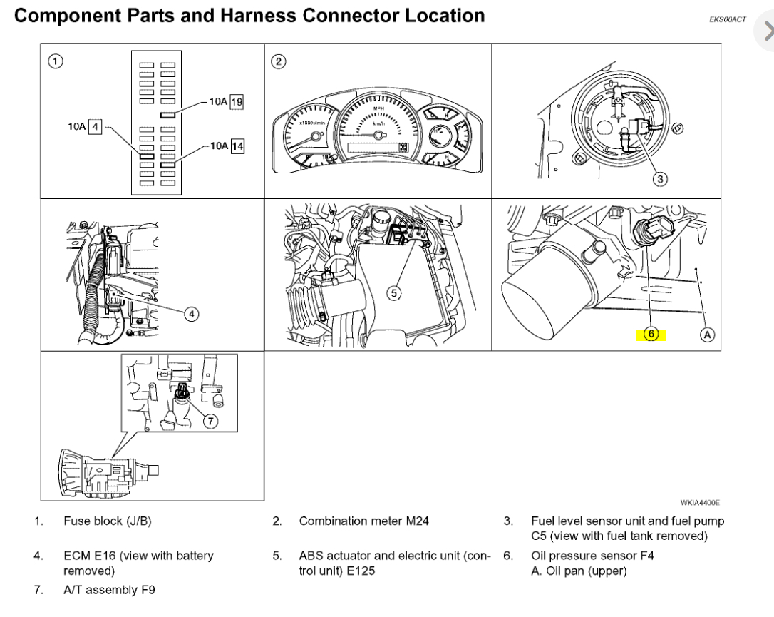

Yes, these 3 codes are not related to the oil pressure sensor.
The code P1564 is for the ASCD (automatic speed control device) steering switch. The C1142 is a ABS fault code, which could be the reason why the ASCD error exists. And the U1000 is for the canbus communication self diagnostic code.
