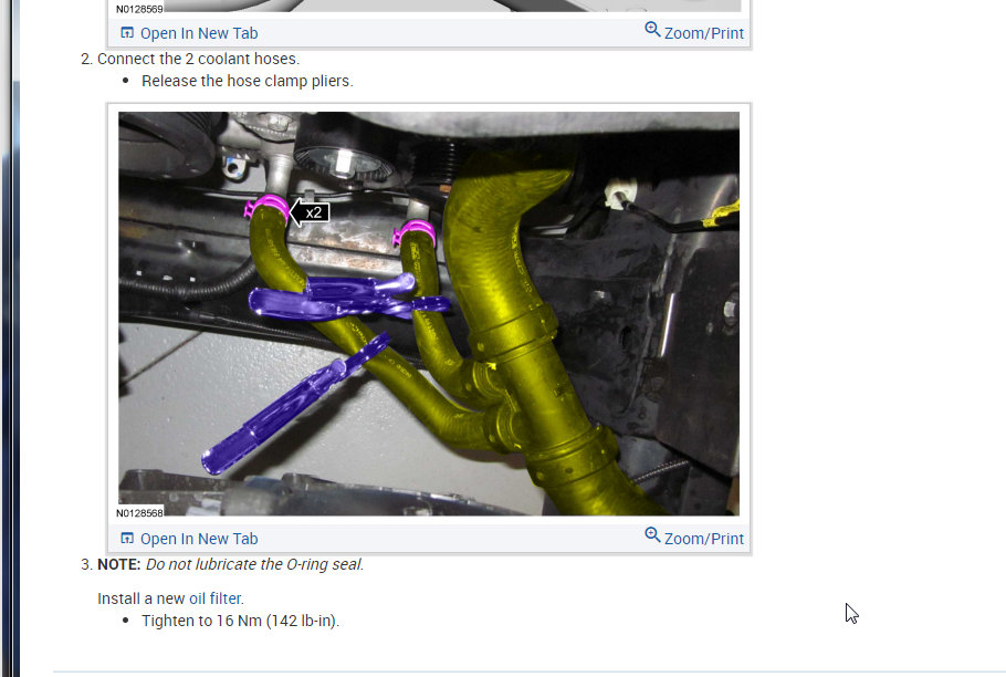

coolant leaking from tubes coming out of the oil filter mount.
Jan 1, 2021 at 1:02 PM

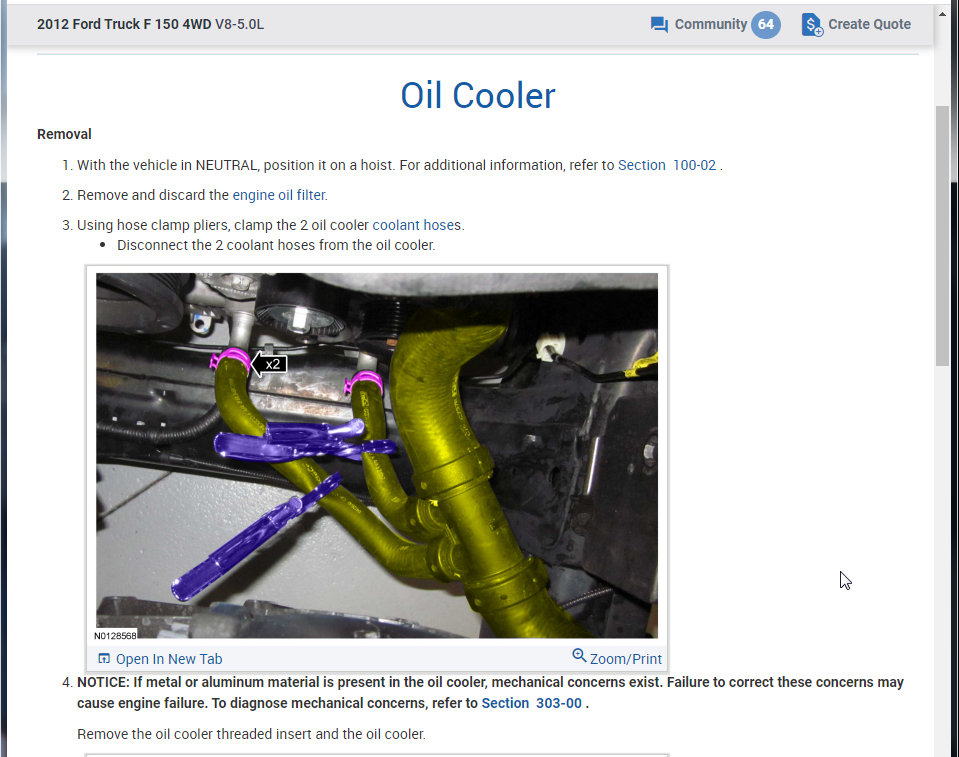

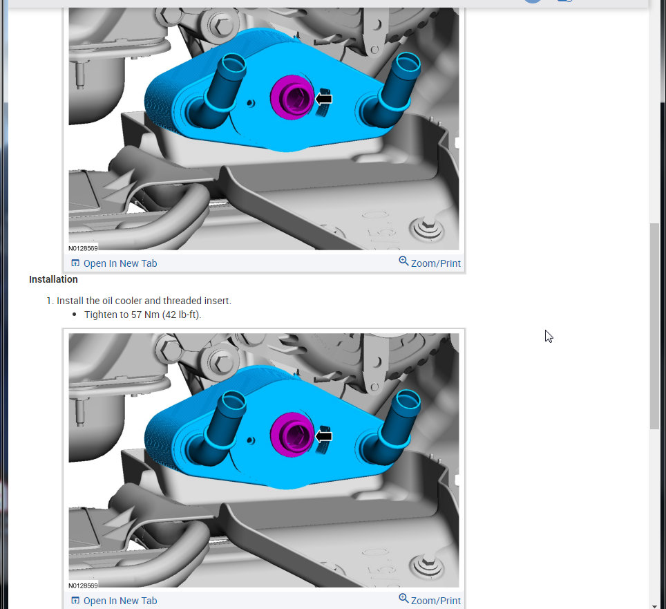

This is the oil cooler and if the tubes are leaking then it may just be a clamp that is on that hose or the cooler is cracked and needs replaced.
Attached are the instructions to replace it. I would remove it and inspect it closely to see if it needs replaced unless you can already tell it does. In which case, you have the instructions to replace it.
Let us know if you have questions. Thanks
