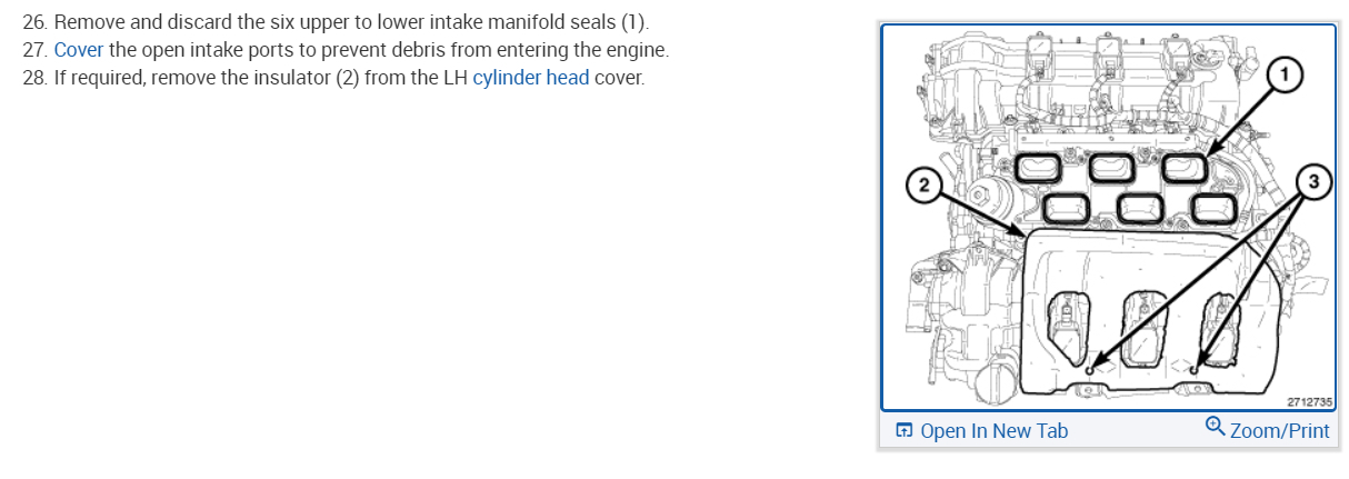

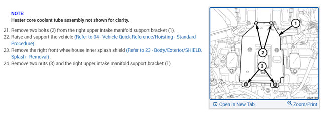

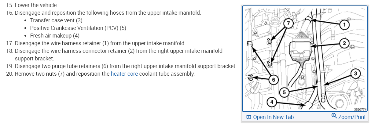

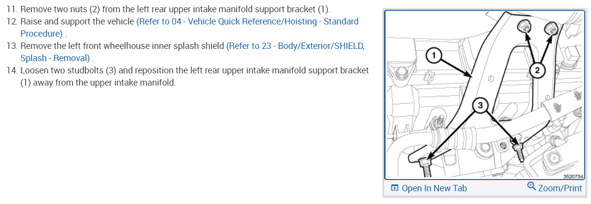

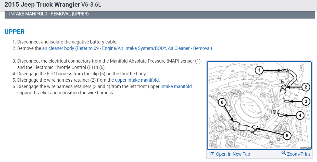

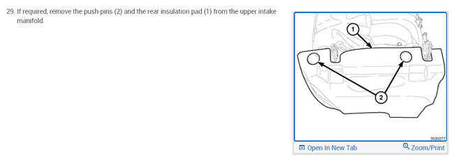

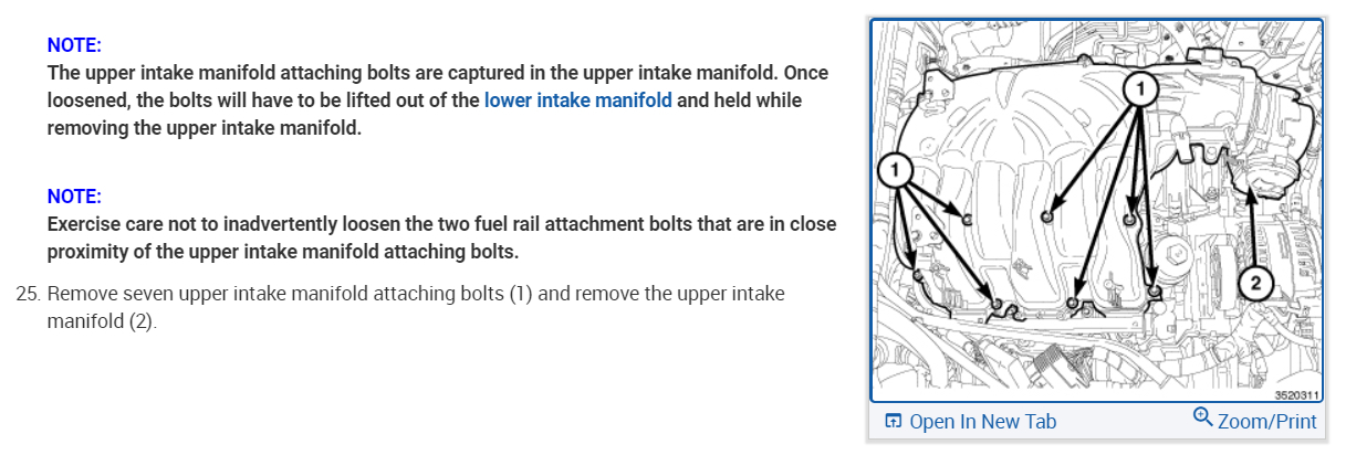

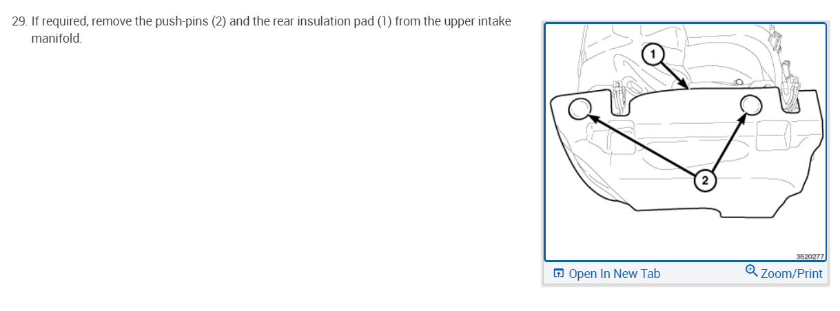

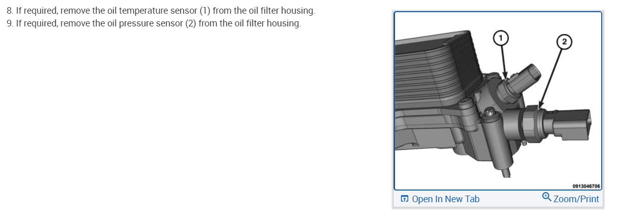

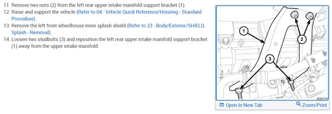

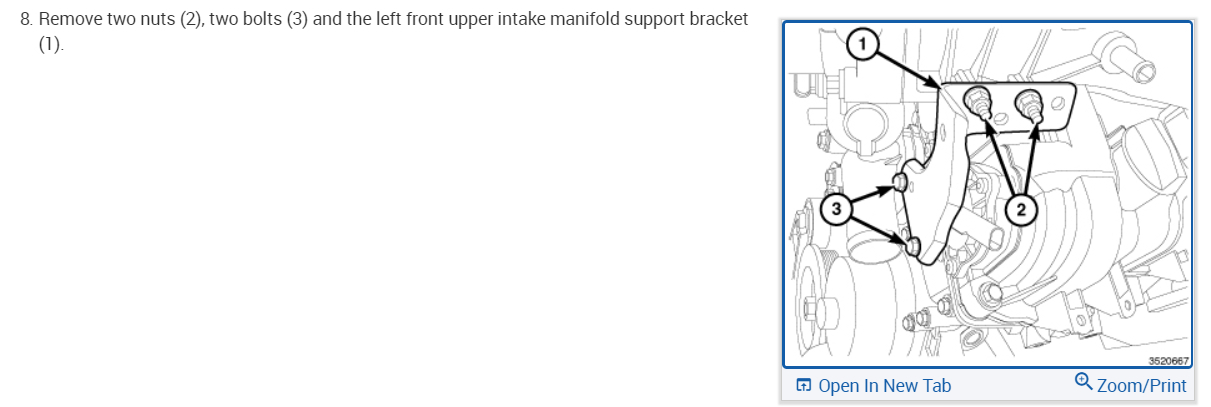

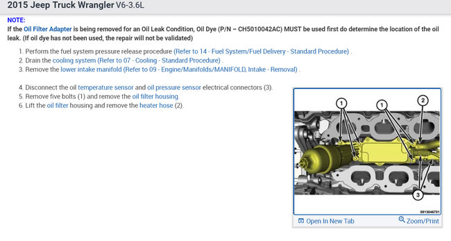

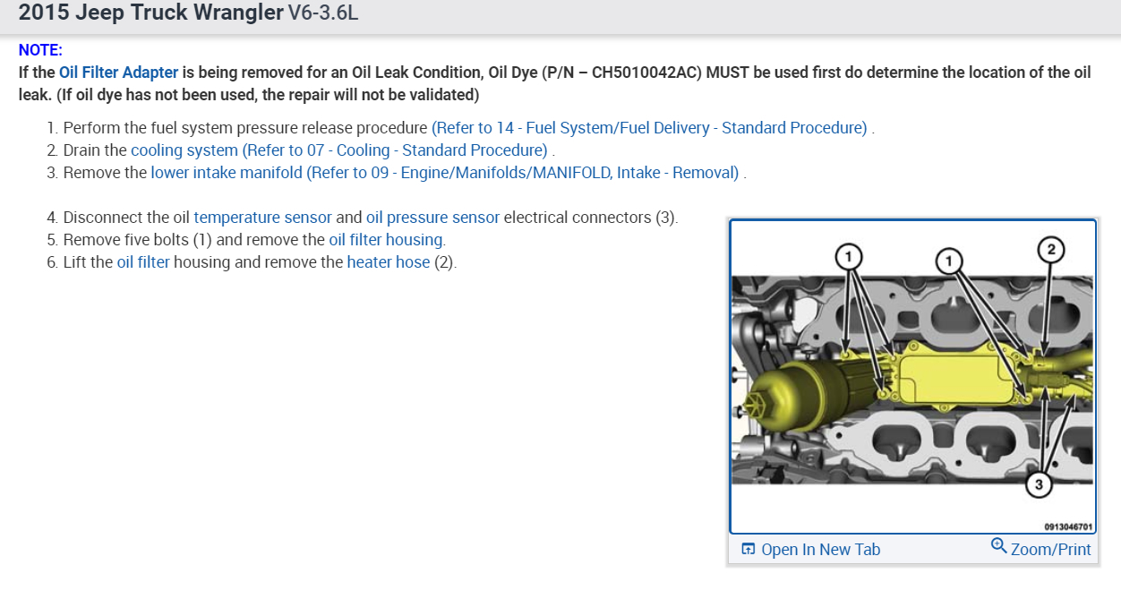

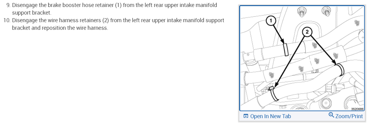

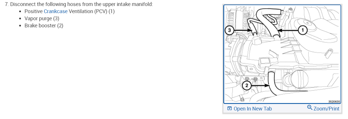

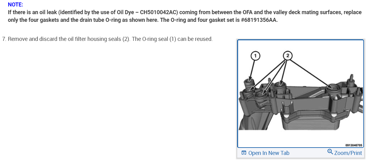

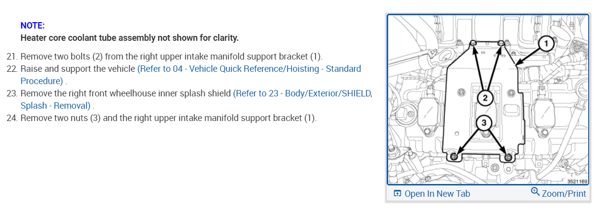

I would let it go until it set a code again. The reason it costs so much is because the intake needs to come off to do the job. Here are diagrams below to show you what needs to be done. Check out the diagrams (below). Please let us know what happens. Cheers, Ken

Thanks, Ken! I decided to wait until it codes again.
Nov 16, 2018 at 9:22 AM
Wise man. :) Let us know if it comes back.
