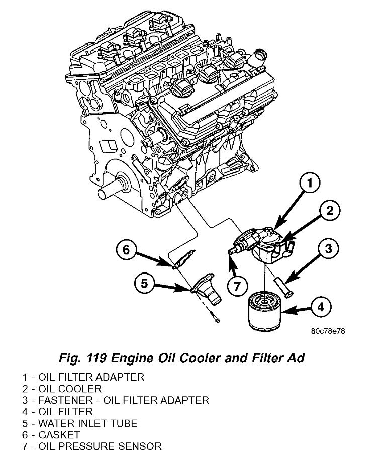

The oil cooler housing that bolts up to the block. The bolt hole is stripped and I'm needing a solution.

About the only option would be to get a Heli-coil kit in the correct size and install it.
https://www.youtube.com/watch?v=NoIcq2pWxRc
Image (Click to enlarge)
