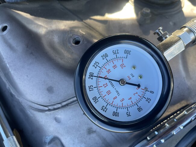

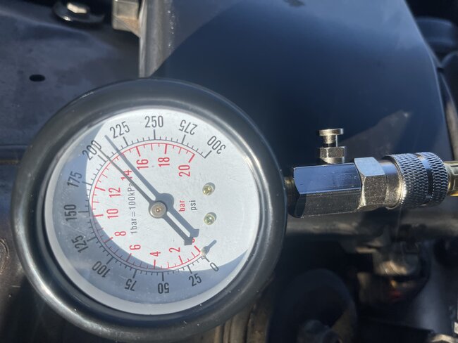

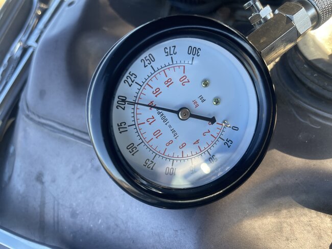

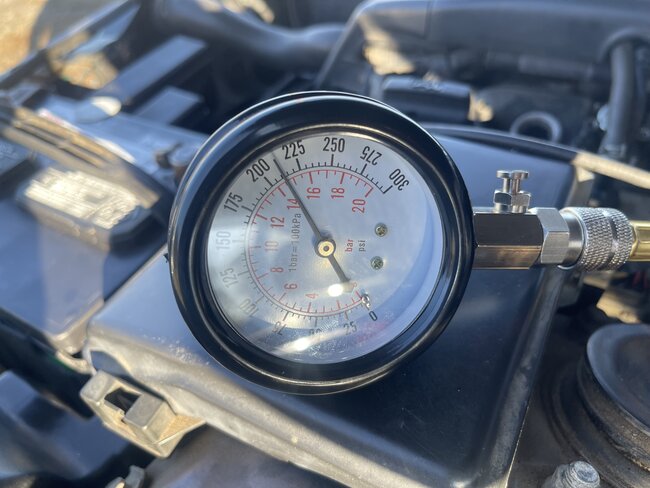

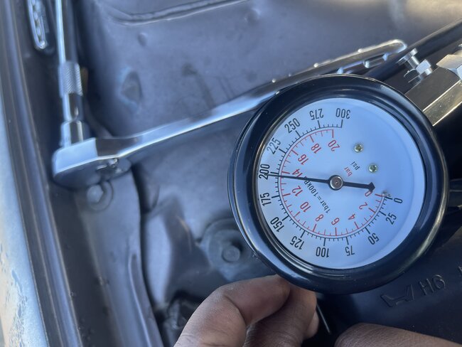

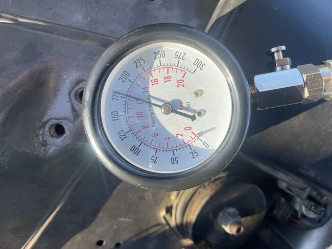

I did a compression test on my engine after white smoke was intermittently coming out of exhaust. I’ve also been losing coolant, so I wanted to do this test to see if there is a head gasket leak. My car doesn’t overheat or lose power. But it does have a rough idle only when the engine is cold. It will rev up and down for approximately a few minutes, or until you start driving. After that it doesn’t do it again until engine goes back cold… I just recently changed the oil. The oil wasn’t milky like if coolant was mixing into it, but it was very black.

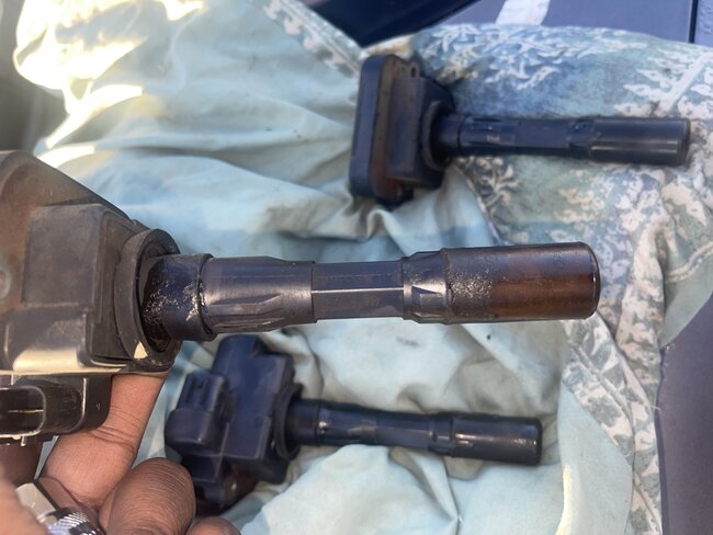

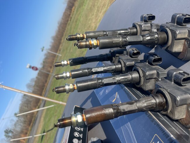

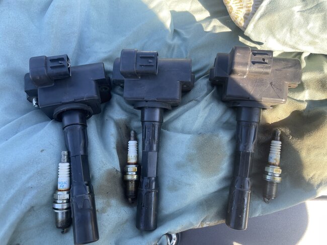

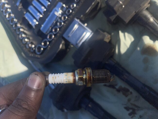

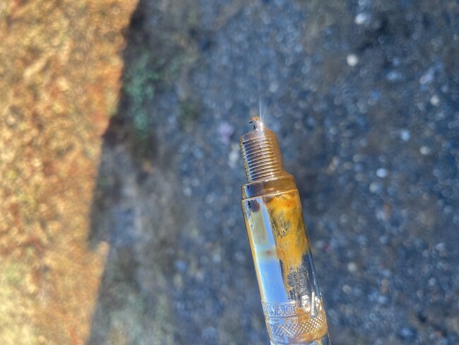

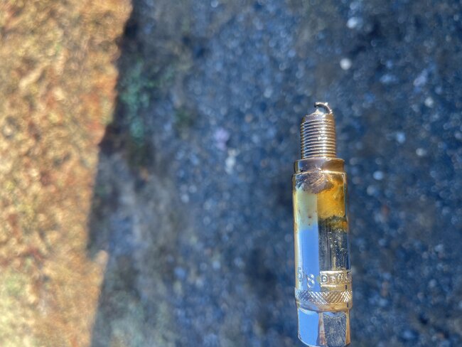

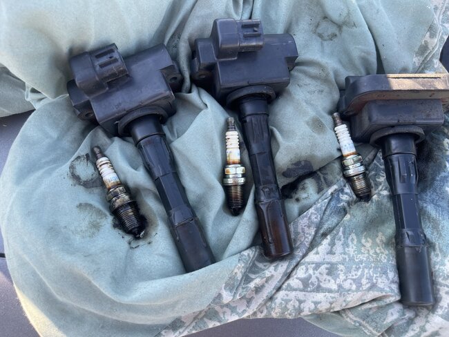

I did the compression test and found out quickly that oil is on almost all the spark plugs. Then there’s one cylinder which I believe coolant is getting into. Because the ignition coil smells like coolant, and it’s the only coil that’s brownish.
I did some research on head gasket leaks and was thinking about trying blue devil gasket repair. I see a lot of mixed reviews but it’s a 30-year-old car, so I figured I’m not losing much if it clogs up something. But if that works that would only solve my coolant leaking issue I believe? I’d still need to figure out why oil is getting into the spark plugs. So, I was hoping someone could point me in the right direction.

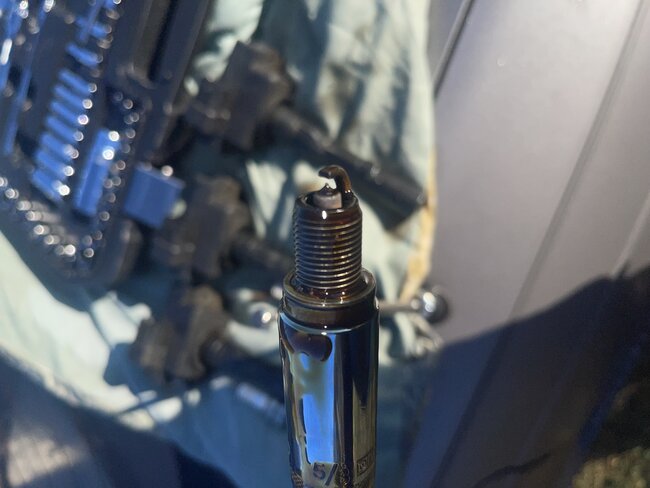

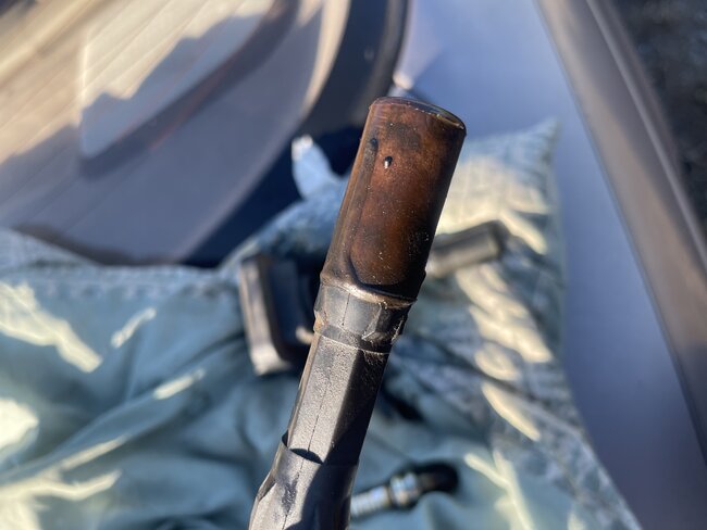

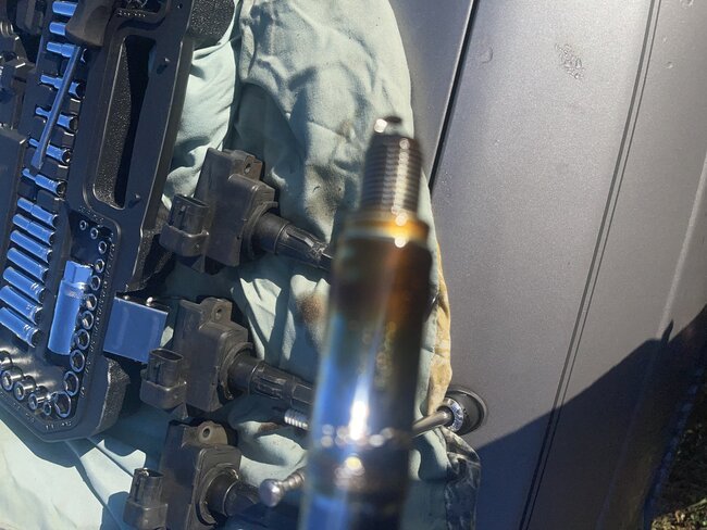

Any help is appreciated, I don’t have much experience with working on cars. I’ll include pictures of my compression test; spark plugs and ignition coils.

First pictures.

Compression test readings.

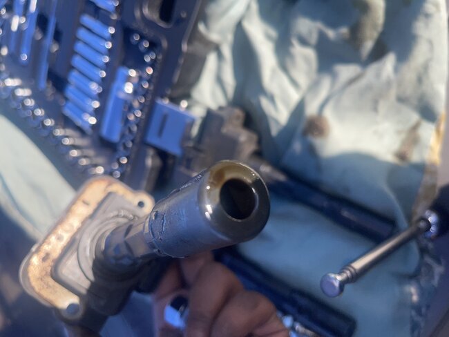

Additional pictures.

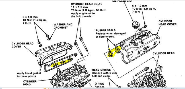

Now, the oil on the spark plugs. Is the oil on the rubber spark plug boot off the coil pack? If that is the case, and it does appear that way in the pics, replace the valve cover gaskets. There is a separate O-ring for each spark plug opening. Chances are they have failed.
Take a look at the pic below.
Also, the idea that the threads on the spark plugs have oil on them is likely because when you removed them, the spark plug tower likely had oil in them. As you removed them, the threads got covered.
Let me know if this helps if you have other questions.
See pic below.
