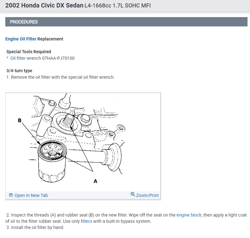

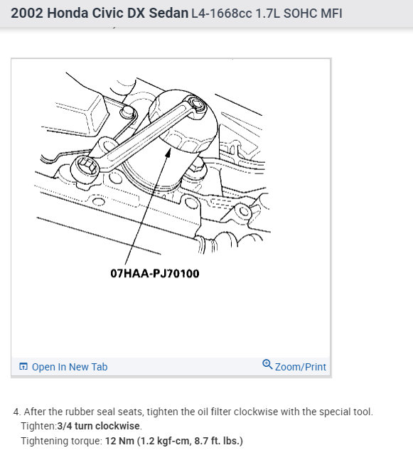

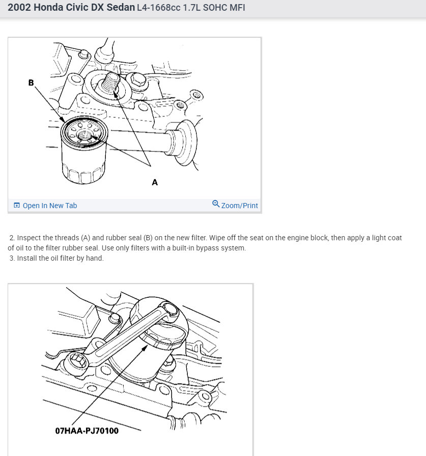

The oil filter cap/wrench is 65MM for your vehicle.
The OEM part number is 07HAA-PJ70100.
The oil filter is located on the bottom of the engine.

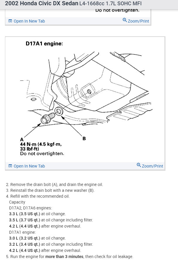

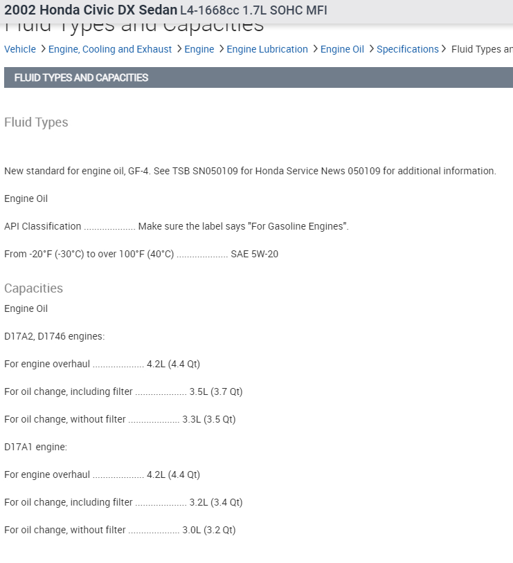

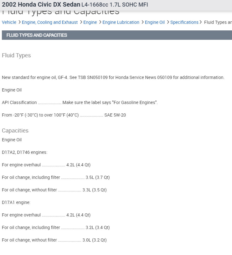

The recommended oil is 5W-20. You will need 3.7 quarts of oil.
Here is a helpful guide:
https://www.2carpros.com/articles/how-to-change-engine-oil-and-filter

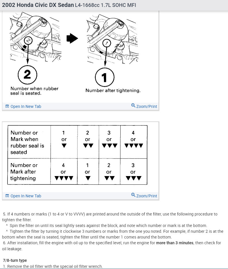

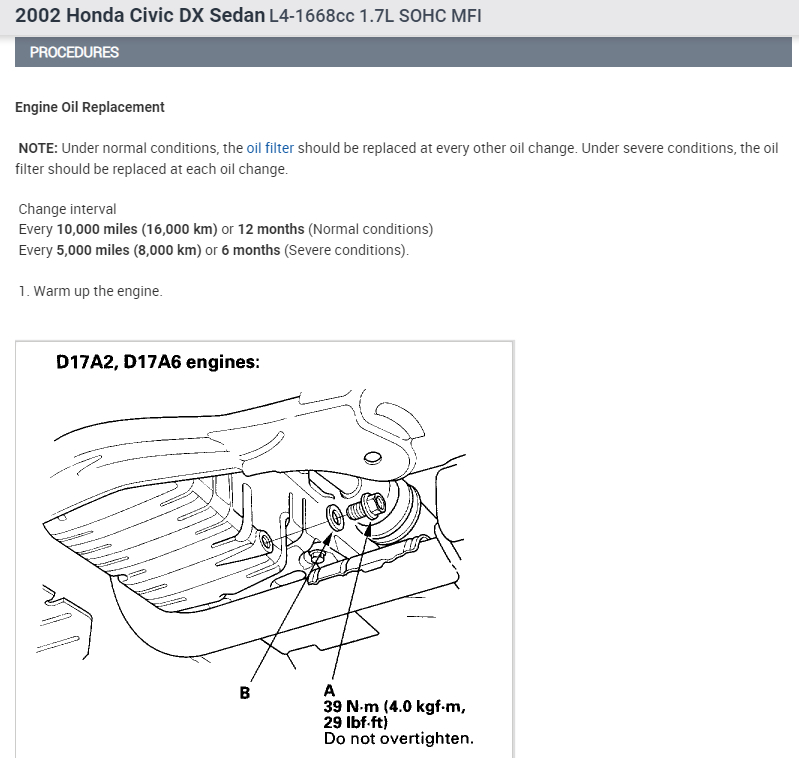

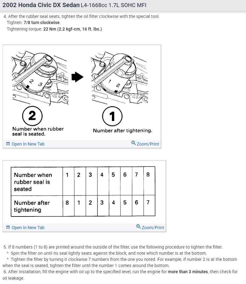

I have attached the filter location as well as drain plug location and the procedure below for your reference.
Let me know of any questions.
